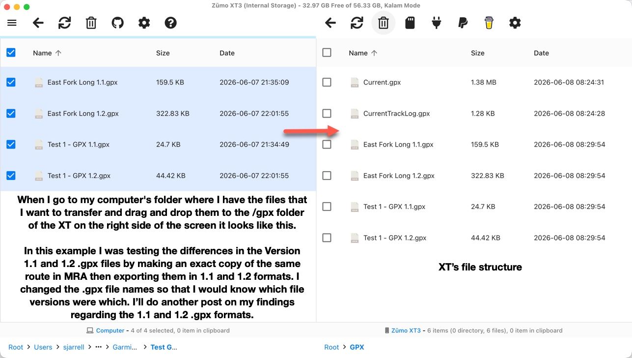

    There is an app called OpenMTP that can be downloaded here. If you want to make a donation to the developer (which I did) that's totally up to you, however it's not mandatory and there are no nag screens or limited features if you decide not to.
    The interface is "simply elegant" with your computer's folders on the left side, and your XT's folders on the right, and you drag files back and forth in either directly. It looks like this:
    The transfer is instantaneous, and you KNOW that it has successfully completed because you can physically see that the files have been transferred! When you're finished with the transfer you simply close the OpenMTP app, unplug your XT and it will turn off, then turn it back on and you'll be prompted to import the .gpx files that you just put into the /gpx folder.
    This methodology works flawlessly 100% of the time.

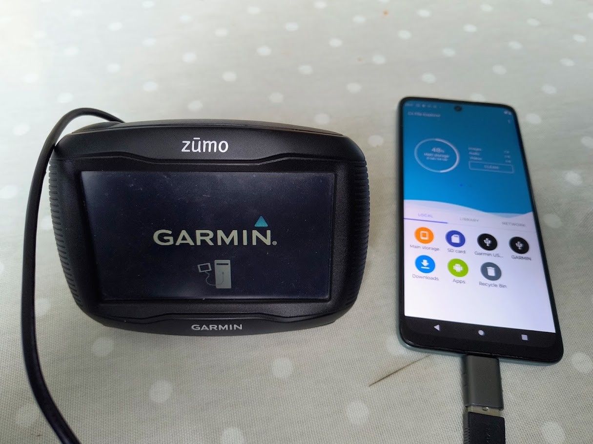

                          There are many differences between the XT,XT2 and XT3. For the XT the Garmin Drive app works flawlessly for transferring routes wirelessly from your phone to the XT. It also works as a hub to connect your phone to weather information, traffic information and "Smart Notifications". But for the love of all that is holy do not connect it or the XT unit to Garmin Explore and sync your routes and tracks as you are in for a world of pain. I've done it a few times to see if its improved.....it hasn't. The XT is also capable of transferring routes via bluetooth to another XT device, a BMW NAV5 and 6 all of the 3XX Zumo's and the Zumo 590 and 595. This was/is handy if transferring routes others basically using any Garmin Zumo that has bluetooth sharing capability. I believe this is more complicated now and files cannot be shared directly from the XT2 or 3 to older Zumo's.
                          That said if you use MRA for route planning you can share files with old zumo devices using this arrangement (at least in Android I don't know about IOs)
                          Older Zumo's and any sd card contained therein are seen as a mass storage devices by Android phones you can cable connect the phone to the Zumo (make sure you use a Garmin lead!) and GPX files you download from MRA can be installed directly into the device or SD card.
