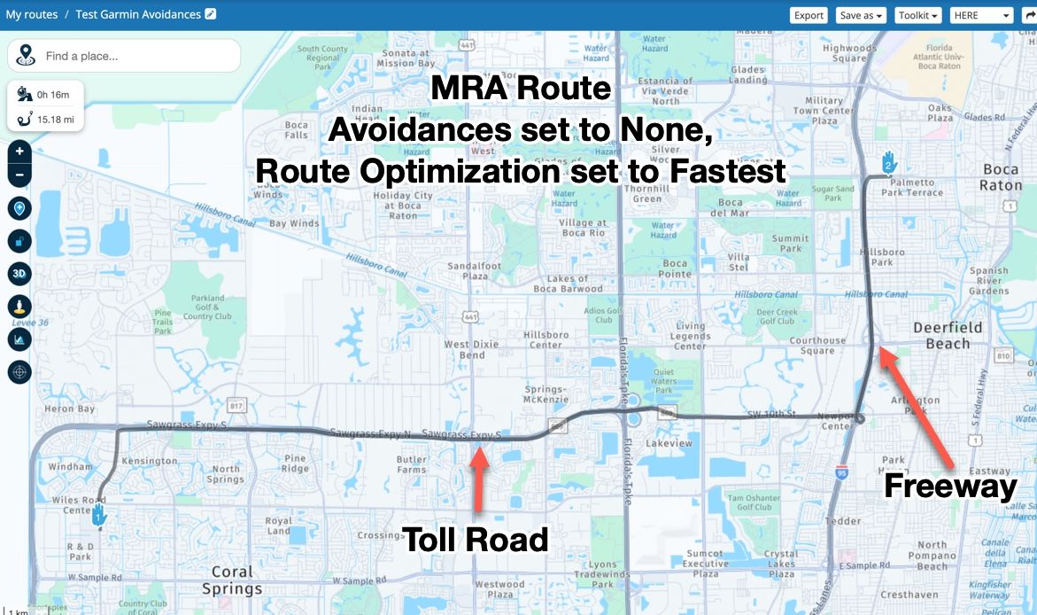

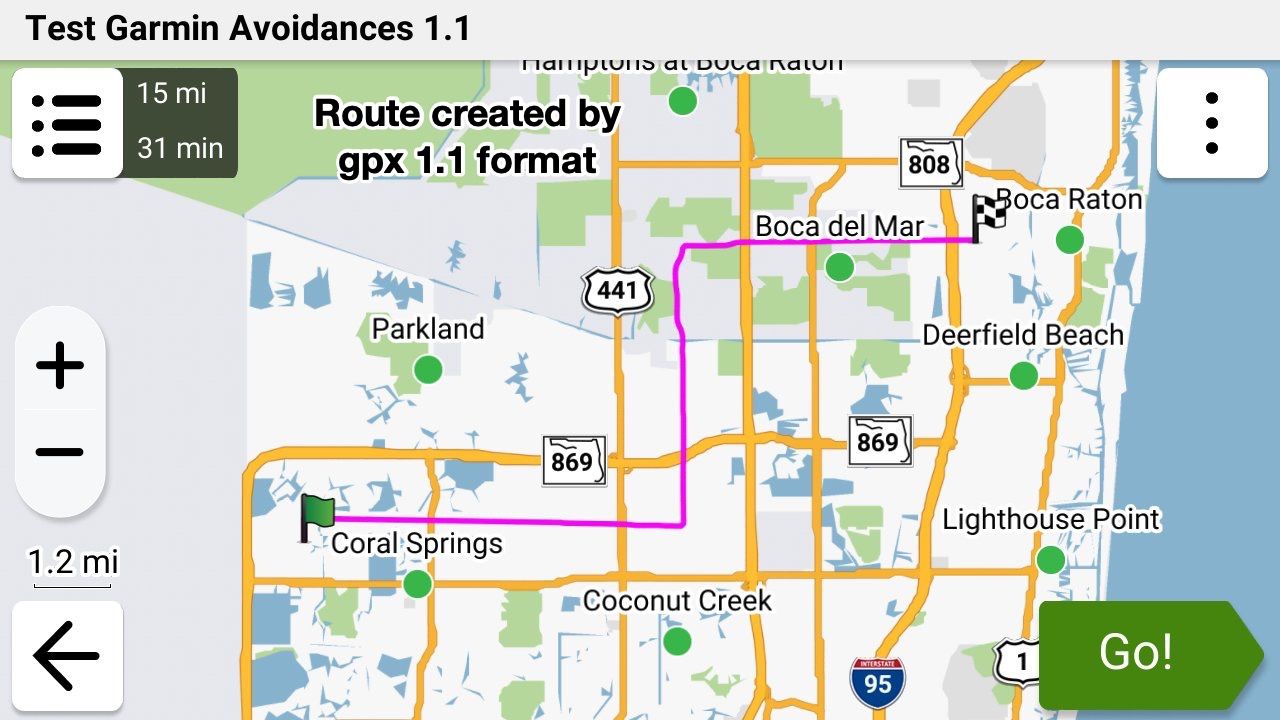

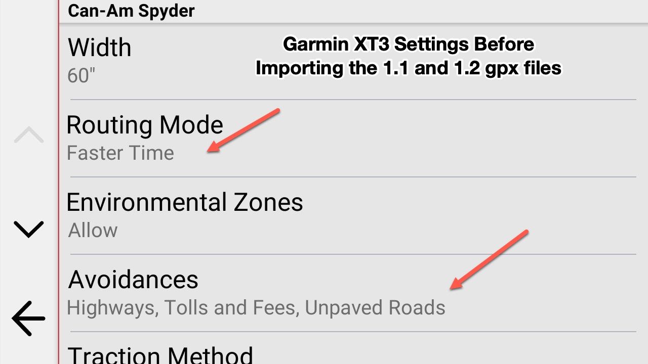

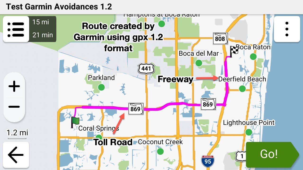

                    @Marinus-van-Deudekom I completely agree that Garmin's avoidances certainly mess up a gpx 1.1 route in sometimes VERY unpredictable ways.
                    However, Garmin's avoidance settings do not in any way alter a gpx 1.2 route as the Garmin is forced to follow the gps coordinates in the route section of the file and not the shaping points or, in the case of this example, just the beginning and ending waypoints. That is the BIG difference between the gpx 1.1 and 1.2 formats.
                    The following example route and screenshots show this clearly. Here's a very simple 2 waypoint (Start and Finish) route in MRA that I created this morning to show this visually. In this example route my MRA's Route Optimisation is set to "Fastest" and my Garmin's is set to "Fastest" and its Avoids are set to "Freeways" and "Toll Roads".
                    The EXACT same route was saved as gpx 1.1 and then 1.2 formats and then both formats were imported into my Garmin XT3. You can see that the Garmin totally ignored the planned route when importing using the gpx 1.1 format file and followed its Avoid settings, however it followed the planned route exactly when importing the route using gpx 1.2 format file and totally ignored its Avoid settings.
