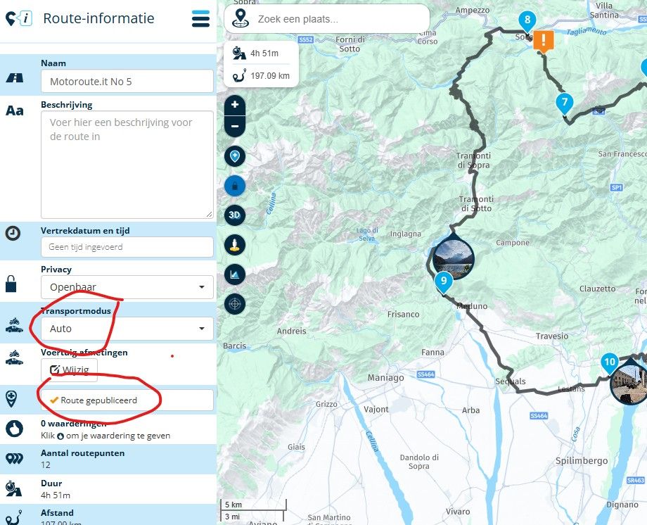

                            @bull-tahr To get your routes visible in your route libary you must use the Car profile and not the motor profile, this is a bug in the program that hopefully will be solved in the upcomming version.
                            routes are looking good, one comments and this is what I prefer.
                            On the below you have the stop as a Via point, I personal do not use via points for that, as it is a choice to stop. with a via point you must always hit the point otherwise the program will always lead you back to that point. To hit the point on a busy carpark will be a challange.
                            To see the routes of a friend you must be friends and the routes must be set to at least friends to see them in your friends library.
                            The car or bike profile is of no interest.
                            However if you use the bike profile bare in mind that those routes, once exported by the recipiΓ«nt to their nav can't be used since Garmin does not allow the bike profile. Therefore the carefully composed route will be recalculated by the Garmin and thus messed up.
                            My advise use the car profile like all the RouteXperts do

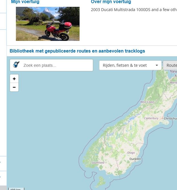

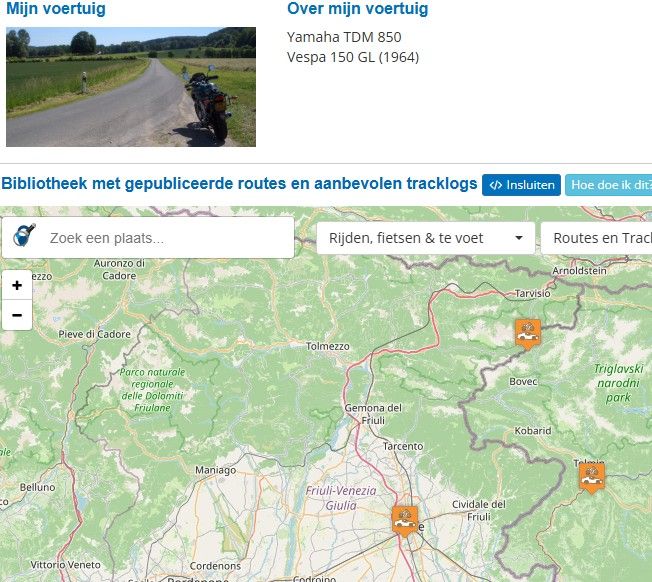

                                @bull-tahr :
                                if you want to get the routes visible in your libary you have to set them to "Public", use the Car profile AND you have to publish you route.
                                your libary is still not visable so I presume you have not published your routes.
                                I can see you still have some routes with the motor profile
                                if the above criteria are met , you should see the routes in your profile:
                                To prove the remark about the bug, when the routes are visible in your libary, switch one back to the "motor" modus and you will see it will not pop-up anymore in your libary.
                                Bull Tahr 1 Reply Last reply

                                  @BertM Thanks for all that. The South Island folder is now all published, car mode and public to view. In library tab I only see 30 routes in New Zealand all RouteXpert, none of mine. Maybe it's Route Expert only or I am on the basic account ATM.... Either way, you should be able to see the South Island folder and routes now.
                                  Thanks for all the help!
