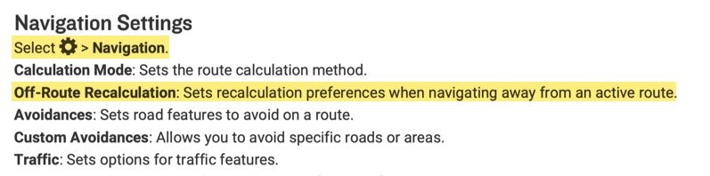

                  @Carl-Lee
                  Hi, I have an XT2 and cannot figure out how to turn off auto-recalculate off? Can you let me know how to turn off auto-recalculate, please?

                    Have you read the manual page 47?
                    https://www8.garmin.com/manuals/webhelp/GUID-7E13E879-D2C7-4B0C-9E63-CD693B2E7042/EN-US/zumo_XT2_OM_EN-US.pdf
                      As @reinhard-32 said, this is from page 47 of the XT2 manual. My XT3 is a lttle different, but this is from the .pdf manual downloaded from Garmin's site.

                        Thank you Steve. I did eventually figure this out. I thought there was a different setting used during import of files.

                          @OkayJim You're very welcome. I'm glad that you figured it out!
