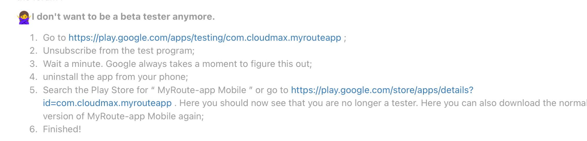

                            This soûl do the trick
                            Tore Teigeneundefined 1 Reply Last reply

                              @Marinus-van-Deudekom
                              Thanks Marinus. I'll give it some more tries before i do the uninstall option.
