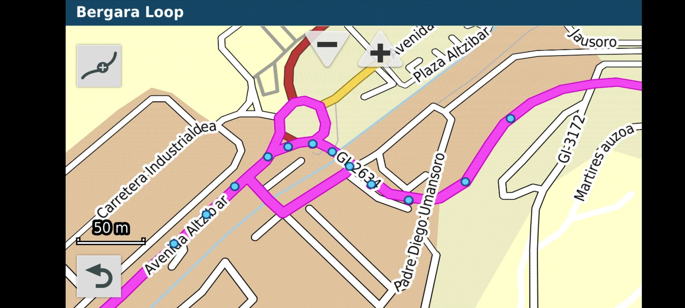

    HI Guys, new member here. I use the Garmin Motorize app on my phone and I have created several routes which have transferred OK from the My Route app. However, when I load one particular route the Garmin app alters the route and puts totally random deviations in such as doing 360 degree circles around roundabouts or going off the main road into random side streets and re-joining the main road. I have tried everything to fix it without success. This route is a super run in the Pyrenees which I hope to be on in 4 weeks, But this problem is driving me nuts, Same thing happened on another route and I fixed it by adding more waypoints at the problem sections. That didn't work with this route, I'm really frustrated with it. so I wonder if any of you experienced folks have a suggestion or two?

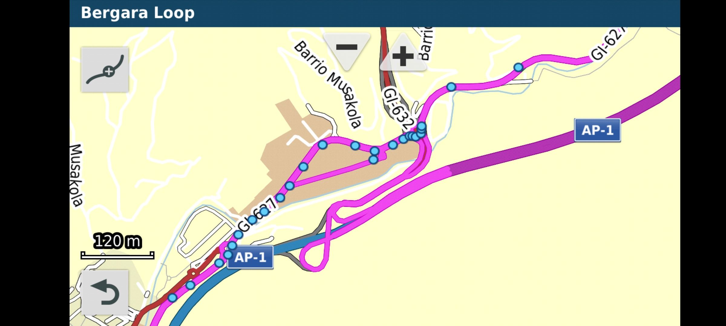

          @Rob-Verhoeff Screenshot_20240817_172157_Motorize.jpg Screenshot_20240817_172124_Motorize.jpg
          This is what I'm getting on the Motorize app - on MyRoute the black line follows where you can see the blur waypoint markers, these additional loops and deviations only appear after I upload the GPX file.
