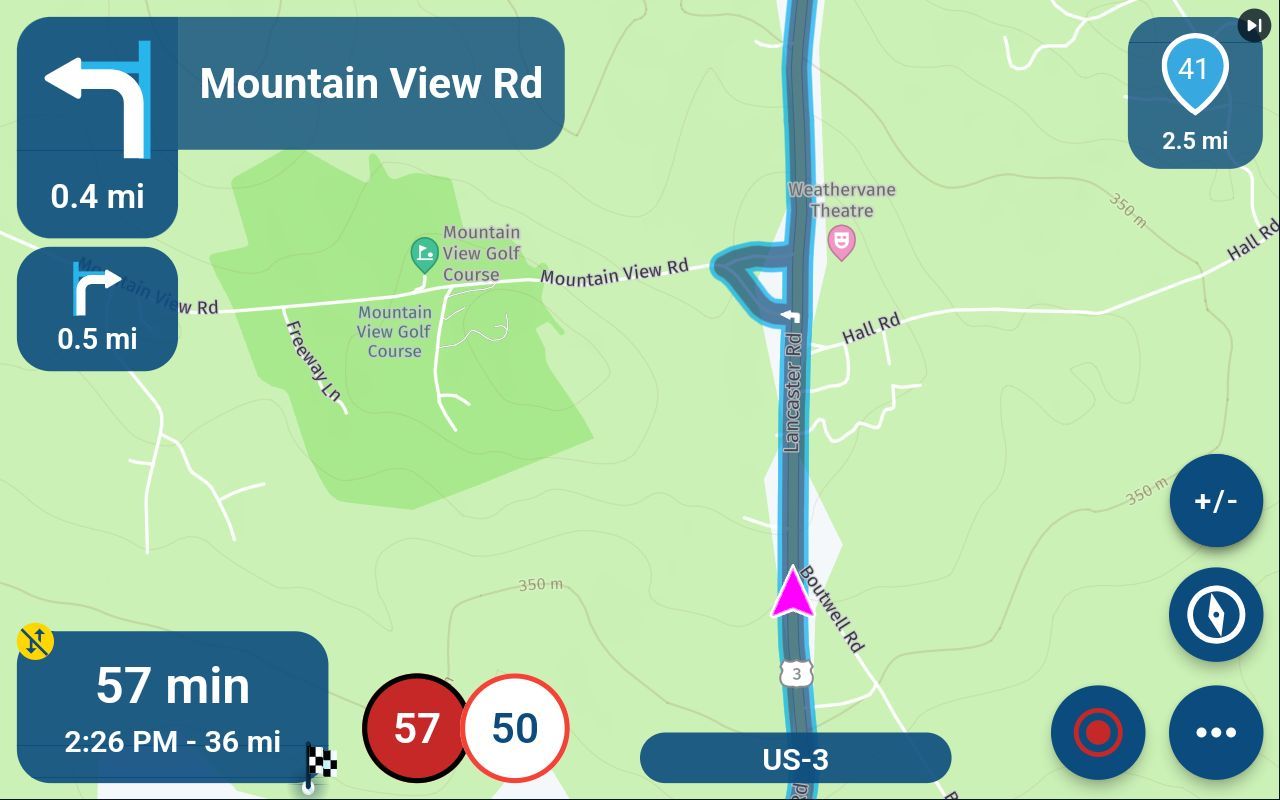

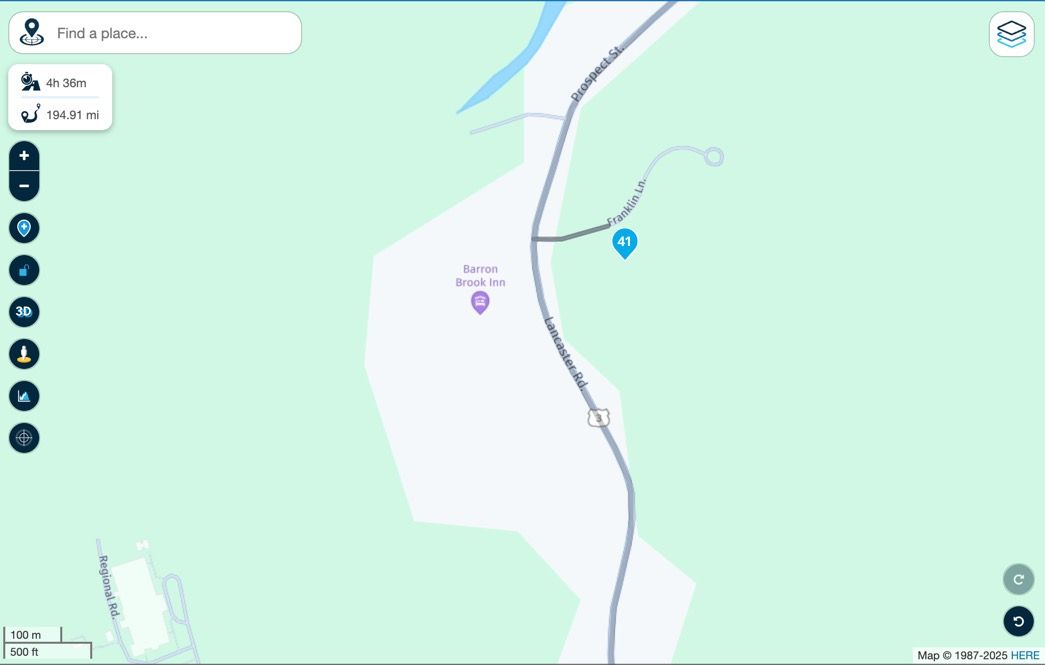

    I posted a few days ago about a problem with the MRA Android app using the offline maps not skipping shaping points automatically, but then for the next few days it worked perfectly and I thought perhaps I was mistaken and it was something that I did wrong.
    I set one of my DMD T865X user definable buttons to take a screenshot just in case that it happened again, and today I had the same issue again, and this time it's very, very clear.
    Here's a link to my route.
    As you can see shaping point #41 is off of my intended route (I RARELY miss these "spurs" but I was in a hurry...). As I approached this shaping point while riding today it was obvious that this was a mistake so I bypassed it. This shaping point was only about 100 meters or less off of my route so it definitely wasn't so far away that MRA couldn't skip it automatically.
    MRA immediately started trying to get me to make a U-turn to return to shaping point #41 and I had to manually skip #41 to continue. See the screenshots below and / or click on the link to my original route to verify my findings.
    I am running MRA Android version 4.3.8-386 and I'm using the offline HERE maps.
    Thanks,
    Steve

      What exactly is your question? MRA tries to direct you back to point #41 immediately after you’ve passed it. In my opinion, that’s the correct decision by the app, because it always tries to guide you back at first. That’s simply how the algorithm is designed. Only after a certain number of attempts does MRA automatically skip the point. In my view, it’s correct that this doesn’t happen right away.
      Because you noticed your mistake almost immediately while riding, you could of course have manually skipped the point on your screen right away.

            @Rob-Verhoeff MRA is not supposed to route you back to shaping points if you have "Skip waypoints automatically" turned on, which I do. It will always route you back to via point regardless of the settings, but shaping points should be skipped.
            And yes, of course I could have manually skipped the shaping point if I noticed it immediately. That's not the point!
            What if it wasn't so obvious and I didn't notice it immediately, and what if the next turnaround was miles up the road and I assumed that MRA was working as it's supposed to. It can really cause serious routing issues, especially in congested areas.

                                  How can I tell quickly if I'm being rerouted back to a previous shaping point? If the next turnaround point is several miles / kilometers away and possibly makes several turns it can be very difficult to tell if you're being rerouted back to a prior point.
                                  I'll repost my screenshot from my first post here, and as you can see it's obvious here that I'm being rerouted backwards, but if the turn around wasn't this obvious that only indication that I'm being rerouted to a prior shaping point is the number of the shaping point itself (41) which frankly means nothing to me as I use a lot of shaping points.
                                  Thanks!

                                    Steve I see that point 41 is not on the route line but along it. I also see that there is a kind of roundabout at that point, a view point or something like that? Always place the points on the route line. What works for me is if I want to go to that view point, for example, place a via point just before the exit and indicate in the via point that I have to turn right if I want to go to the view point. If I decide to continue driving for whatever reason, then I have at least touched the point and it does not have to be skipped. The app will indeed try to bring you back to the missed point 3 times. You can also press the point once and confirm that you want to skip it.
                                      Let me put an end to this as I'm the only one that can 😉
                                      Viapoints will never be skipped automatically. Simply as that, end of discussion.
                                      Shapingpoints however can be skipped automatically. They are however still part of your route and not that unimportant that they can be skipped immediately. Not everyone is religiously marking every crucial waypoint a viapoint. We have to make the majority happy, which we did.
                                      Skipping waypoints is so bloody easy that a situation where you are redirected once or twice back to a missed shapingpoint is fine. You can always skip yourself and if you keep ignoring it, the waypoint will be skipped eventually.
                                      So, what is the logic?
                                      • Are recalculations enabled? Yes, continue. No, user needs to navigate back to route himself
                                      • Are we moving? Yes, continue. No, route back to the missed waypoint. This is to prevent skipping waypoints automatically while refuelling, having lunch.
                                      • Is skipping waypoints enabled? Yes, continue. No, route back to missed waypoint (even if shaping and hence it will never be sipped)
                                      • Is it a via? Yes, return the viapoint. No, continue
                                      • Are you more than 30 km away from the shaping? Yes, return back to shaping. No, continue. This is to prevent skipping shapingpoints too far on your route.
                                      • Are you within 100 meters of the shaping point? Yes, go to next waypoint immediately. No, continue.
                                      • Is it your first deviation? Yes, return back to missed waypoint. No, continue. This results in always having a route back to your missed waypoint. You need at least 2 recalculations
                                      If you get here, we will determine the nearest logical marker on your route. In short, we calculate routes till the next 10 markers and select the marker to which the distance is shortest as the waypoint to skip to. In this process viapoints will still never be skipped.
                                      When the determined nearest marker is not your current missed waypoint you will be sent to that marker. If the nearest marker is still the one you missed, you will be sent back to that one. So the shape of your route and waypoint placing is quite important 😉
                                      If all else fails the amount of recalculations are still counted. When you have 4 (or more) recalculations the missed waypoint will always be skipped for the next.
                                      So that's it.
                                      It works quite well for the majority but obviously there are scenario's where you can fool it. Changing it is not hard for me but we had it way more aggressive and then people complained too many shaping points were missed even when it made sense for the algorithm.
                                      People make routes will all different kind of waypoints and placement / density of them. Everyone needs to be satisfied. We already have a lot of configuration options, I don't yet feel something to allow users to influence the parameters of this logic.
                                      As people indicate here, the algorithm does it's work to send you around roadworks and stuff like that but yes, you will always need a second recalculation and then the road layout around you and your own waypoint placement will still influence the route 😉
