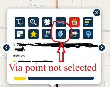

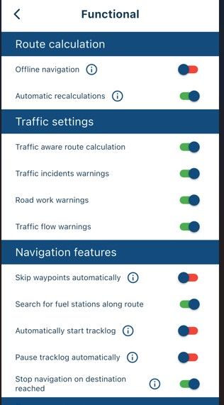

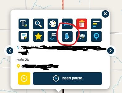

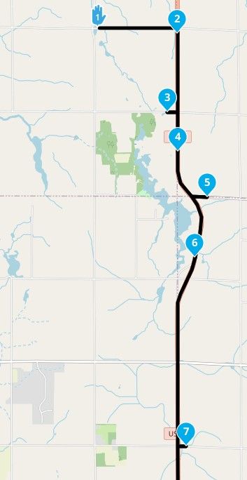

      @MotoCon
      Here is a picture of my route. I purposefully put via points 3,5, and 7 on the route just to test being re-routed to them after passing them. Does the fact that they are somewhat close to the 'main route' contribute to them getting skipped ?
      And here is and example showing 3 is a via point
      Is it possible that the points are not being stored as Via points ? I'm using the free Basic MRA web site account to create routes. Is there something I could be looking for by creating a GPX file of the route and view the XML tags ?
      Here are the settings I've got in the MRA app:
      There must be something I'm doing or wouldn't a LOT of people be reporting this ?
      Should I create a ticket for support ?
      Thanks everyone

        @David-38 Jus to be clear, 3 is not a via point as can be clearly seen on your screenshot of the map. The route point menu screenshot that you shared shows how to select a via point, if the via point is selected the icon would show a shaping point.

          That 3,5 and 7 are being skipped automatically is exactly how it is supposed to be

            @Nick-Carthew-RouteXpert-Senior
            Ahh, seeing the 'hand' gave me the impression it was already a via point .............. I'll update my route accordingly and re-test.

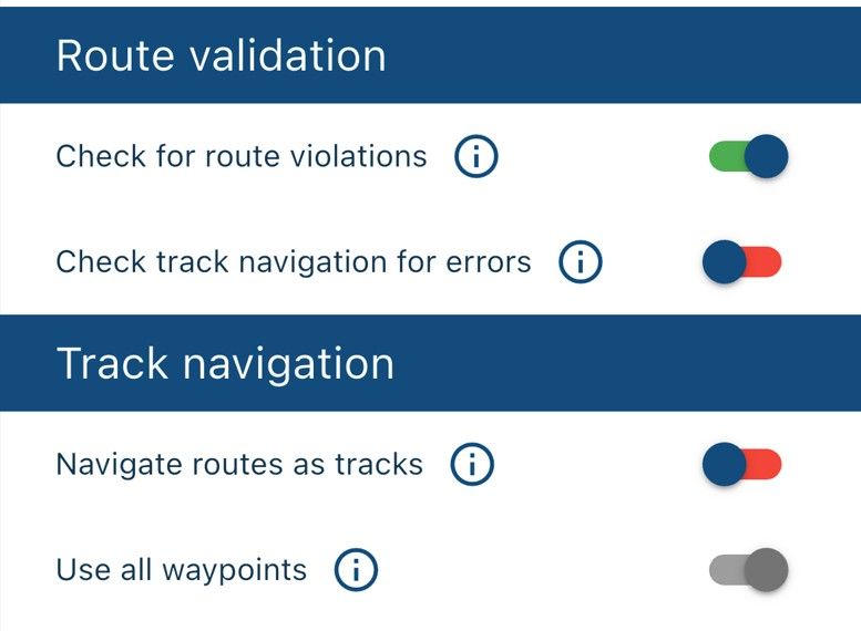

                  I converted the Shaping Points to Via Points (see pic)
                  But as I drove past the turns to each of them, I did NOT get directed back to them.
                  But notice the message about using track navigation ......... is that ( track navigation) essentially preventing me from getting directed back to the Via Points ?
                  How do I stop track navigation / navigate as a route ? (As shown in an earlier post, I have the 'navigate routes as tracks' setting turned OFF)

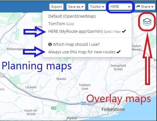

                    @David-38 You are planning your route using the planning map from OpenStreetMap (OSM). Use the planning map from HERE as this is the map that the app uses.

                          No, if you look next to the word Gold it also says Nav. An MRA Navigation Next subscription gives you access to the planning map from HERE, check it for yourself.

                            Thanks for that information ! I selected the HERE map on the web site, synced the route, and ran a test of the app.
                            Looks like I'm being directed to my Via points as I want !
                            Thanks everyone for your help and patience with an app newbie.
                            Now, another question ........ I've changed the map selection setting so that NEW routes use the HERE map, but is there a way to convert all my EXISTING maps ? Or do I need to open each route (approx 300 routes) and make the map selection update ?
