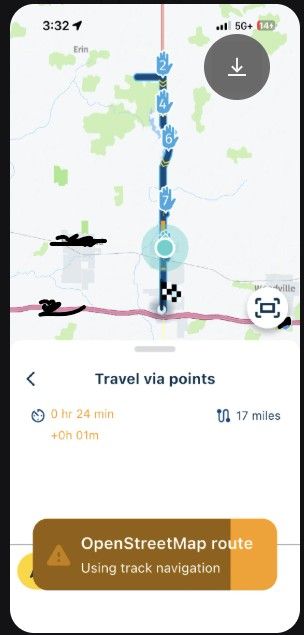

                      I converted the Shaping Points to Via Points (see pic)
                      But as I drove past the turns to each of them, I did NOT get directed back to them.
                      But notice the message about using track navigation ......... is that ( track navigation) essentially preventing me from getting directed back to the Via Points ?
                      How do I stop track navigation / navigate as a route ? (As shown in an earlier post, I have the 'navigate routes as tracks' setting turned OFF)
