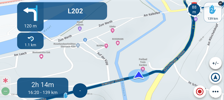

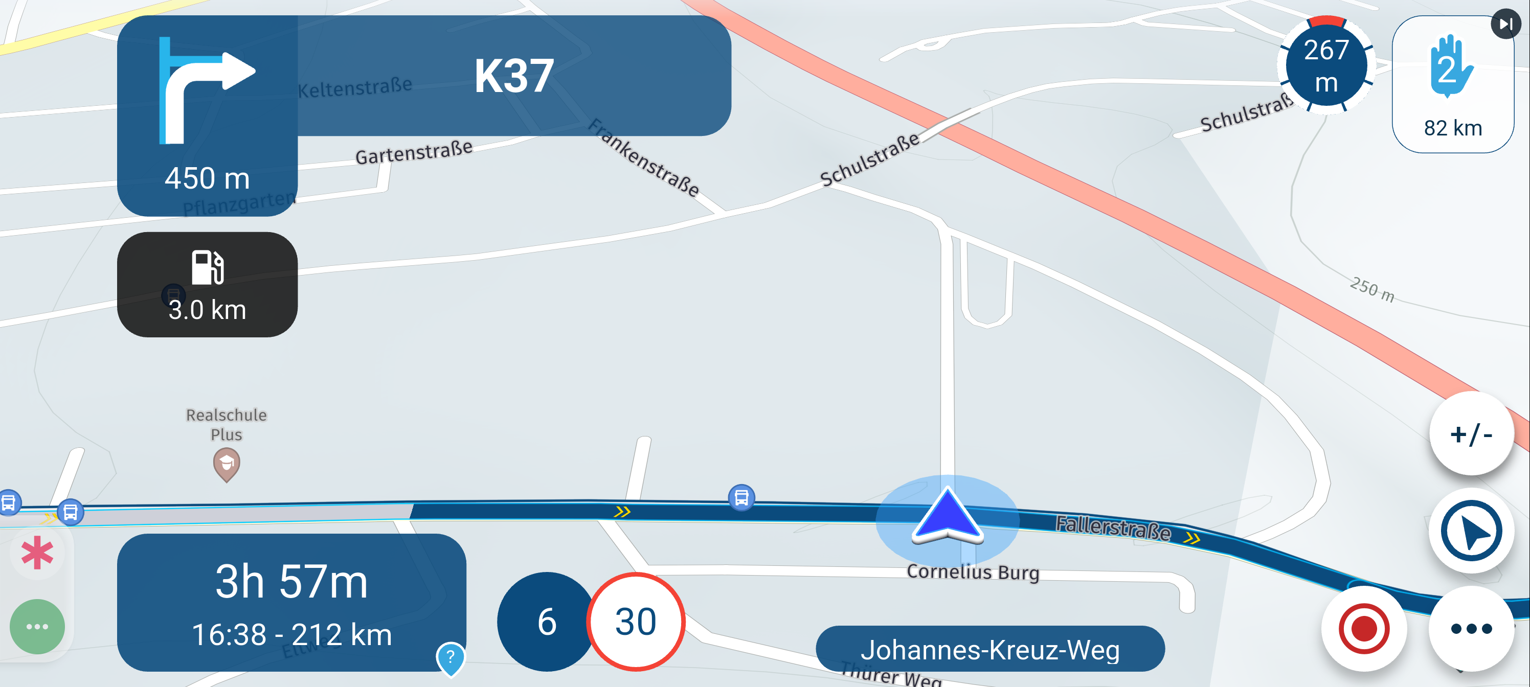

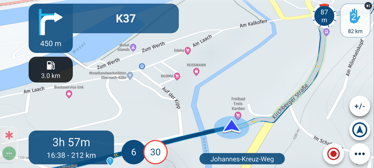

    Screenshot_20260823-133150.png Yesterday, I followed a route I had planned on my PC using MyRouteApp. While driving (using the route as a track), I received no new navigation instructions; the display remained stuck on the initial instruction. After 10 minutes, I stopped and restarted the navigation. I then received a new instruction, but that one also remained fixed on the screen. Later, I closed and restarted the entire app, but that didn't help either; it continued to show only the first instruction. Throughout this, the arrow moved normally along the route.
    After about two hours—three kilometers before my first waypoint—the system recovered, and everything returned to normal.![Screenshot_20260823-133150.png](/assets/uploads/files/17876582Screenshot_20260823-140445.png Screenshot_20260823-140659.png Screenshot_20260825-133923.png Screenshot_20260825-133953.png 75194-screenshot_20260823-133150-resized.png)

        @Hans-Udo-Erdmenger it almost sounds as if the system is driving this route in the opposite direction - "after 2 hours - 3km before my first waypoint" !
        & the distance shown to point 2 seems to have increased from 82km to 139km
        normally when I ride a route the distance to the next points comes down

          @superg but the arrow on the track shows every time correctly the point where i was,
          @brian-mcg MRA increased the distance after I closed and restard the app.

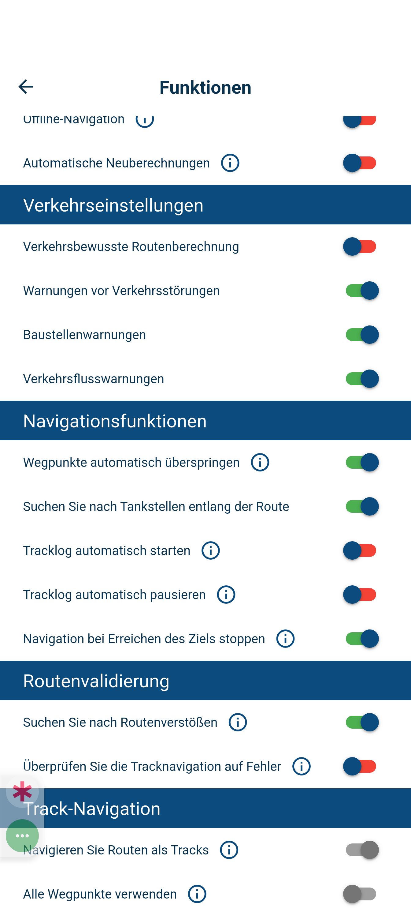

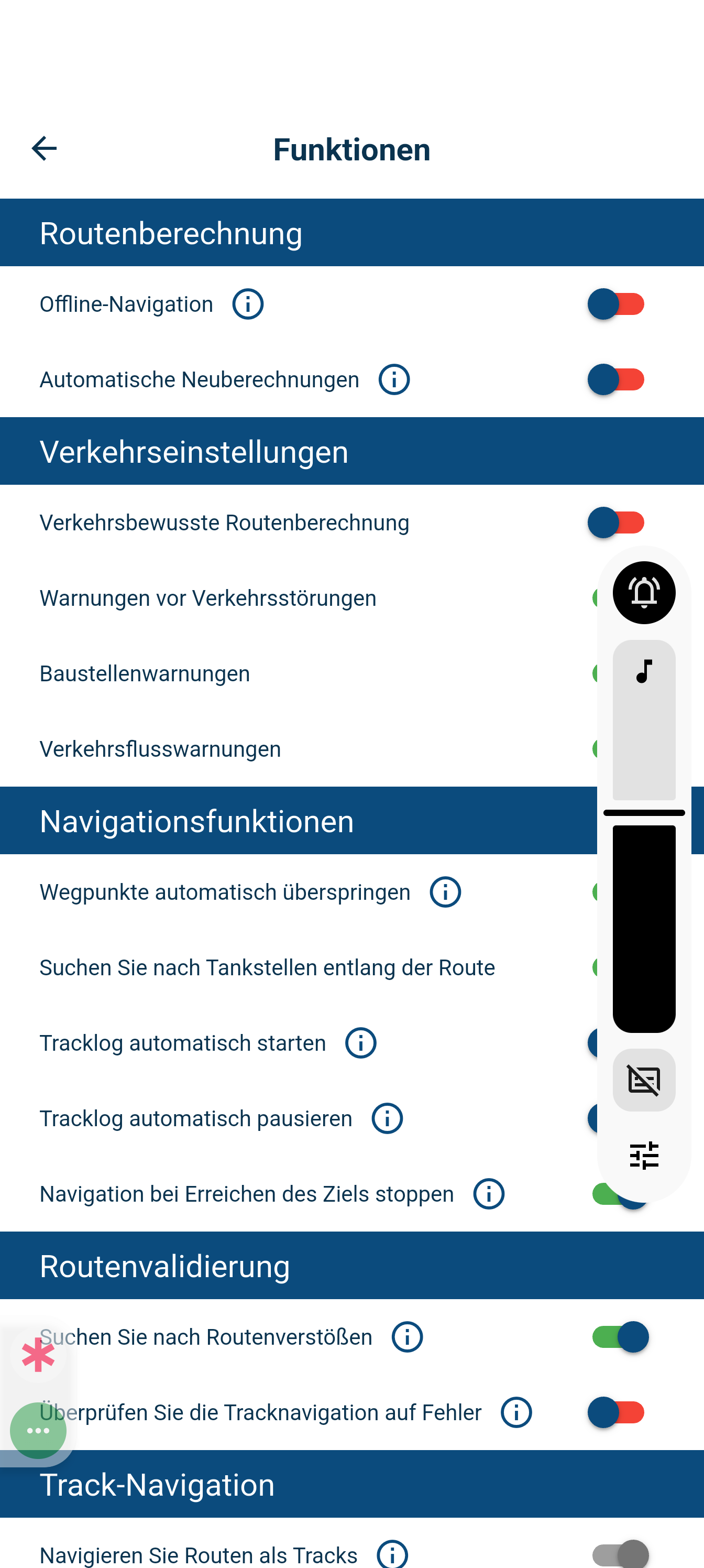

              @travellexxie I switched of automatic recalculation and switched on Automatically skip waypoints
