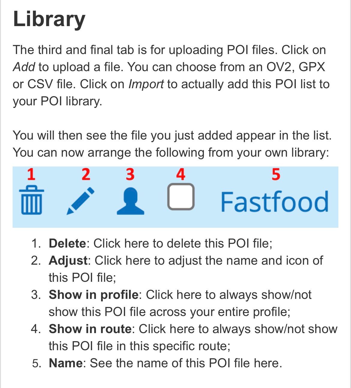

                        See this manual for showing / hiding certain POI groups for your entire profile / route: https://support.myrouteapp.com/en/support/solutions/articles/12000103938-manual-pois-
                          I am confused. This is the procedere, how to do it website aka MRA webplanner, which I also did. I meant the Android/iOS navigation app. Or I am missunderstand here?

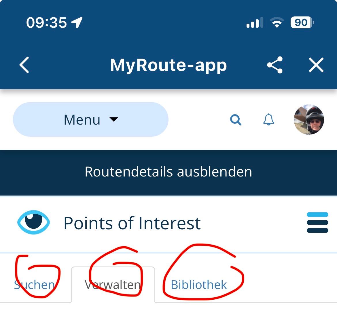

                            Switching on and off is only possible in the route lab, there is no function in the app
                            In the route lab:

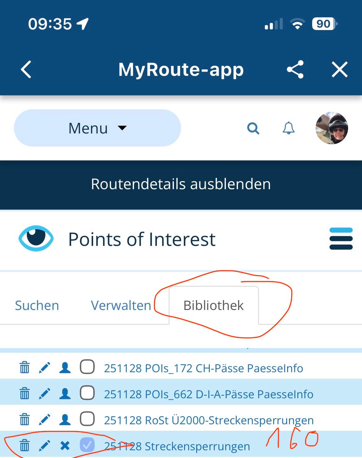

                                Nick Carthewundefined Offline
                                @ConiKost said in Some routes opening slow and some fast:
                                Thanks for confirming. That was my question, that I need to use the web planner and cannot use the app for that, to switch it on or off. So an option in app would be very handy 🙂
                                There is an option in app. Tap Route lab from the mobile app to access the website.
                                ConiKostundefined 1 Reply Last reply
