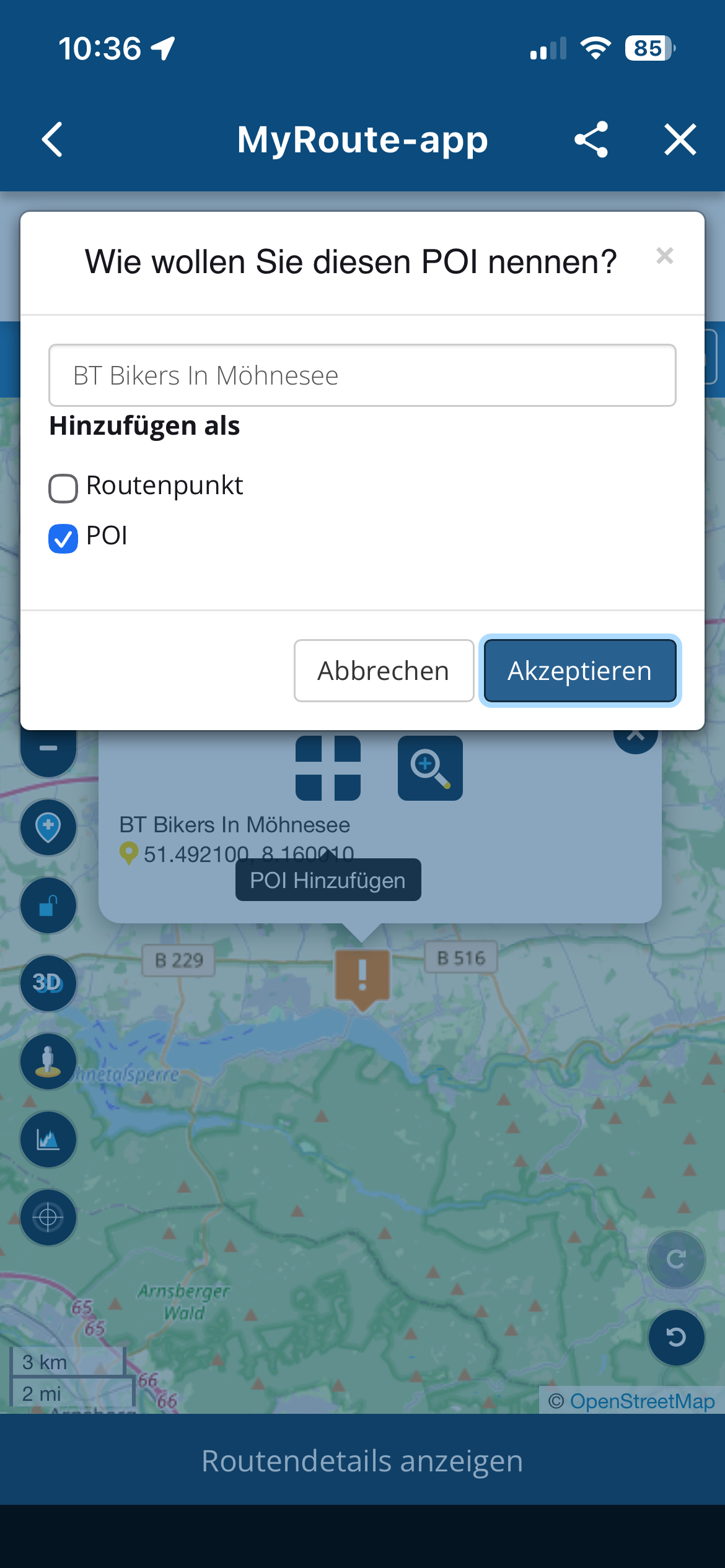

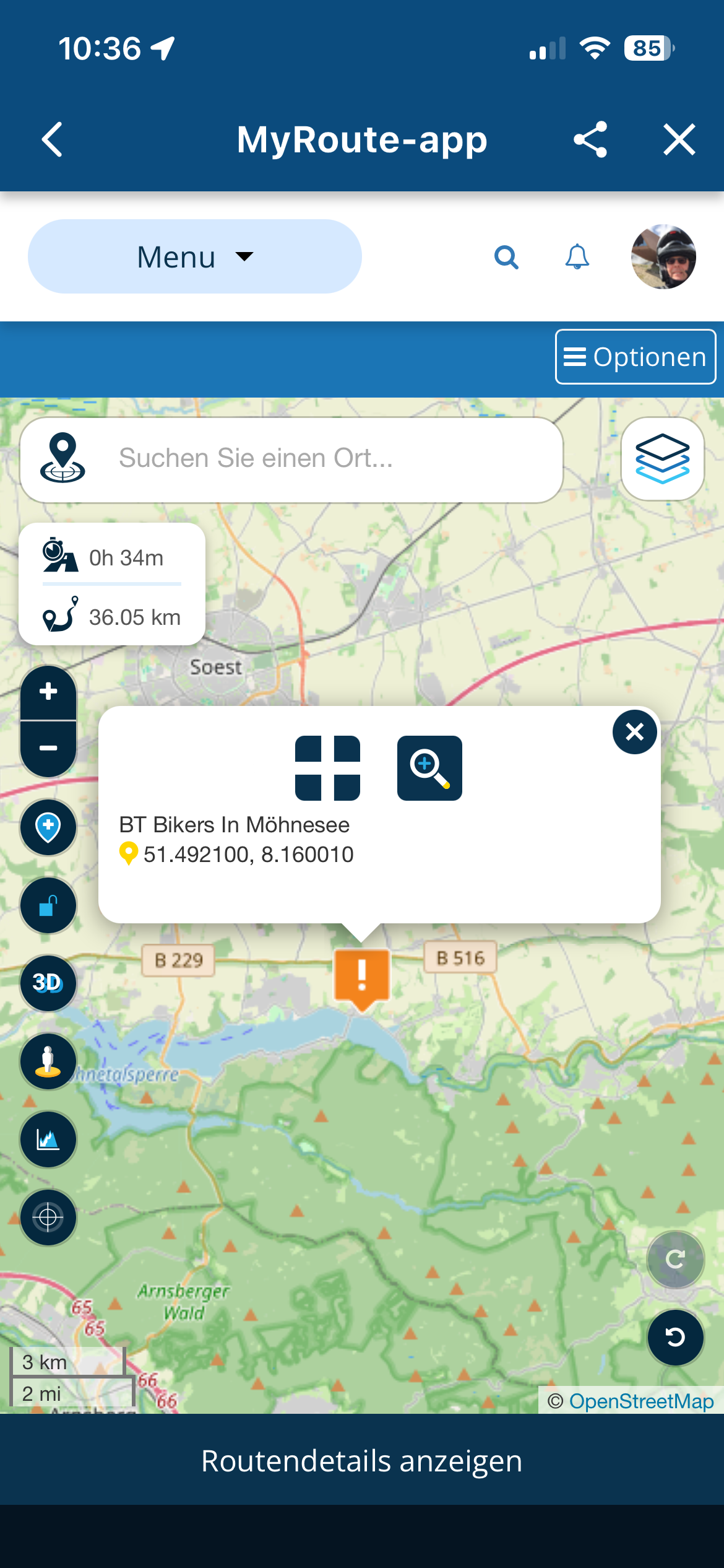

    Since the app received the update with the new POI functionality, I tried yesterday to create a route using some of my stored POIs. However, the problem is that while you can see a lot of POIs on the map, you cannot see their names or click on a specific POI to view its information.
    I think it would be great if the POI name could be displayed below the POI icon, or if you could tap on a POI to view its details. This would make route planning much easier when using the stored POI database (The same should be with saved favorite places).

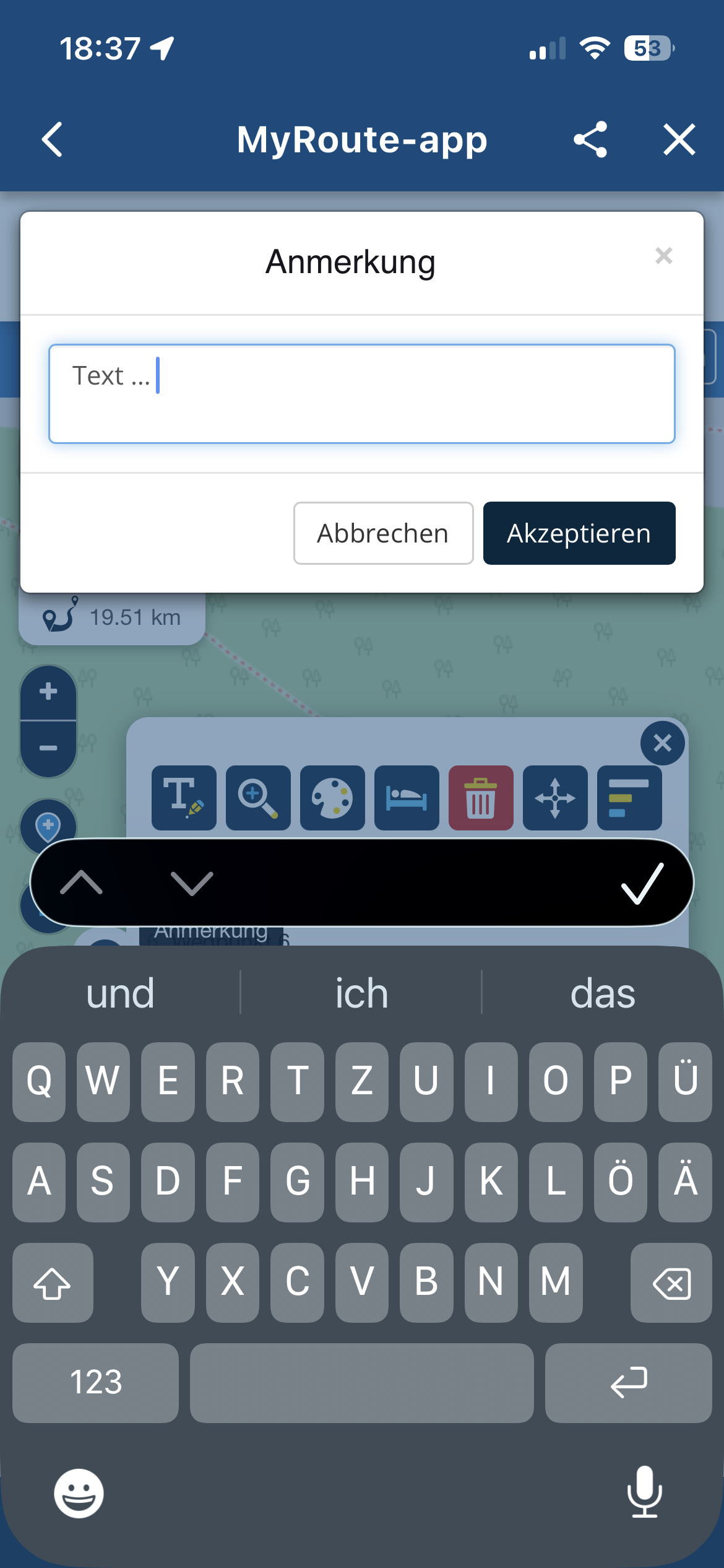

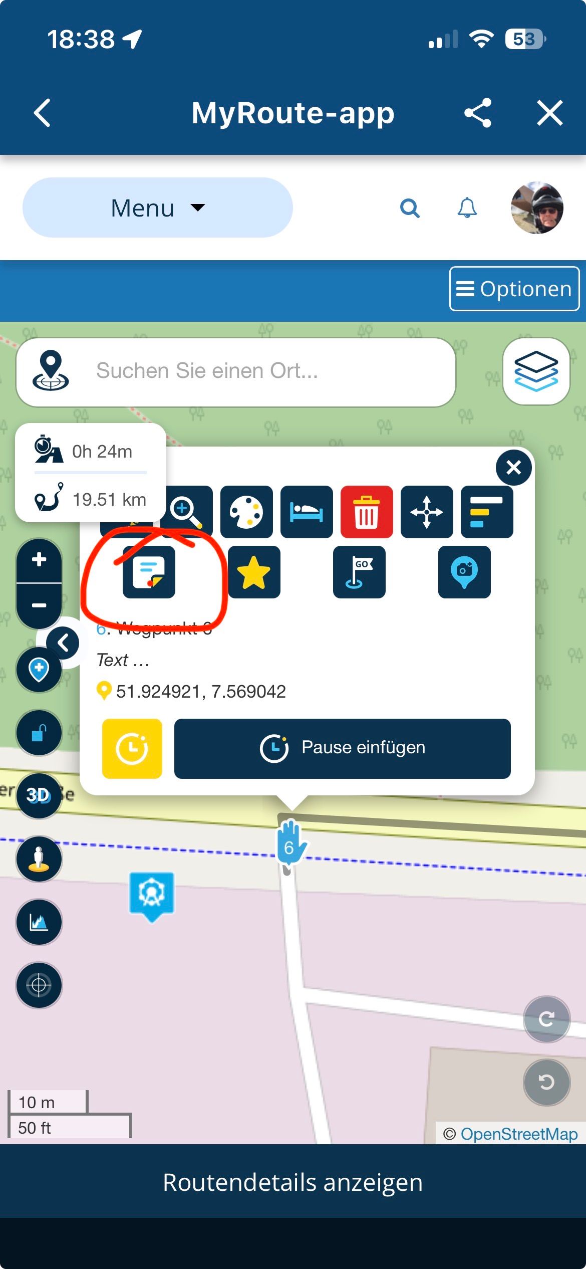

                      Place a WP near the POI and insert the text there in the WP,...
                        In the App Navi settings in the account under navigation settings, set it so that Via points "the hand symbol" is read aloud.

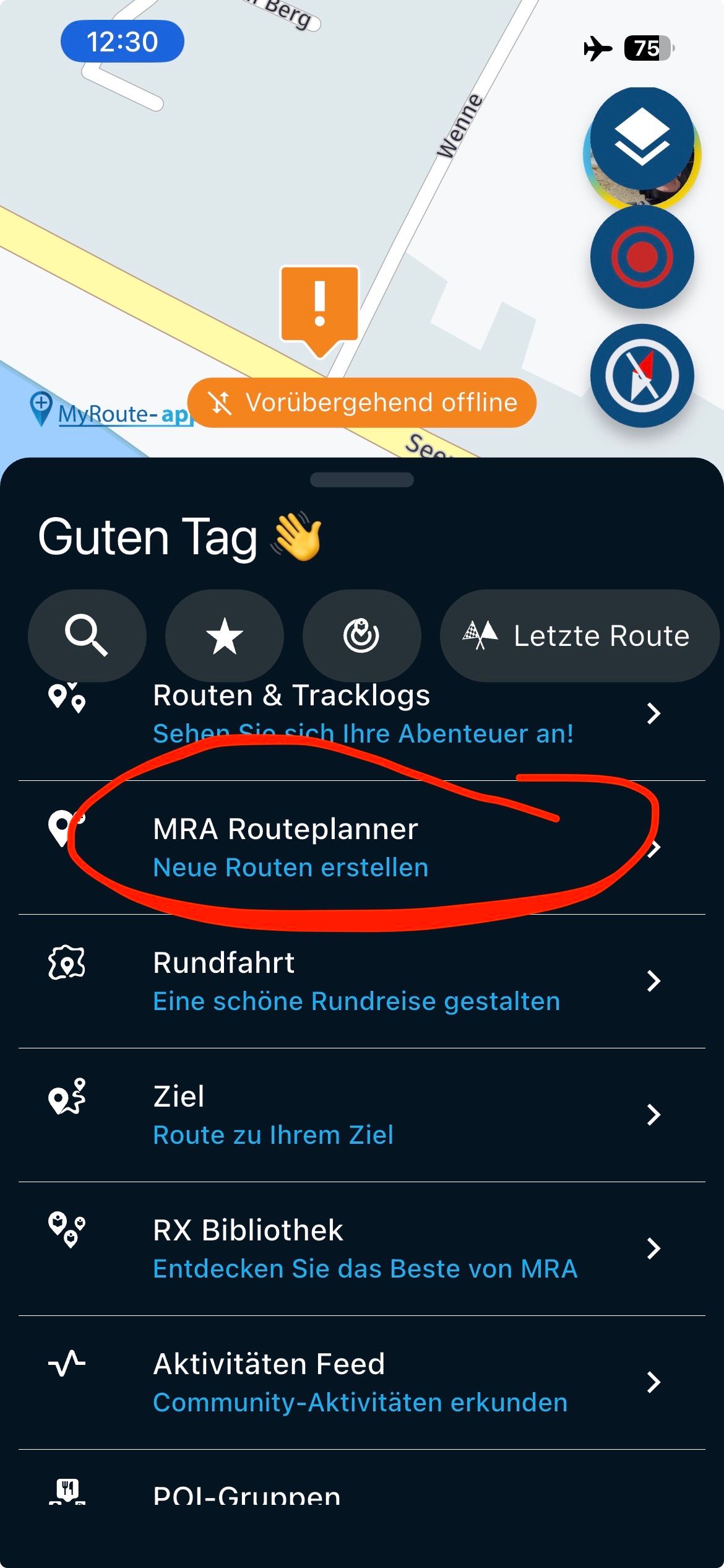

                              From all your screenshots, I can see that you are using RouteLab (which is online) from the mobile app. However, please keep in mind that if you are in an area without an internet connection, you won’t be able to use the RouteLab to change your routes !!
                              Unfortunately, the solution you are showing in your answers doesn’t solve the issue I’m trying to address.

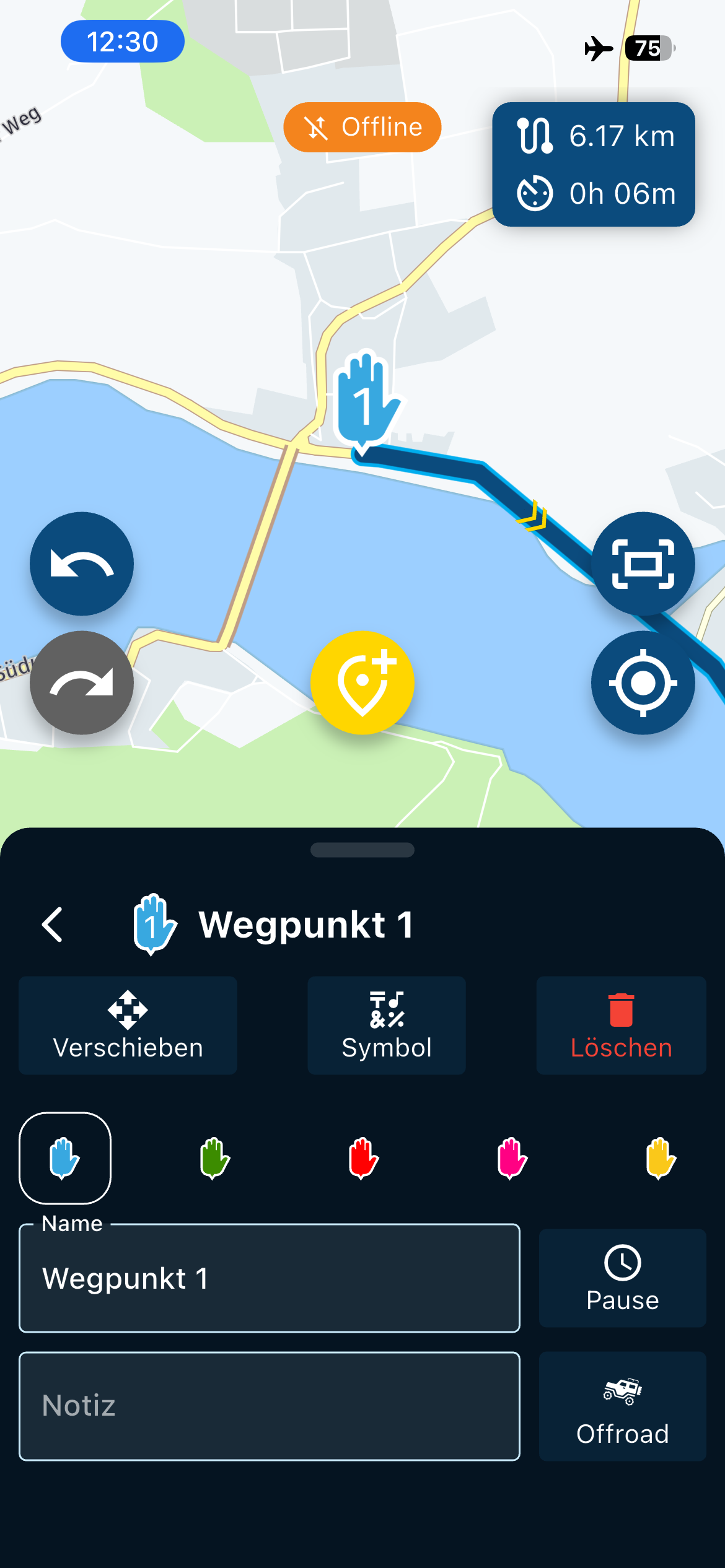

                                That's how it works offline...
