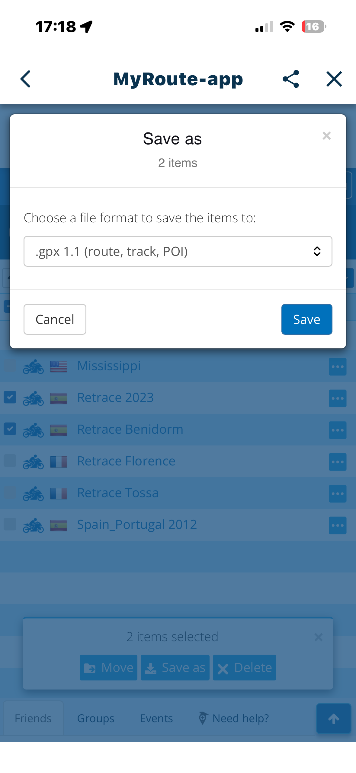

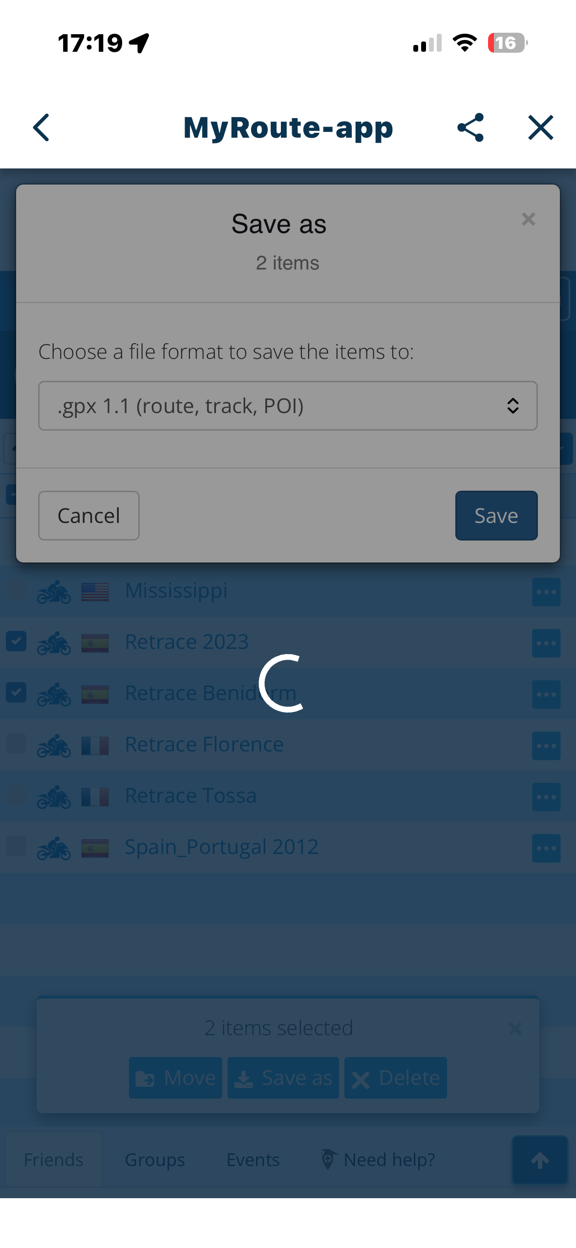

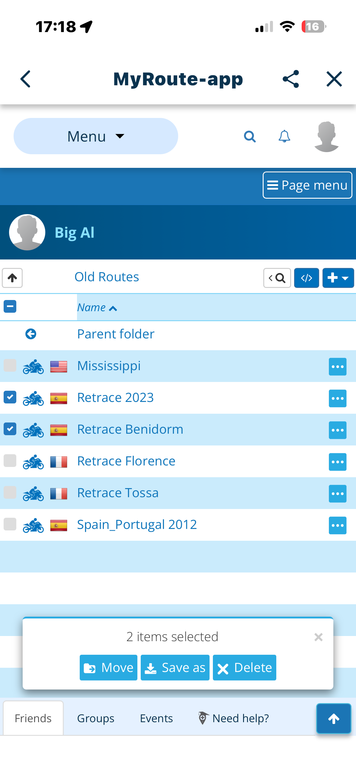

    From the “Routes” list, ‘select’ more than one route by ticking in the leftmost box. Click ‘Save as’ at the bottom of the screen and select the type (.GPX 1.1 etc). This results in a ‘Please Wait’ meassge followed closely by the rotating circle (busy)…..and that’s it. Seems like the program is in a loop.

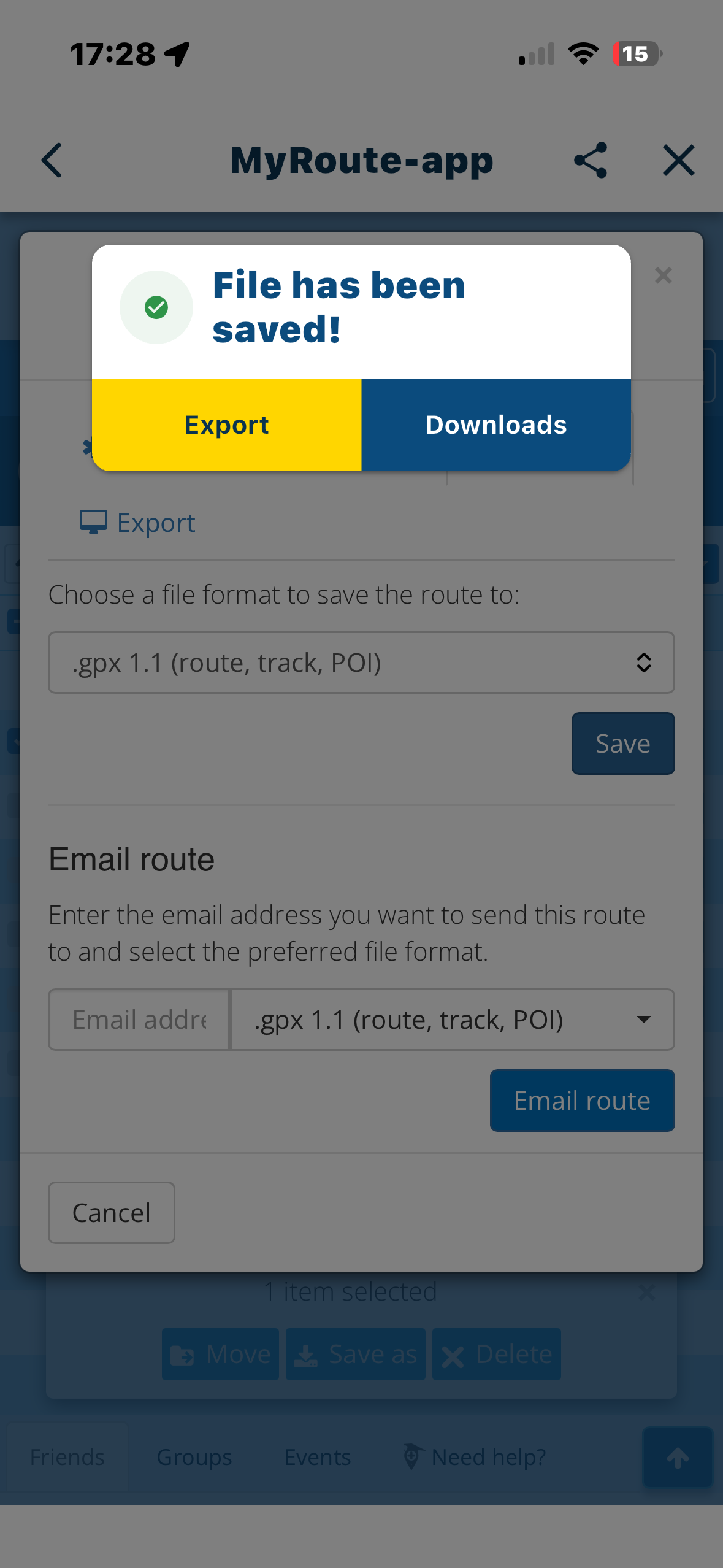

    I suspect there is a hidden “File has been saved……..Export/Download” (see photo) dialogue in the background going unanswered on multiple selects . Works OK when only one file is selected.

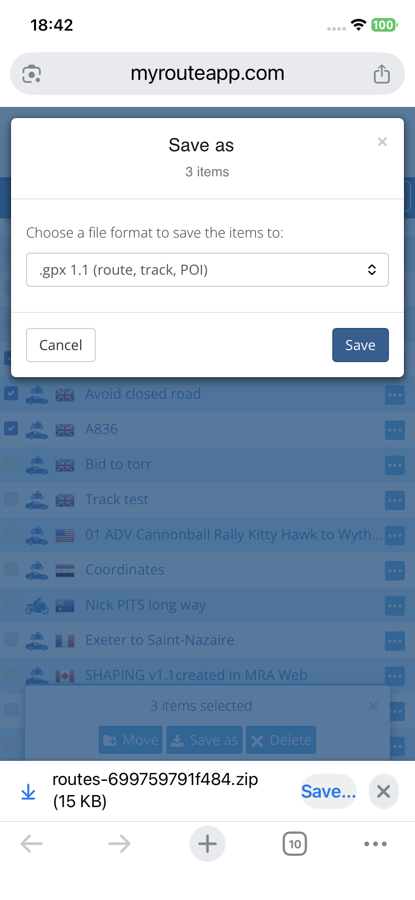

      @Big-Al-1 I have never saved multiple files from my phone so I replicated your test. I get the option to save the 3 chosen files in a Zip folder to my Files folder.

                      OK - using just Safari and selecting multiple files, the web version creates a zip file in the Downloads folder, which when unzipped, creates a folder with the GPX files in there.
                      Using the app directly on an Apple device, and doing the ‘save as’ from the route itself, the system saves the file on the iPad in the MyRoute-App folder. So it seems we have 2 different types of operation here…and one doesn’t work. Is this Ok with you guys that at My-Route?
