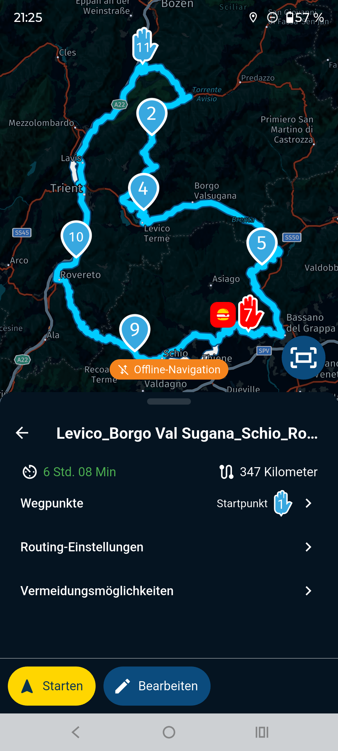

    Oggi sono uscito un giro, avevo preparato un itinerario a casa, che ho sincronizzato con l'app, mi fermo a mangiare, fermo la navigazione, quando finisco di mangiare, presto a partire, riavvio il percorso e l'app mi dice IMPOSSIBILE CALCOLARE IL PERCORSO... Era un'area in cui non c'era segnale telefonico, ho anche provato ad attivare la navigazione offline, ho scaricato tutte le mappe dell'Italia, non dovrebbe navigare anche se non c'è segnale telefonico e dati? Ti lascio alcuni screenshot...IMG_2778.png IMG_2779.png
    • Aiello antonino
      Sorry, I thought I had translated...
      Today I went out for a ride, I had prepared an itinerary at home, which I synchronized with the app, I stop to eat, I stop browsing, when I finish eating, I'm about to leave, I restart the route and the app tells me IMPOSSIBLE TO CALCULATE THE ROUTE... It was an area where there was no phone signal, I also tried to activate offline navigation, I downloaded all the maps of Italy, shouldn't it browse even if there is no phone signal and data? I'll leave you some screenshots...

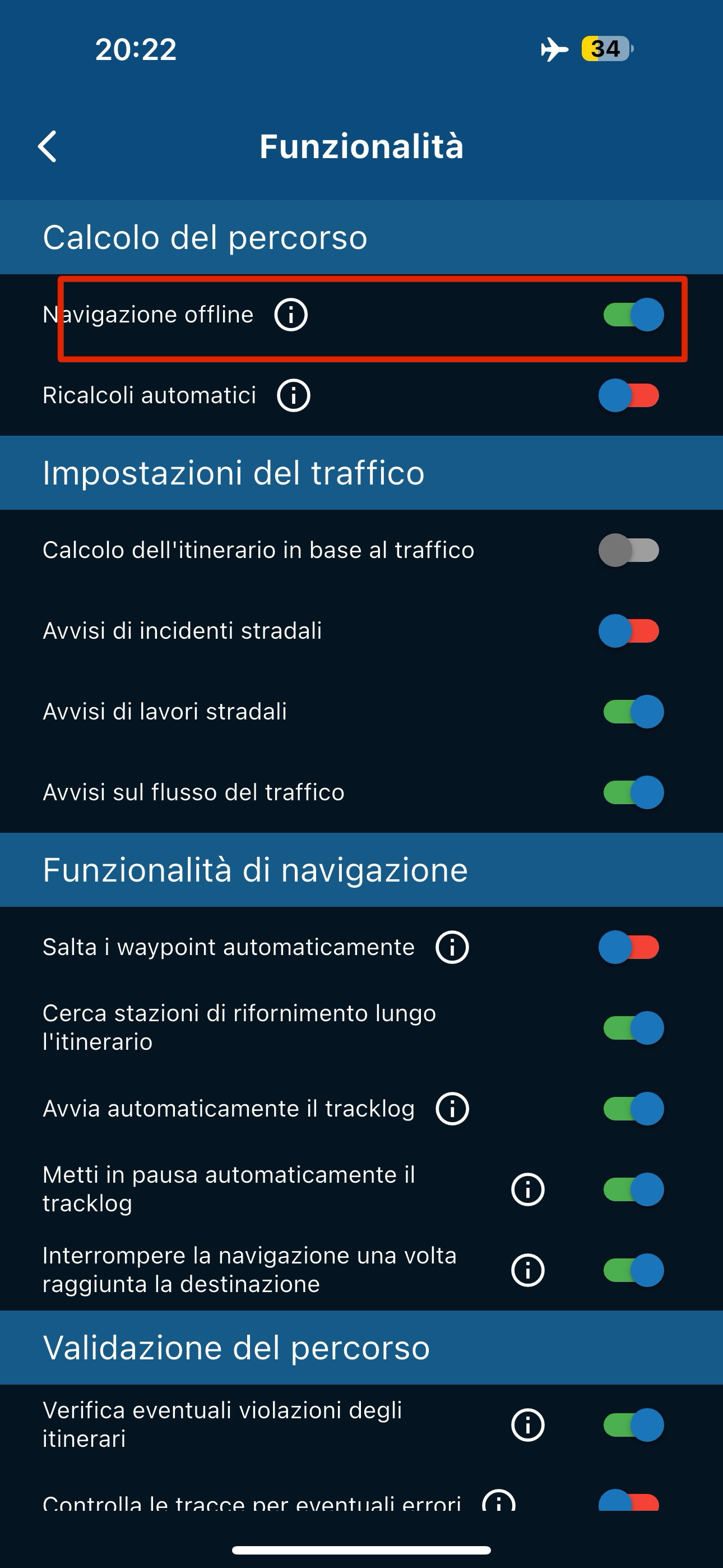

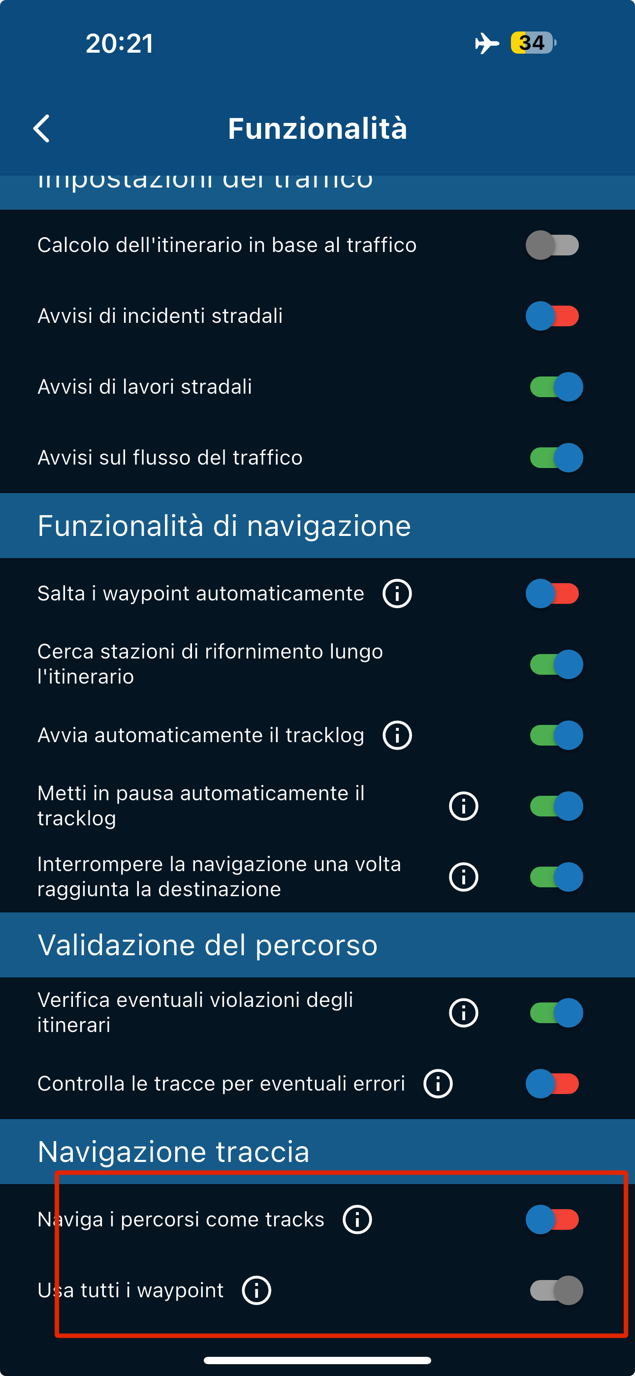

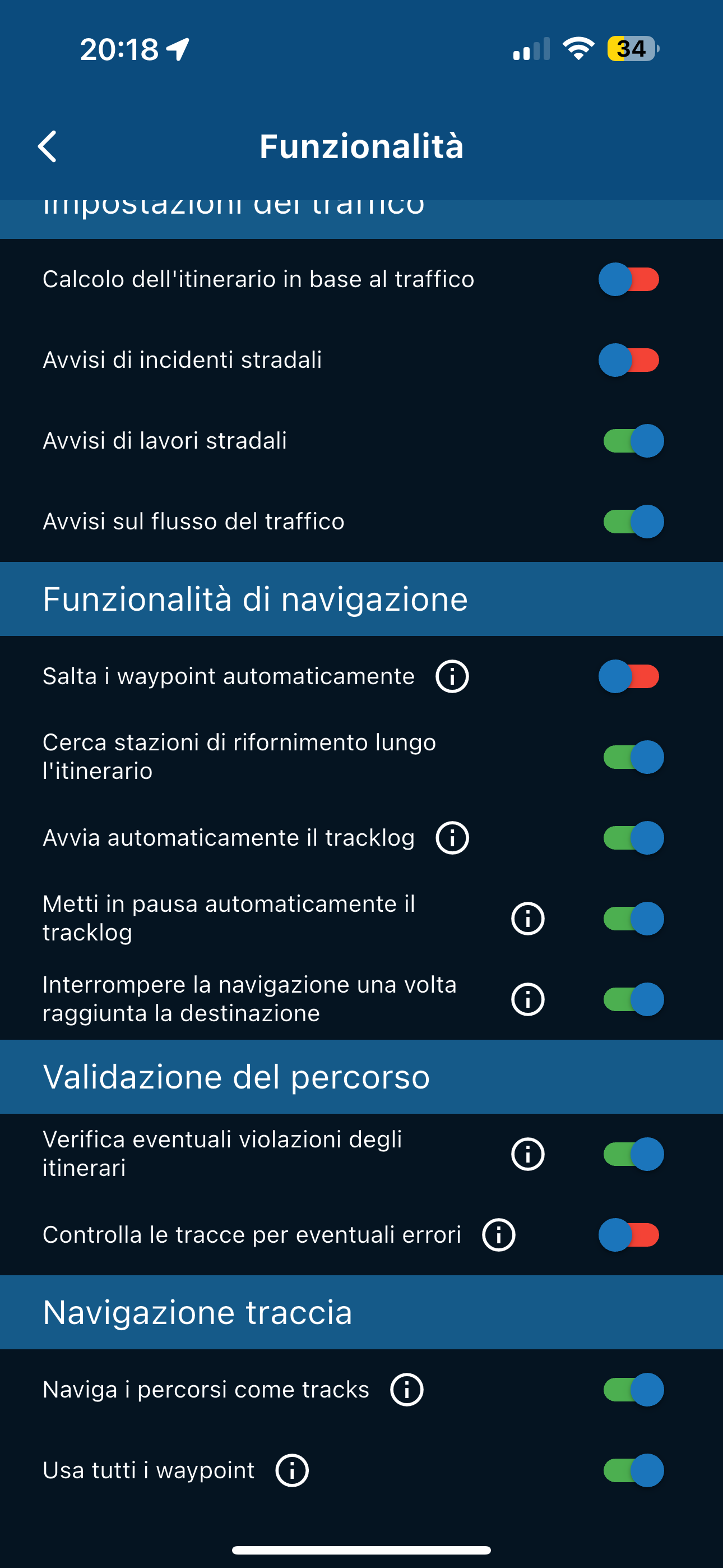

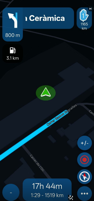

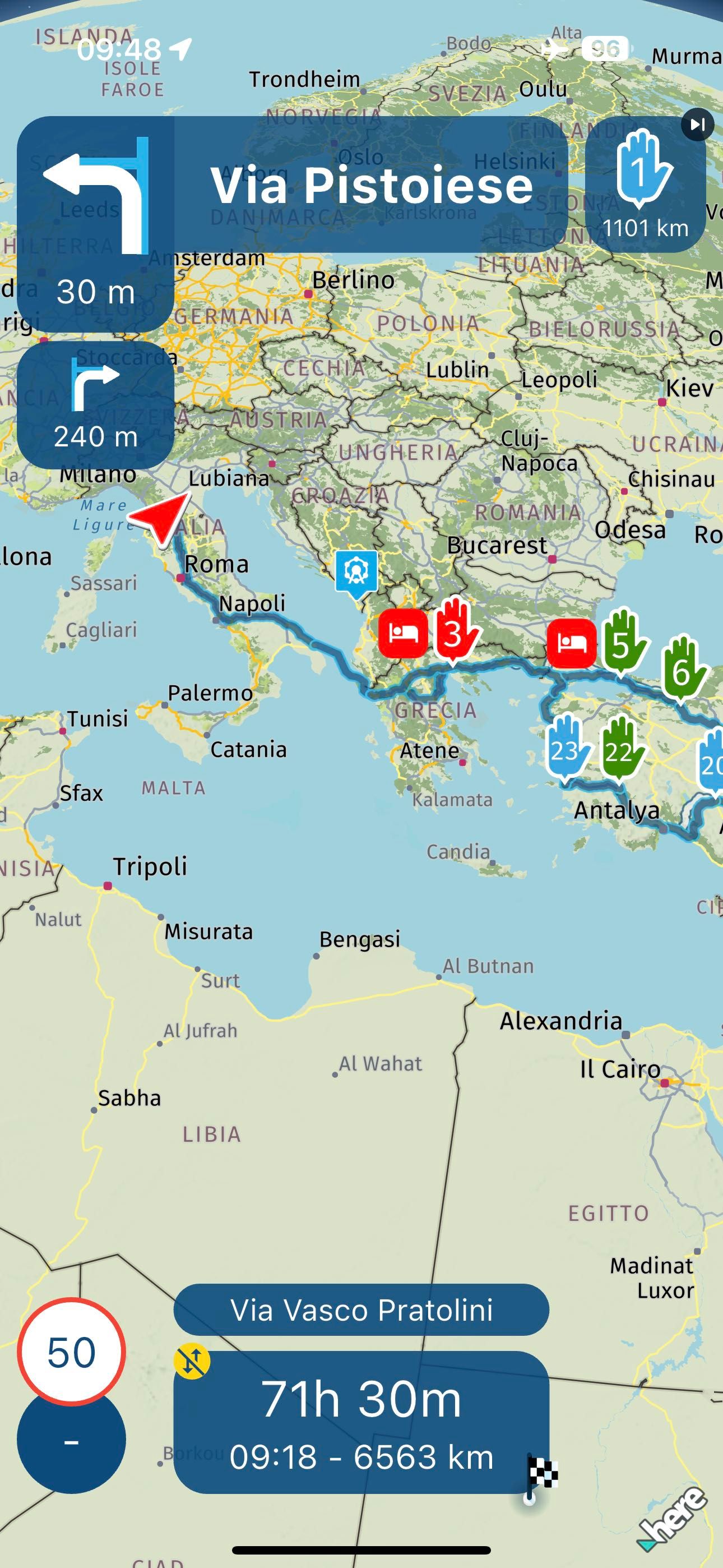

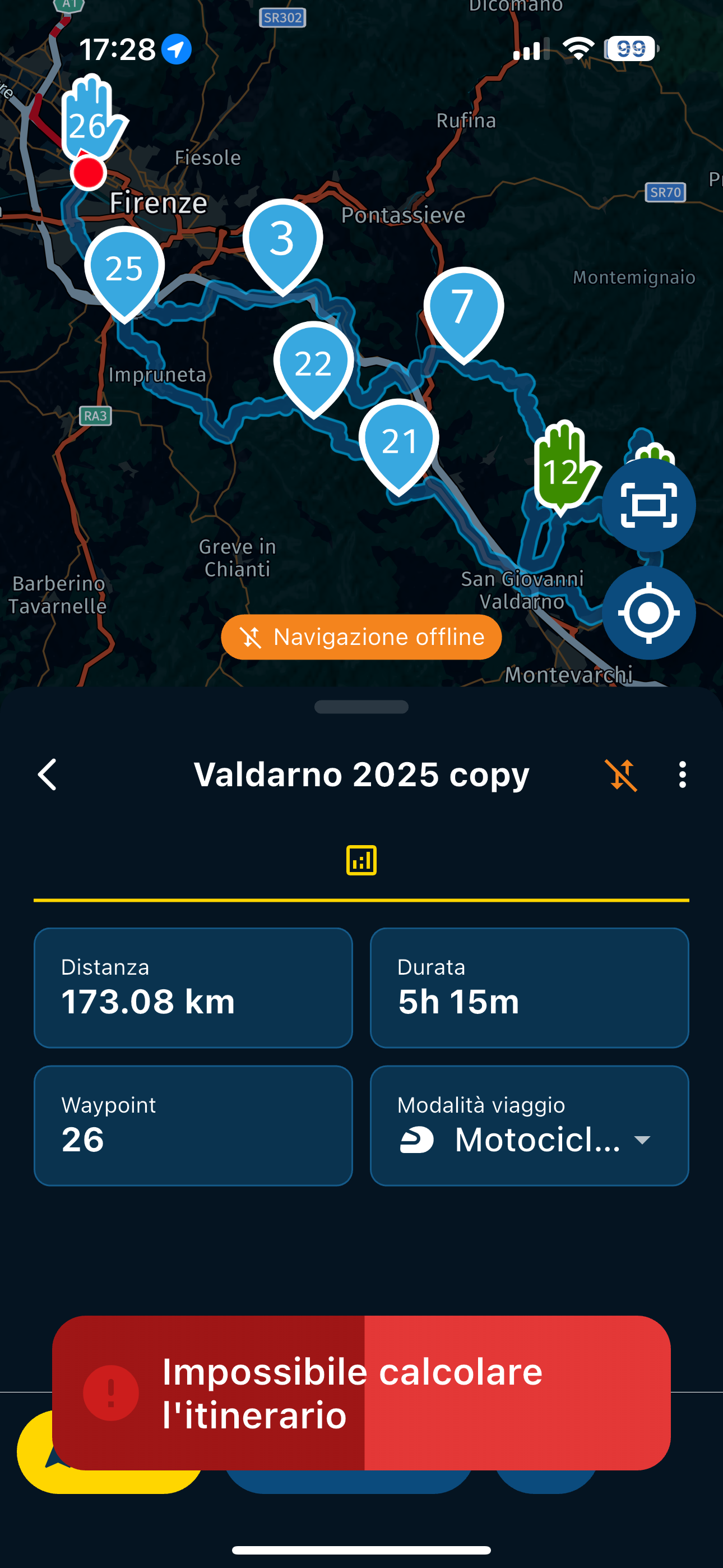

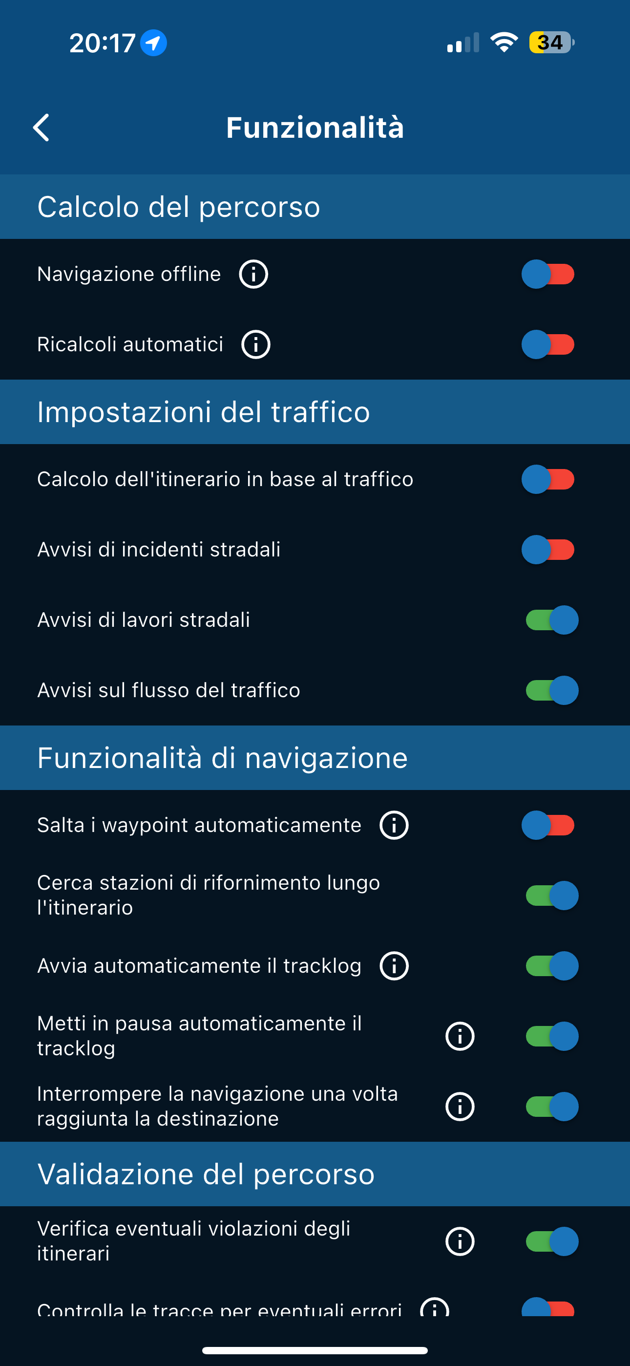

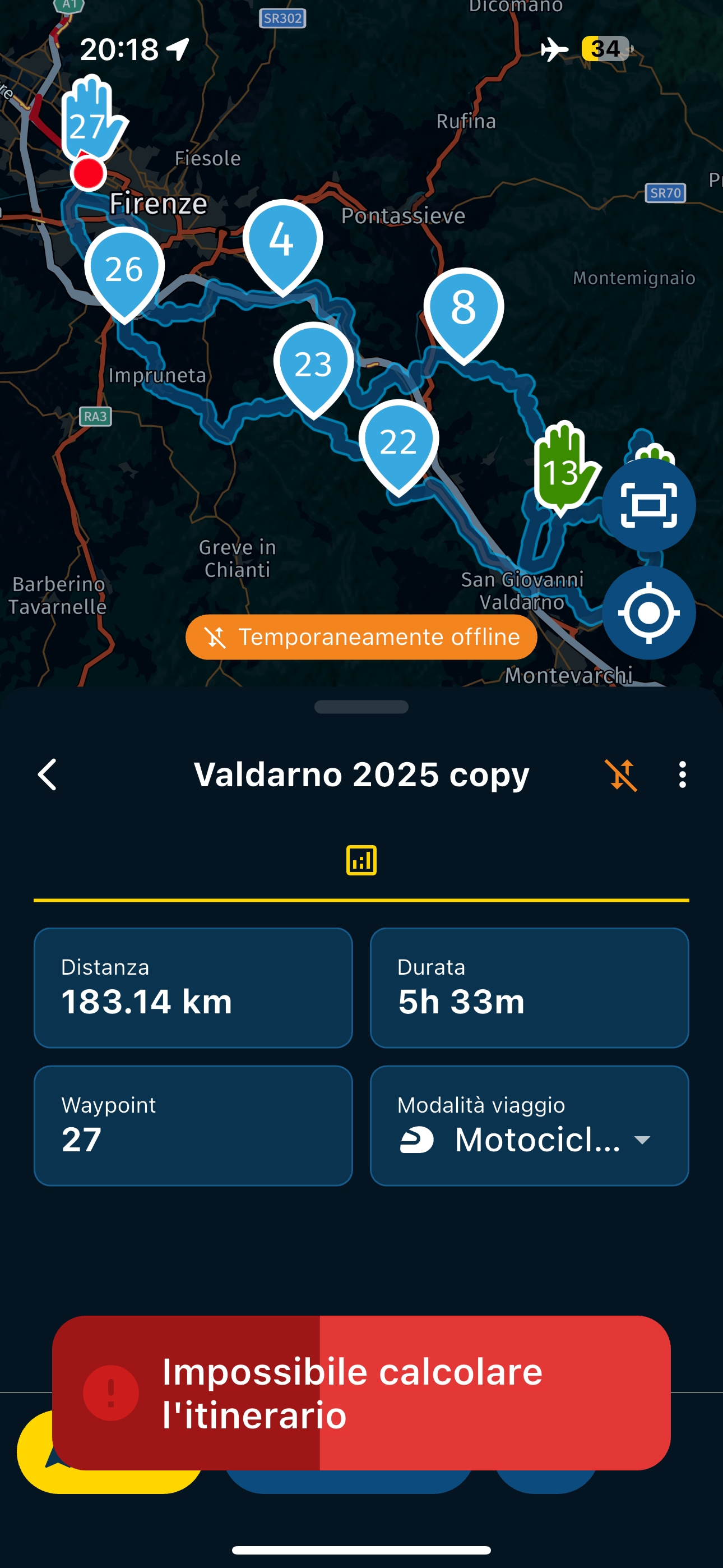

                      I did some tests, I put it in airplane mode to recreate yesterday's situation and this is what comes out, 2 different behaviors if you change certain settings, but IMPOSSIBLE to be able to use the app if there is no signal
                      With these settings
                      THIS HAPPENS
                      IF I CHANGE THE SETTINGS IN THE PHOTO BOX
                      THIS HAPPENS
                      So in these conditions, if I were to find myself somewhere (I'm planning a trip to Turkey and I don't know if I'll always have an internet connection) where there's no connection, I wouldn't be able to navigate with the app...
                      Nick Carthew Peter Zehentreiter 2 Replies Last reply
                      • Aiello antonino Aiello antonino
                        With these settings
                        THIS HAPPENS
                        THIS HAPPENS

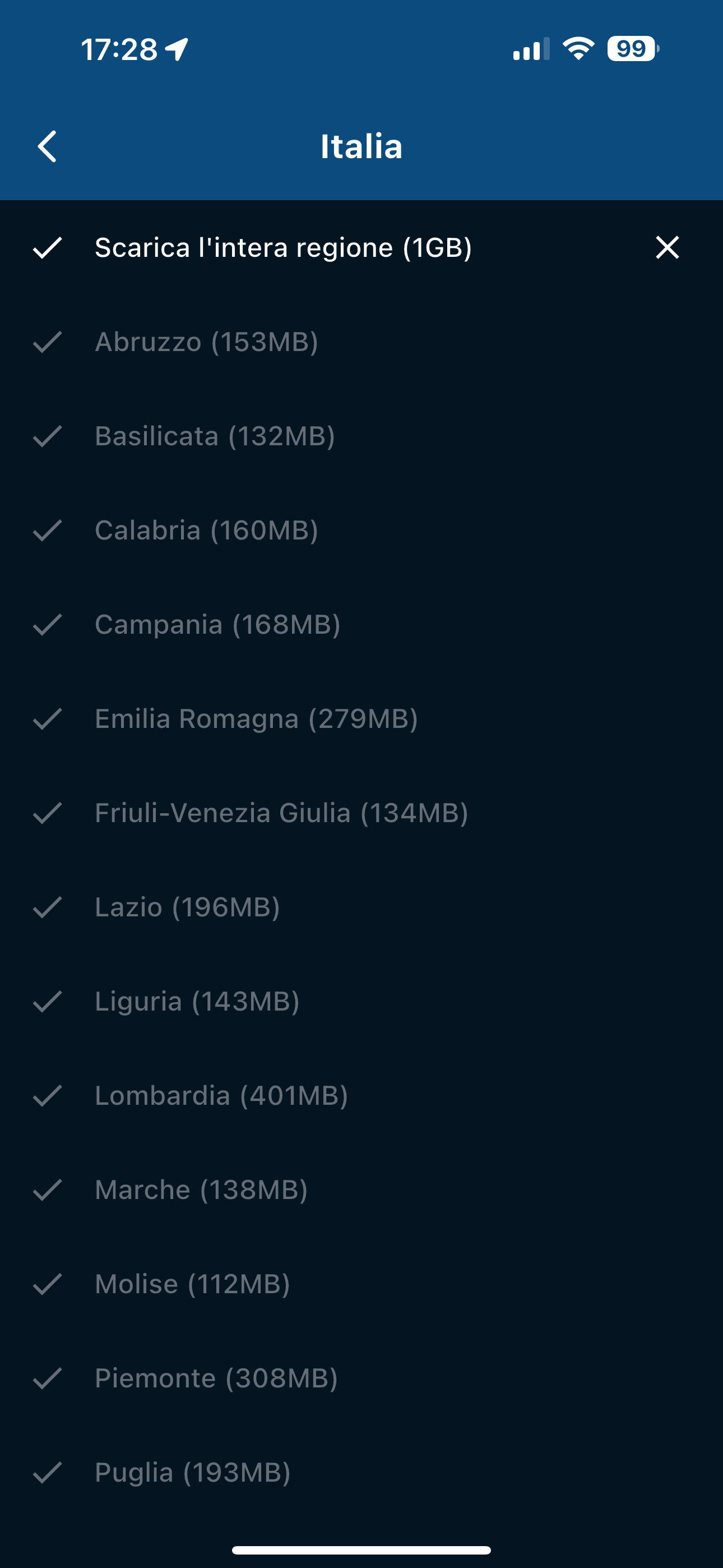

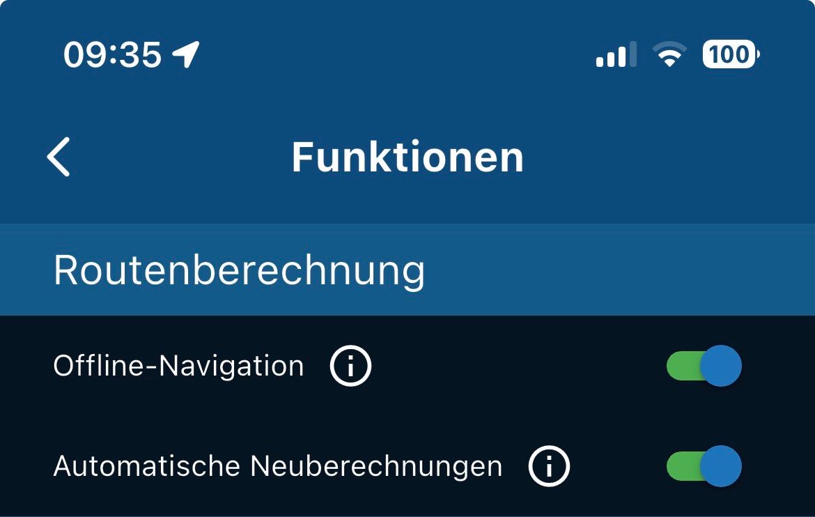

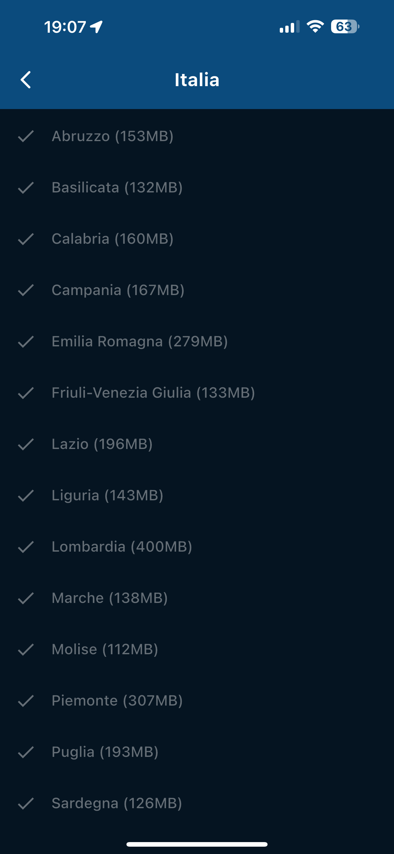

                        @Aiello-antonino said in Unable to calculate route:

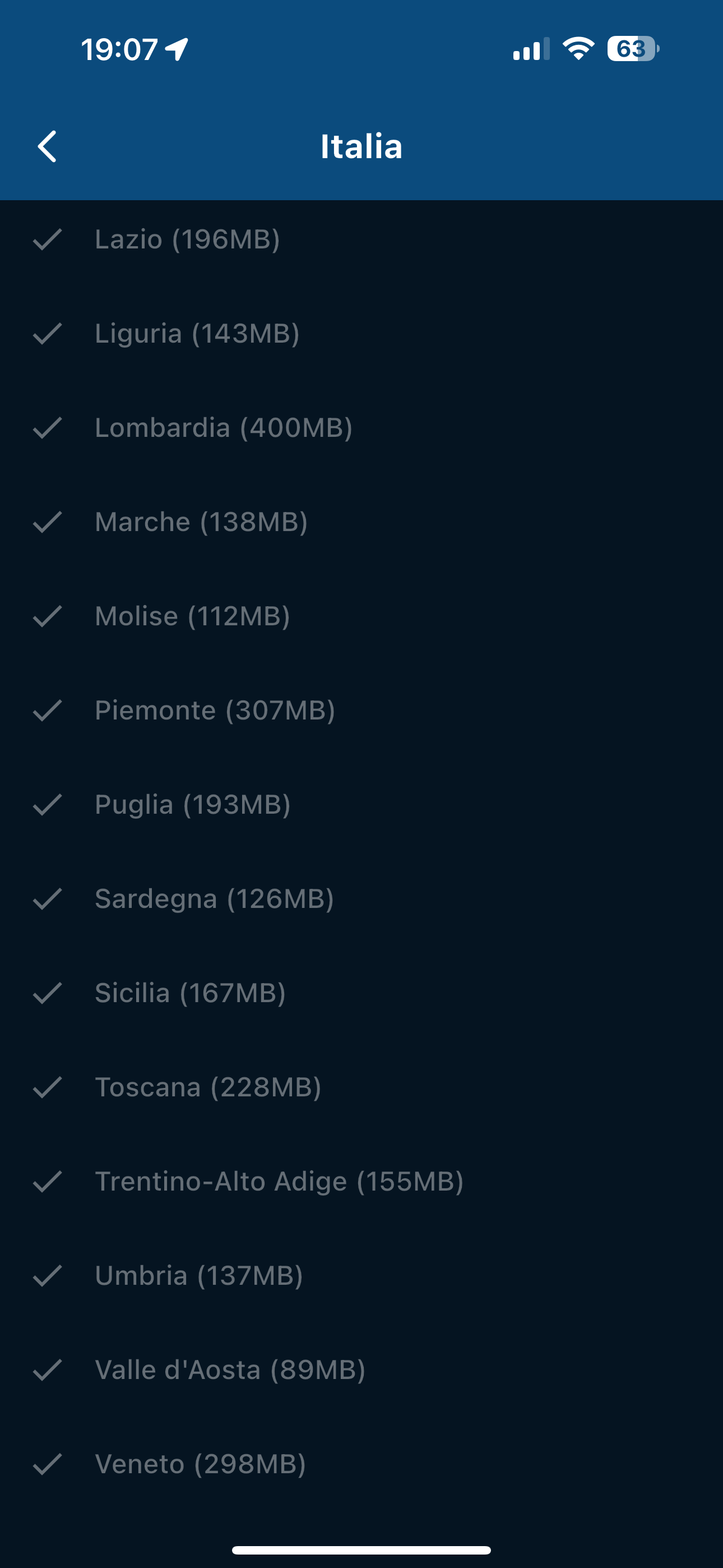

                        You need 3 things to navigate offline.
                        All of the offline maps that you will use.
                        All of the routes should be synced
                        Offline navigation selected in the functional section of Navigation settings.
                        With all these in place you can navigate entirely offline without any data connection.
                        Aiello antonino 1 Reply Last reply

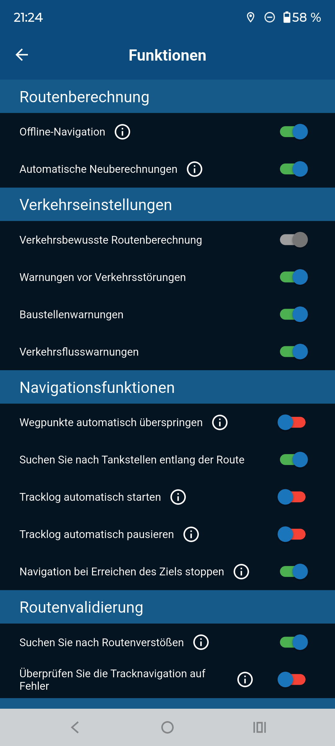

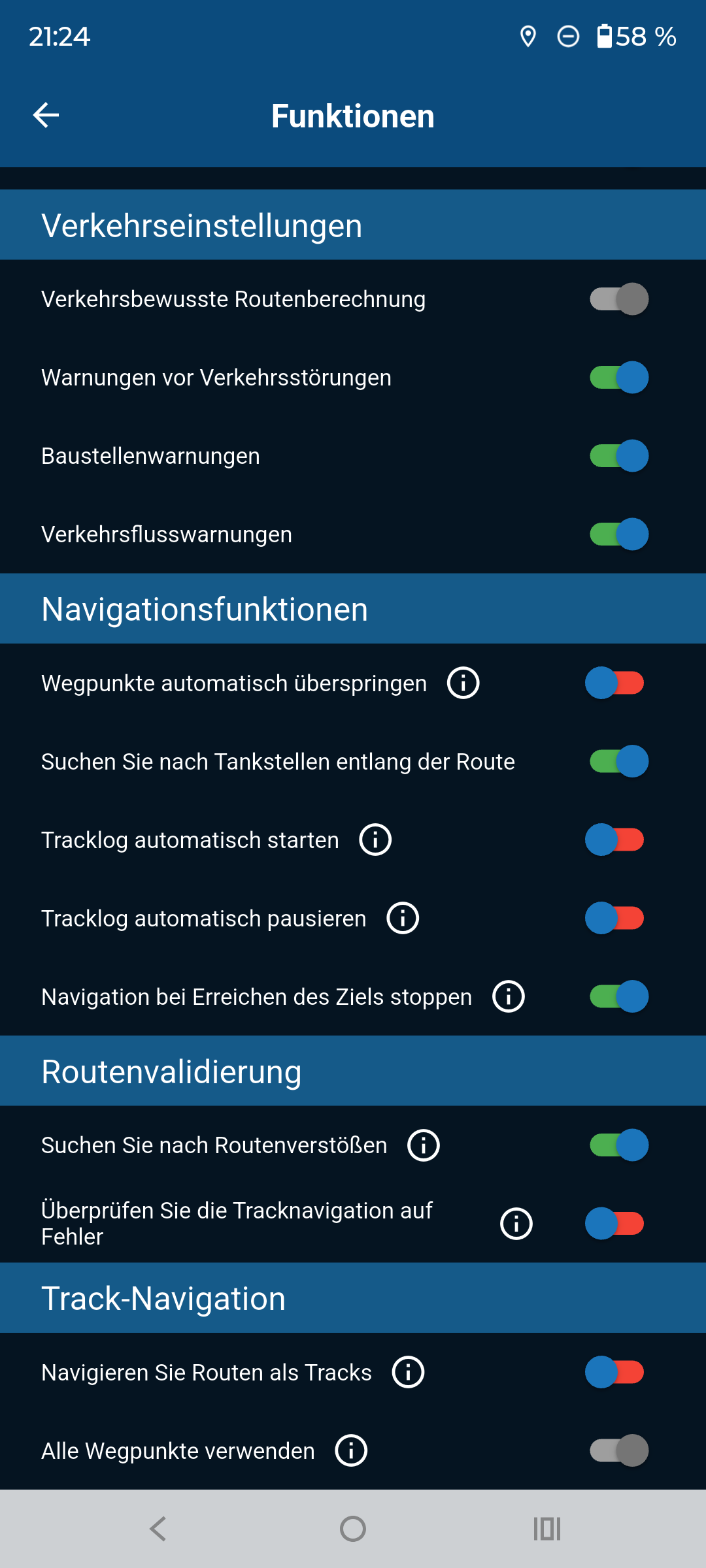

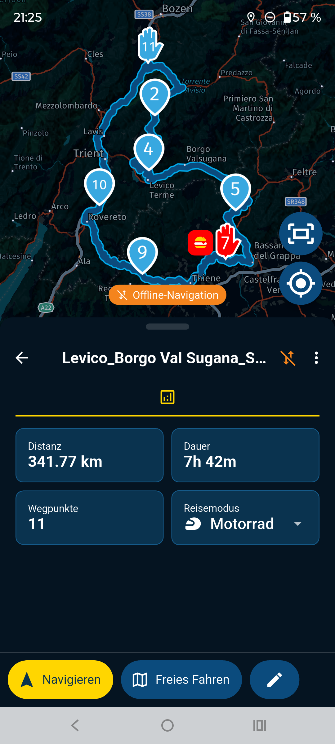

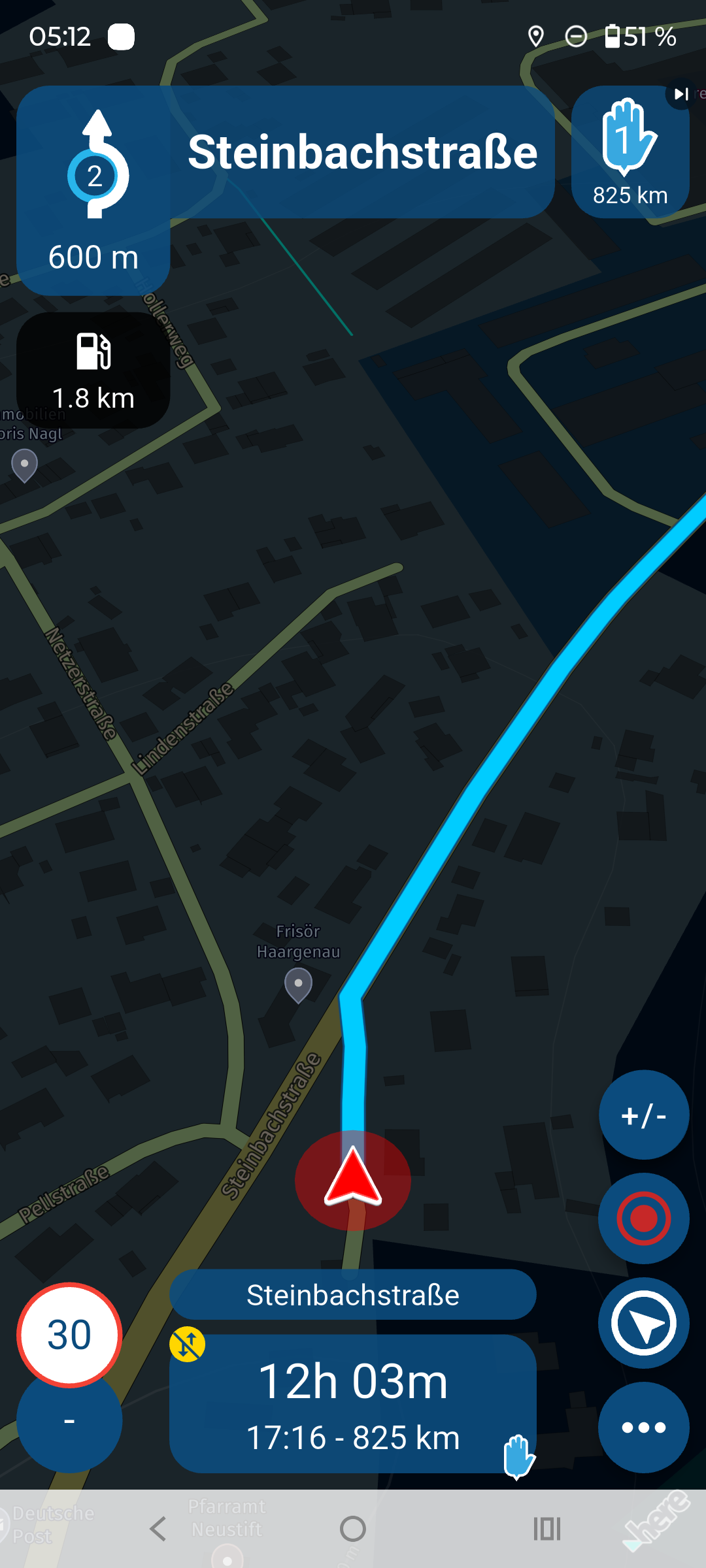

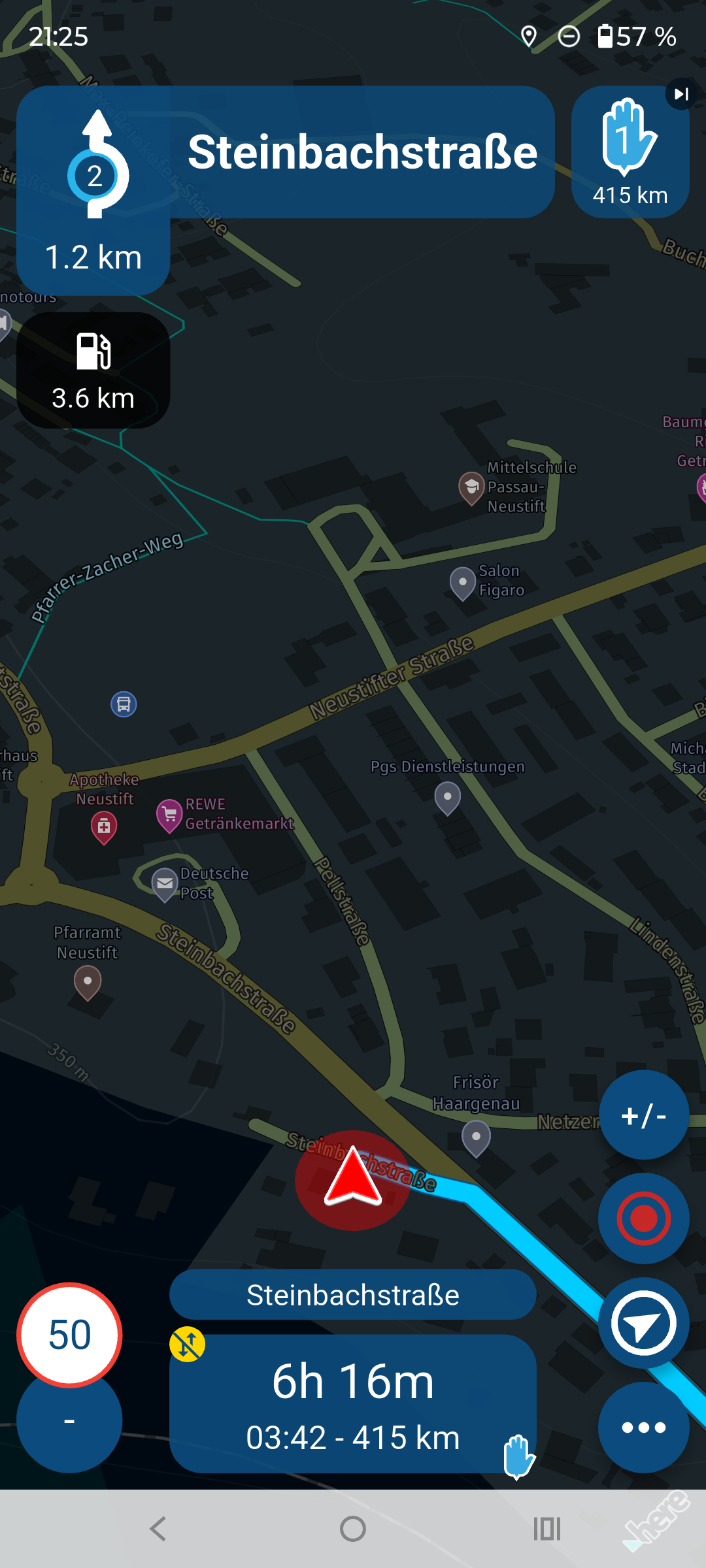

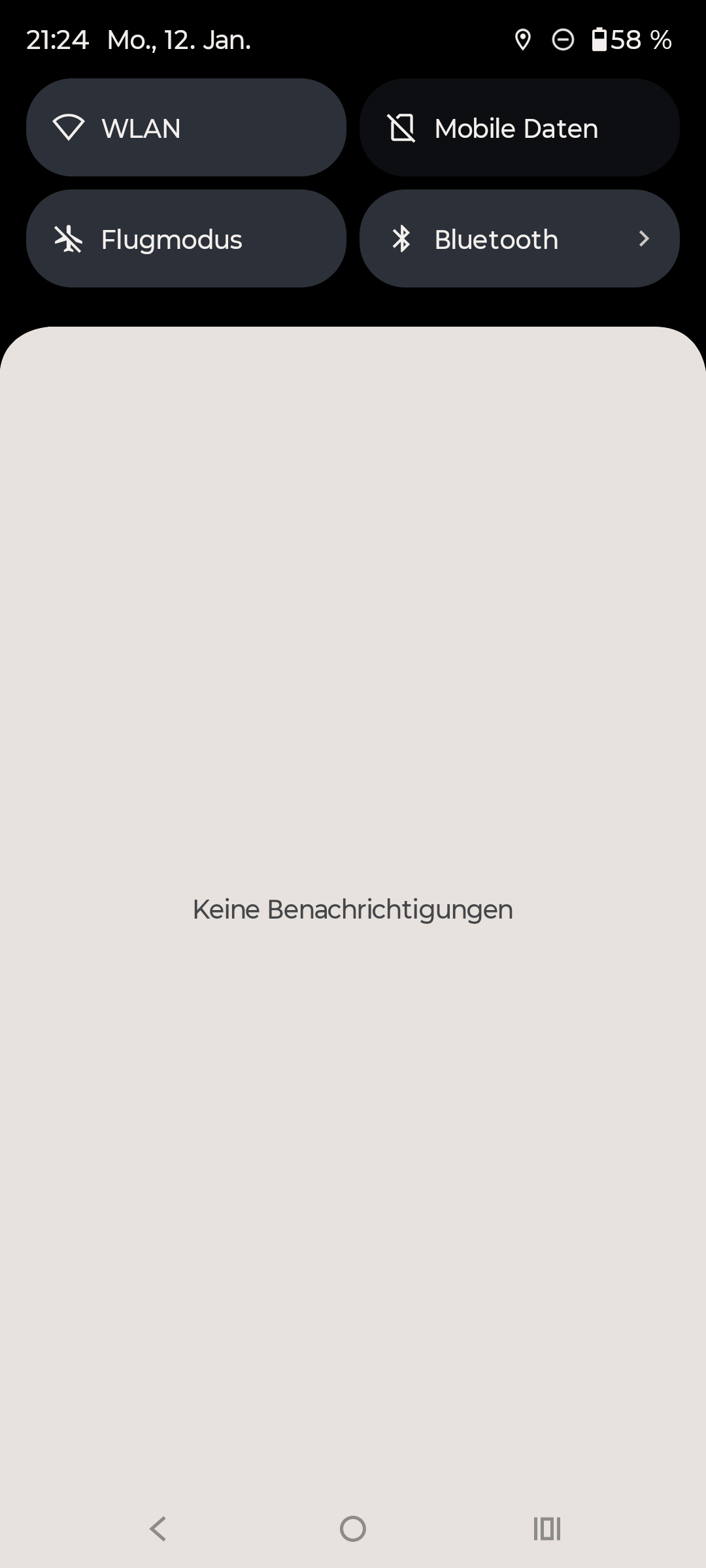

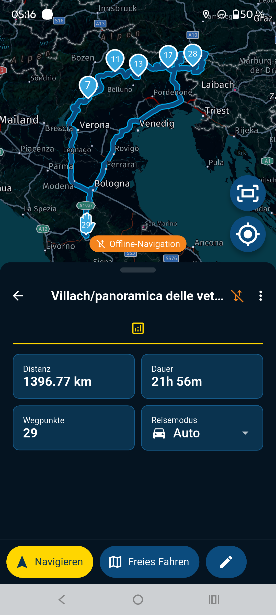

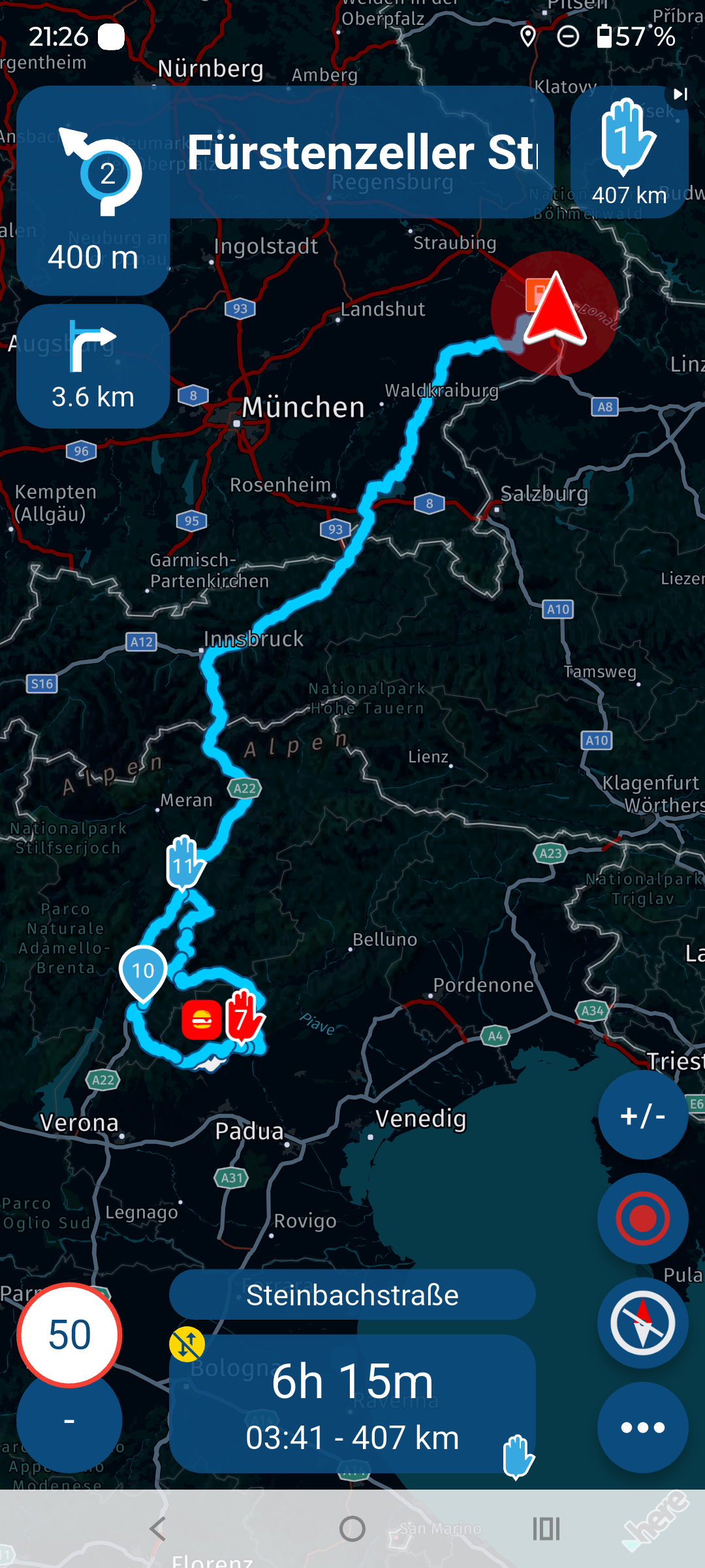

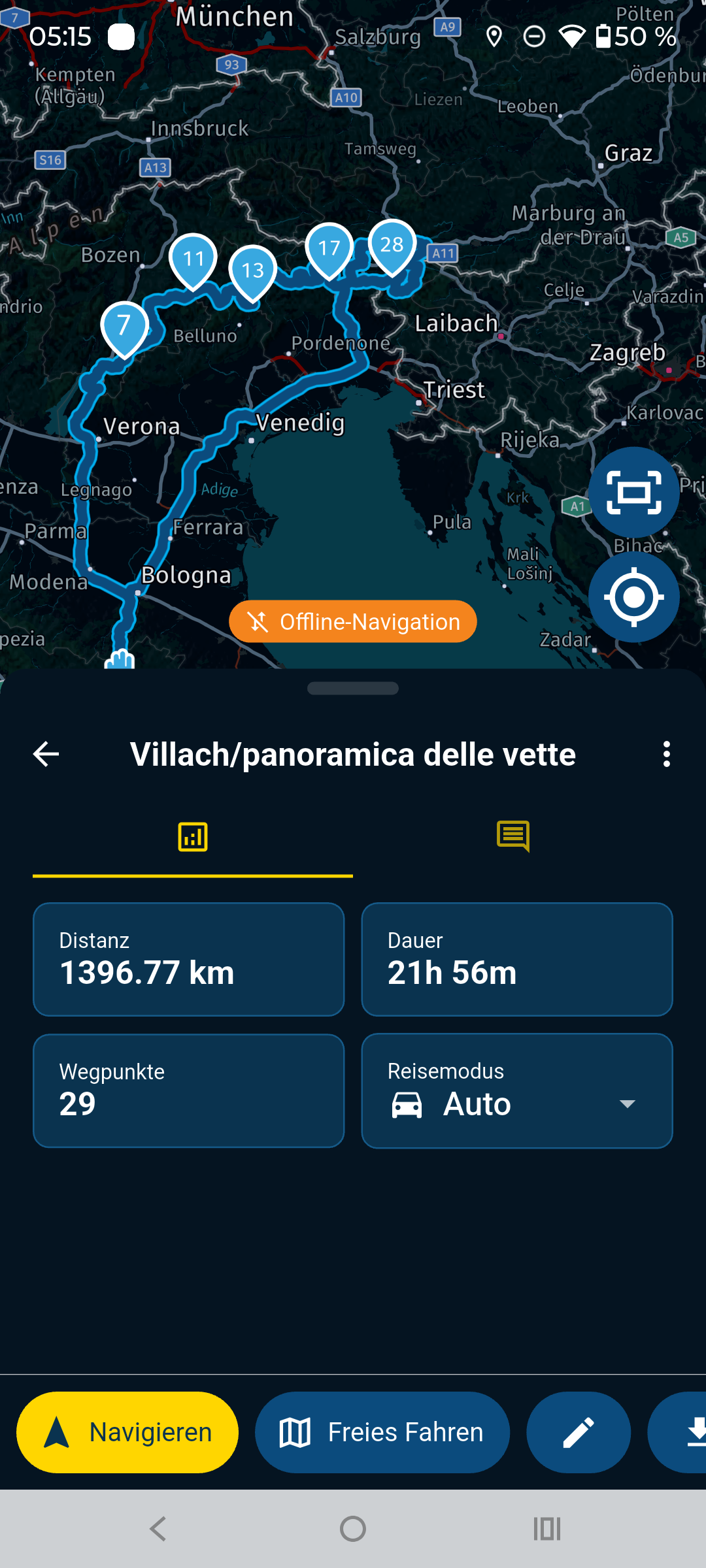

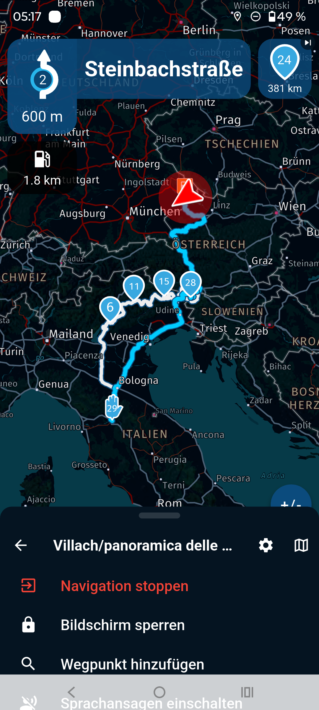

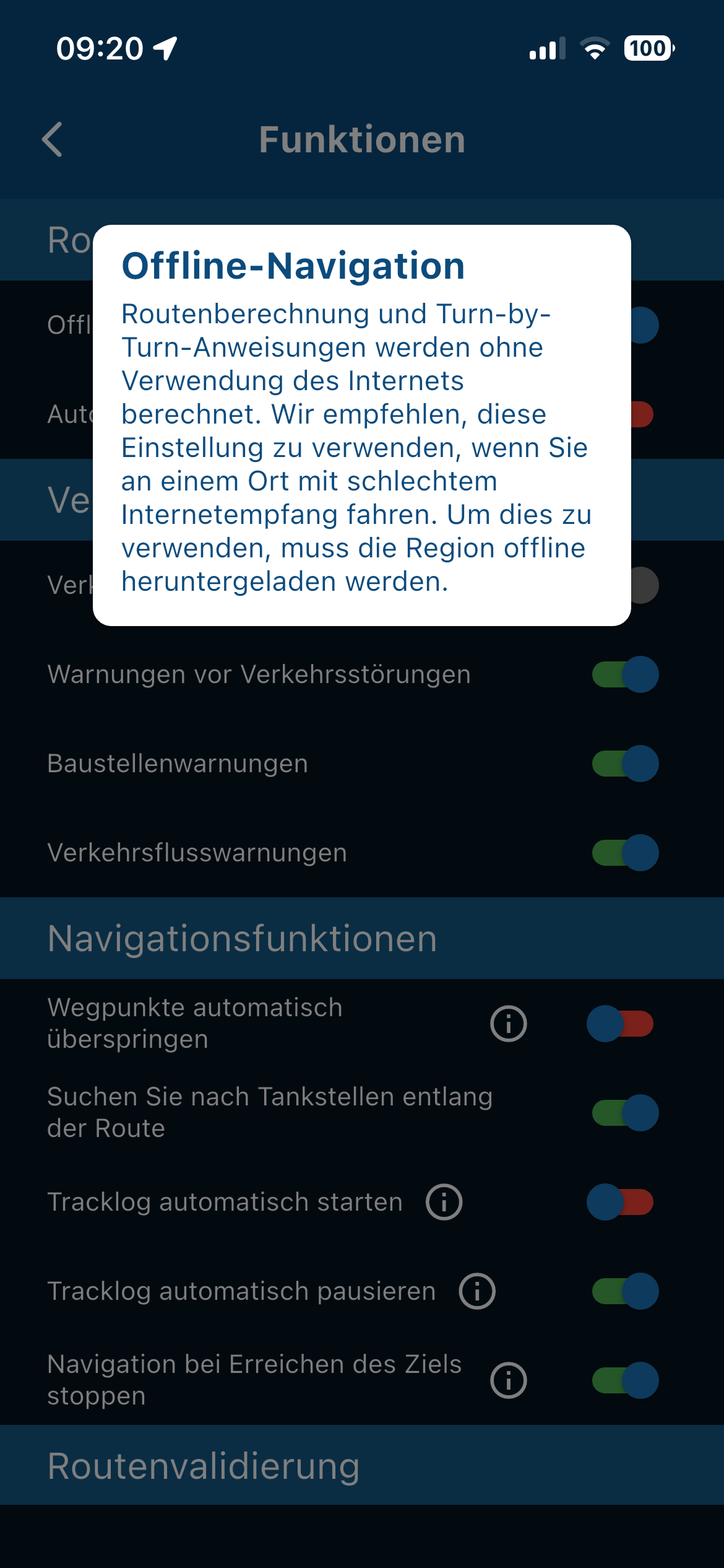

                          @Aiello-antonino I tried to recreate your problems, but was unable to get the error you mentioned.
                          Please try the following settings; they work perfectly for me.
                          Im currently in Germany and the Route I opened is in Italy, without any problems.
                          You can see from the screenshot that this mobile phone is completely offline, without a SIM card and without Wi-Fi.
                          Screenshot_20260112-212429.MyRoute-app.png Screenshot_20260112-212443.MyRoute-app.png Screenshot_20260112-212453.MyRoute-app.png Screenshot_20260112-212515.MyRoute-app.png Screenshot_20260112-212529.MyRoute-app.png Screenshot_20260112-212548.MyRoute-app.png Screenshot_20260112-212613.MyRoute-app.png
                          Aiello antonino 2 Replies Last reply

                            @Nick-Carthew As you can see from the photos I did everything you write, I forgot to upload the photo where you can see that I have all the maps offline, but here it is...!
                            • Peter Zehentreiter Peter Zehentreiter
                              @Peter-Zehentreiter I just checked your settings and they are the same as mine in the various tests, but it doesn't work for me…

                                    I don't understand...now it's working perfectly as I thought it should be...

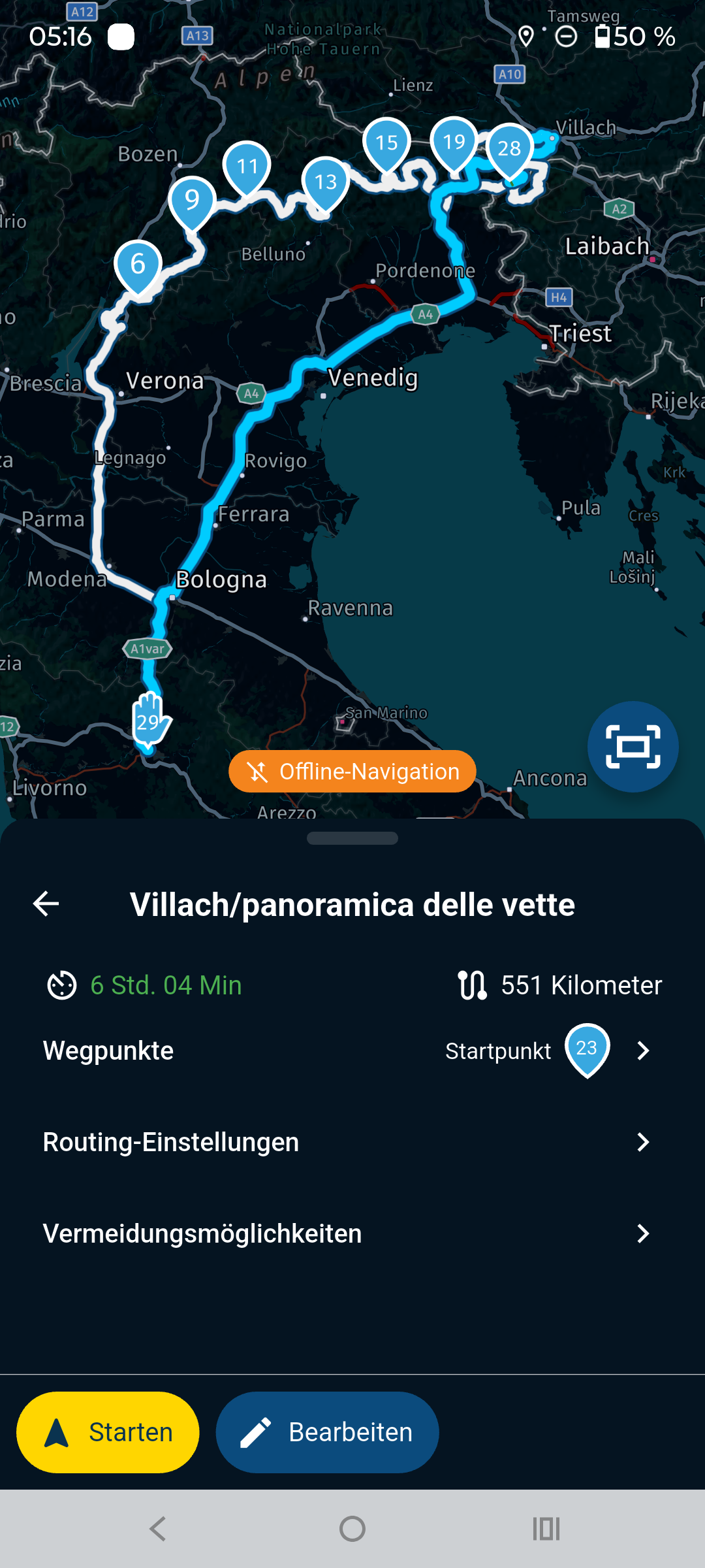

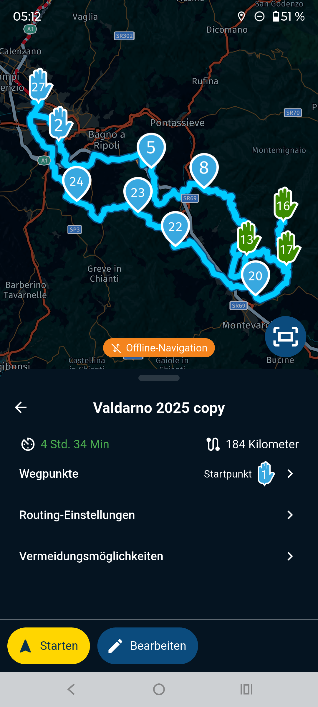

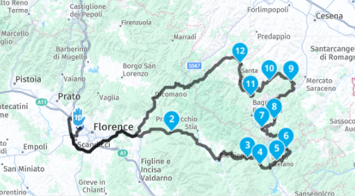

                                        It's behaving very strangely. Although all the library's openings and paths are synced, it seems some aren't. The one I was trying earlier, which I linked to, started working, and I don't understand why. Now I'm trying to load others, but some work, and others don't... I just don't understand. I'll leave you with one that can't calculate the path at the moment. Could it be that I'm doing something wrong?
                                        https://www.myrouteapp.com/it/social/route/558376?
                                        Peter Zehentreiter 1 Reply Last reply

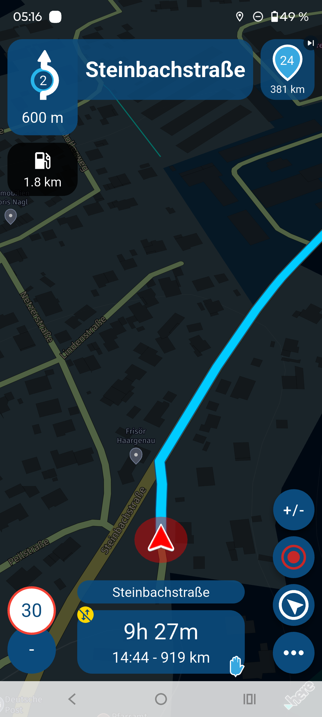

                                          @Aiello-antonino Both routes you set up for us to test, work for me.
                                          However, for the route “Villach/panoramica delle vette,” there is a note that routes with off-road points only work online.
                                          I briefly checked your waypoints, and some of them are not correct on the line.
                                          When setting your waypoints, you should also make sure not to place them in the middle of an intersection or roundabout, but rather after them.
                                          Screenshot_20260113-051215.MyRoute-app.png Screenshot_20260113-051254.MyRoute-app.png Screenshot_20260113-051317.MyRoute-app.png Screenshot_20260113-051536.MyRoute-app.png Screenshot_20260113-051613.MyRoute-app.png Screenshot_20260113-051635.MyRoute-app.png Screenshot_20260113-051650.MyRoute-app.png Screenshot_20260113-051705.MyRoute-app.png
