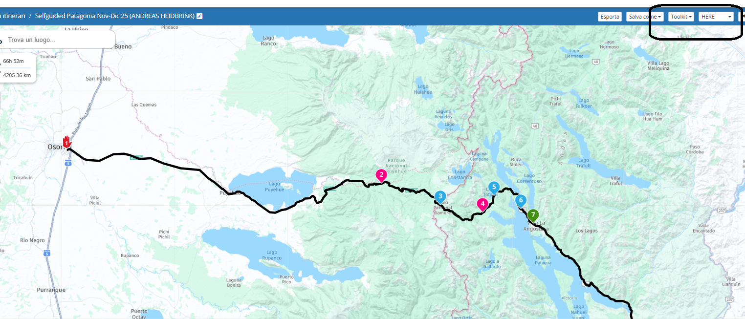

      At first glance, it sounds like that you have selected the wrong transport modus and have the route optimization set to Fastest instead of shortest. But this can only be done when the map is set to HERE.
      Another thing which could causing the problem is seasonal closure. Turning it off will give you also another route compared to turning it on.
      Which map are you using?

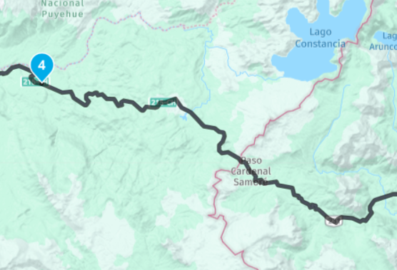

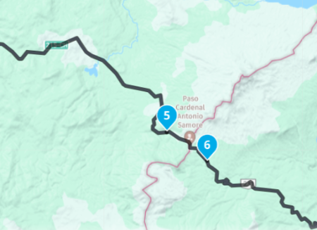

      I just made a route by myself, using HERE and set the route optimization to Shortest and the transport modus to Car.
      As you can see, waypoints 5 and 6 are passing the border without any issues (screenshot 1). Even removing some waypoints does have no effect (screenshot 2).

              This would be the problem.
              Between waypoints 1 and 2 there are no more waypoints. Best is to place some extra waypoints before/after the Cardenal Samoré pass so you pass the border at that point (yellow marked part of the route).
              Waypoint 2 is placed far beyond the Cardenal Samoré pass giving MRA the opportunity to come up with a route you don't like.
              As you can see in my screenshot(s) i placed a waypoint before and after the border at Cardenal Samoré. This forces MRA to pass the border at this location. You don't have to do it like this, but placing 1 waypoint before the border should do the trick. And also change the map from OpenStreetMap to HERE. That will fix this issue also.

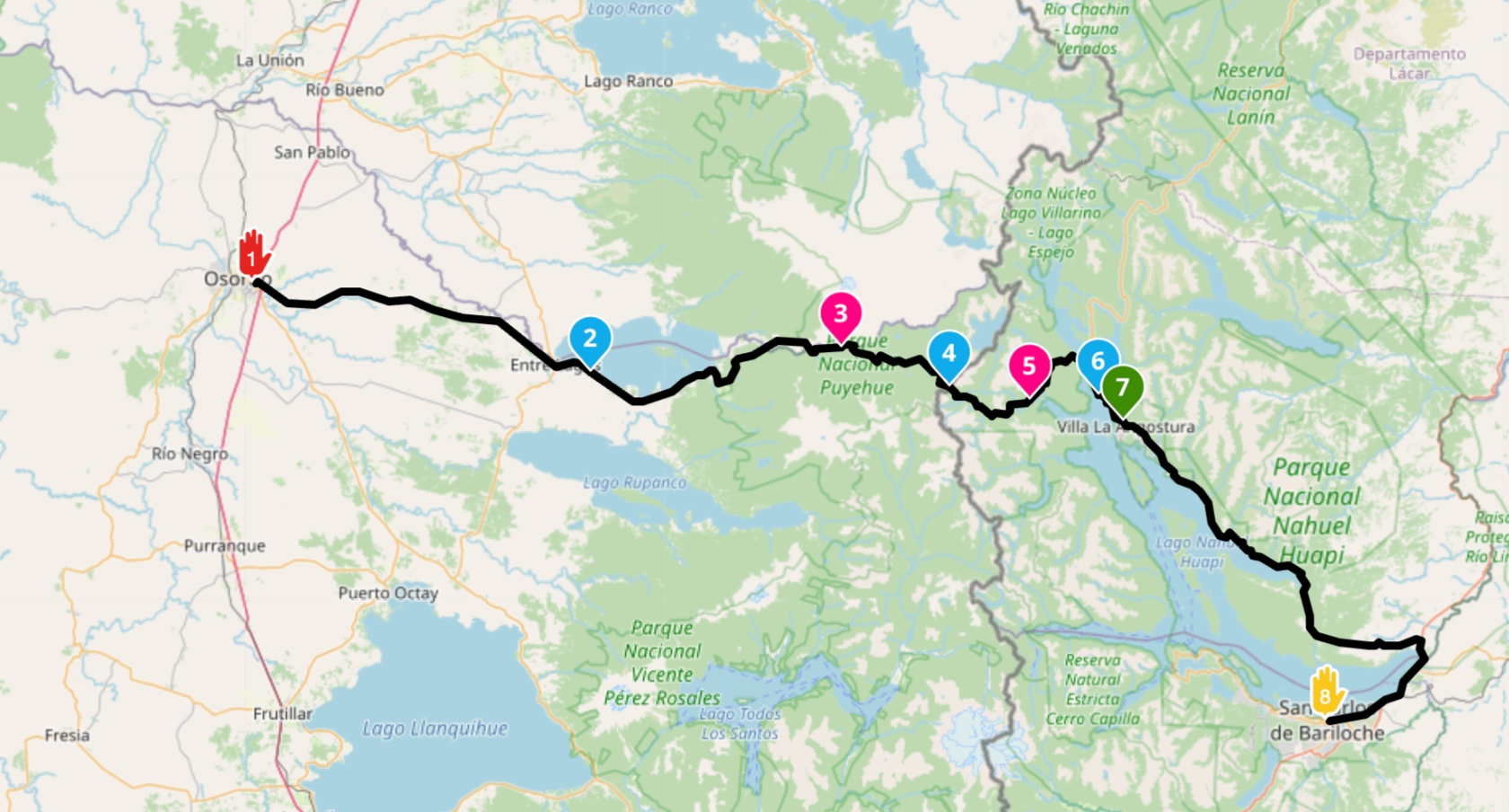

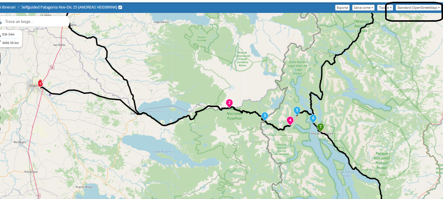

                      • Alex reds
                        Alex reds
                        Alex reds
                        I actually tried it myself, just like Nomko said, and it works. With the OpenStreetMap map, even though you can see the road, it makes you take a huge detour, while with the Here map it follows the route you’d expect.

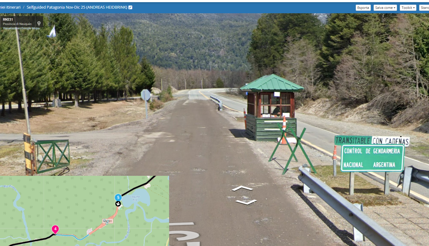

                            Anyway, even if the planning shows that detour, once you reach point 4 you just continue on the road, and when you get to point 5 you’ll carry on toward point 6 without any effect on the rest of the route.
                            • Alex reds
                              Alex reds
                              Alex reds
                              Not sure about this one… can we actually pass through here?
                              • Rob Veerman
                                Transitable con cadenas=passable with snow chains (depending on the time of the year, I suppose).

                                          Hi @DAVID-PUEYO-TORRES I don't think it is anything to do with subscriptions
                                          To me the problem appears to be with the MRA version of the OpenStreetMap map data
                                          On MRA using OpenStreetMap to calculate the route the path refuses to pass through the border post
                                          On the OpenStreetMap website the routing passes through the border post with no problem
                                          The normal way of getting around routing issues like this is to use the "offroad / skip" function,
                                          it is very often used to enable routes over rivers / ferry crossings
                                          add two points (4 & 5 ) similar to what I have shown either side of the border crossing
                                          then click point 5 & select the "offroad / skip" icon to route straight between 4&5
                                          MRA has their own version of the OpenStreetMap data & it is not always the same as that on the OSM site
                                          Its possible that the MRA version is out of date or that the snapshot that MRA took had some bad edits for the border post
