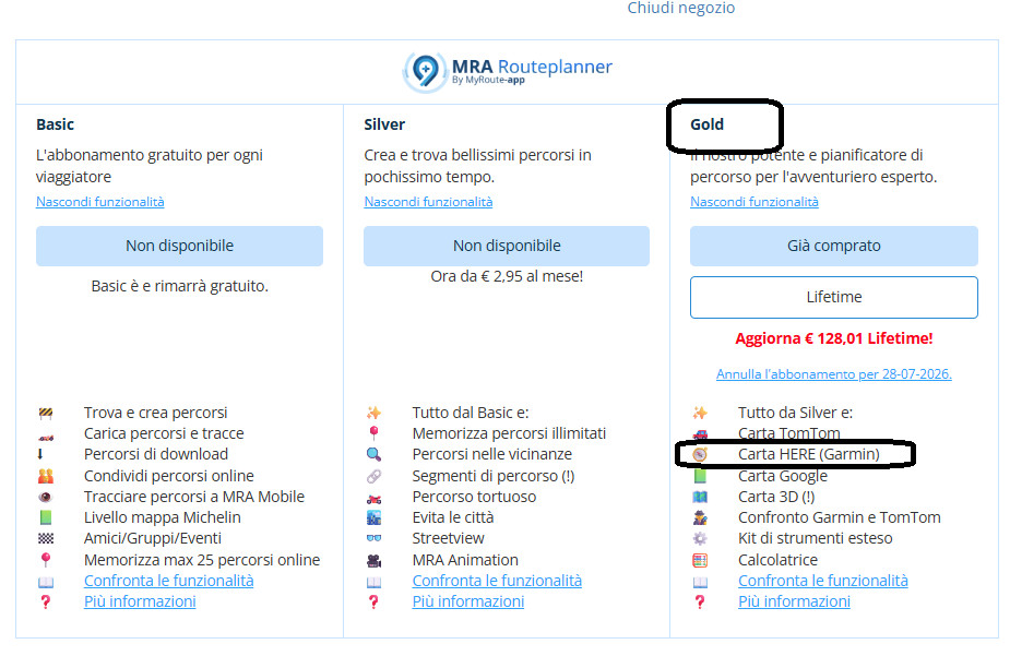

    Do you have the Silver membership? Of so, then i understand this situation even better. With the Silver membership you don't have the HERE map. This comes with the Gold membership.
    And why pay per month? You can also have a life-time membership. You only pay once and enjoy the rest of your life of MRA!
    You get the Gold membership that comes with all the options and features of the Silver membership shipped with a lot of extra options and features!

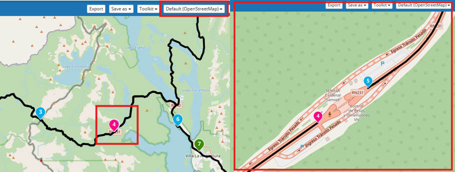

      I actually tried it myself, just like Nomko said, and it works. With the OpenStreetMap map, even though you can see the road, it makes you take a huge detour, while with the Here map it follows the route you’d expect.

          Anyway, even if the planning shows that detour, once you reach point 4 you just continue on the road, and when you get to point 5 you’ll carry on toward point 6 without any effect on the rest of the route.

                I pay for the silver membership (2,95€/month).
                Until now, I've been able to do that route without any problems. I don't understand why it won't let me now.
                Do you know if they've changed something in the subscription that's why it doesn't include that now?
                Thank you very much!

                  I’m not sure if they’ve changed it, but as far as I can see, with the Silver plan you can’t use the Here map — only with the Gold plan or with the MRA Navigation app.

                    @Nomko-Nomden not completely true. With a silver abo you for have the Here map but you can't compaire the route with TT and OSM

                      Not correct. A Silver subscription only gives you access to the planning map from OpenStreetMap.

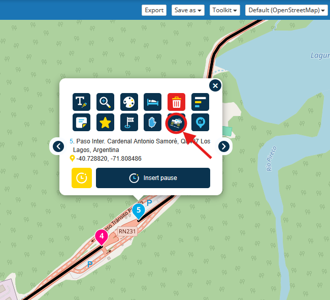

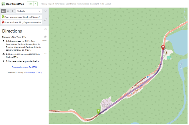

                        Hi @DAVID-PUEYO-TORRES I don't think it is anything to do with subscriptions
                        To me the problem appears to be with the MRA version of the OpenStreetMap map data
                        On MRA using OpenStreetMap to calculate the route the path refuses to pass through the border post
                        On the OpenStreetMap website the routing passes through the border post with no problem
                        The normal way of getting around routing issues like this is to use the "offroad / skip" function,
                        it is very often used to enable routes over rivers / ferry crossings
                        add two points (4 & 5 ) similar to what I have shown either side of the border crossing
                        then click point 5 & select the "offroad / skip" icon to route straight between 4&5
                        MRA has their own version of the OpenStreetMap data & it is not always the same as that on the OSM site
                        Its possible that the MRA version is out of date or that the snapshot that MRA took had some bad edits for the border post

                          Yes, please don't blame any licensing changes, since there are none. Like @Brian-McG explained, there is likely a difference in versions of the OSM map between the one MRA uses, and OSM has online.
                          @Nick-Carthew said in Problem Routeplanner between 2 points:
                          With the exception of having a Navigation License too.
