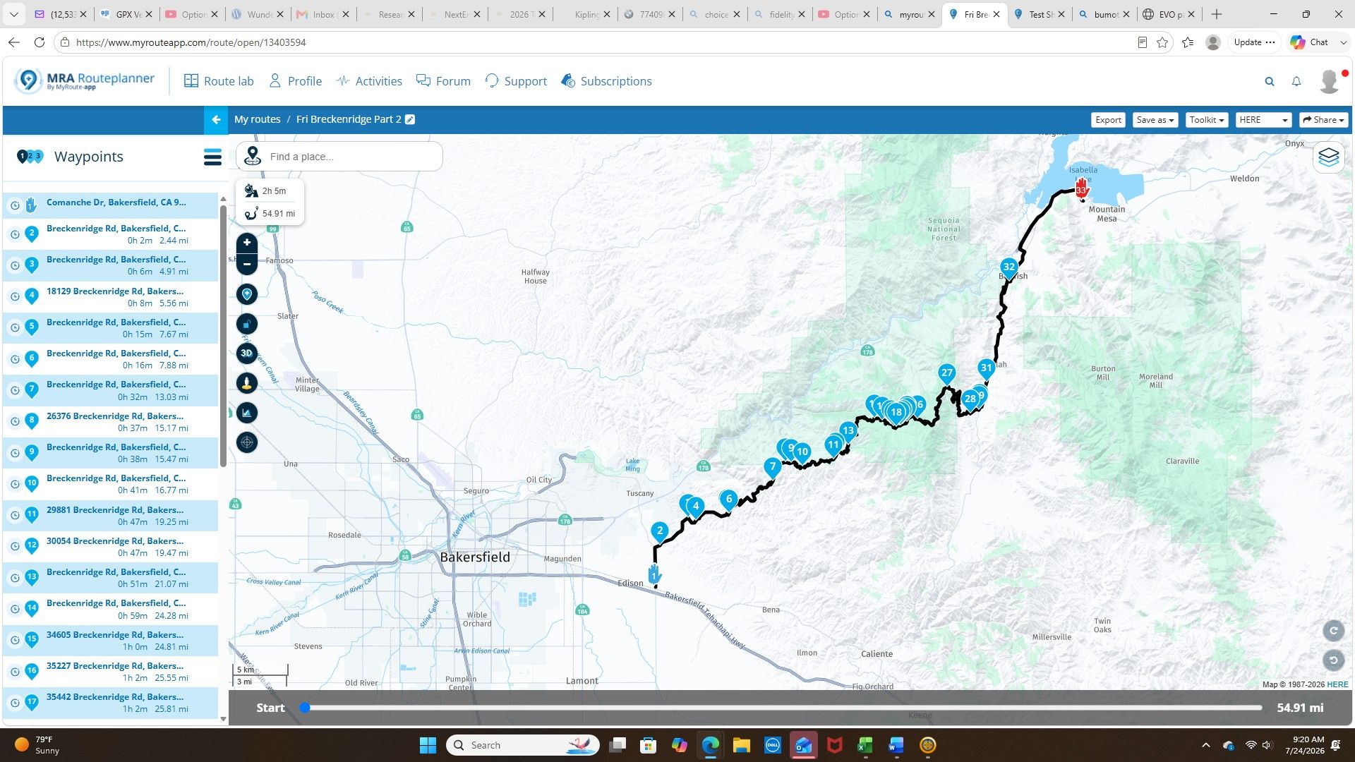

                    @Steve-Jarrell I finally got around to playing with 1.2, and I'm impressed. Here is a screenshot of one of the most troublesome routes I've recently created, and it passed my 1.2 test perfectly:
                    It's a single very rural road that partially crosses the southernmost Sierra Nevada. It's a challenging road to route because it requires precisely positioned shaping points (using 1.1) to Import into a Garmin. I probably have more overall shaping points than needed, but 2 WPs in particular (23&24), as they are exactly placed, are absolutely necessary. It's a unique jog on the road that messes up recalculation on my Zumo otherwise.
                    Initially, it took a lot of iterative back-and-forth between MRA and my Zumo to finally solve the puzzle. I literally spend hours playing with different shaping point scenarios before solving the mystery. Now with 1.2, I can delete WPs 23&24 and the route recalculates on the Zumo correctly. I'm finally going to able to achieve "what you see on MRA is what you get in the Zomo".
                    1.2 is definitely going to make life easier for trickier situations like this.

                      @John-S-Parry Yep, the concept behind 1.2 is brilliant.... include the track inside of the route information so that the Garmin has no choice but to follow it. I used to have to also include a LOT of shaping points to make my Garmin calculate its route match MRA's route, but no more!
                      Thanks for the information!!
