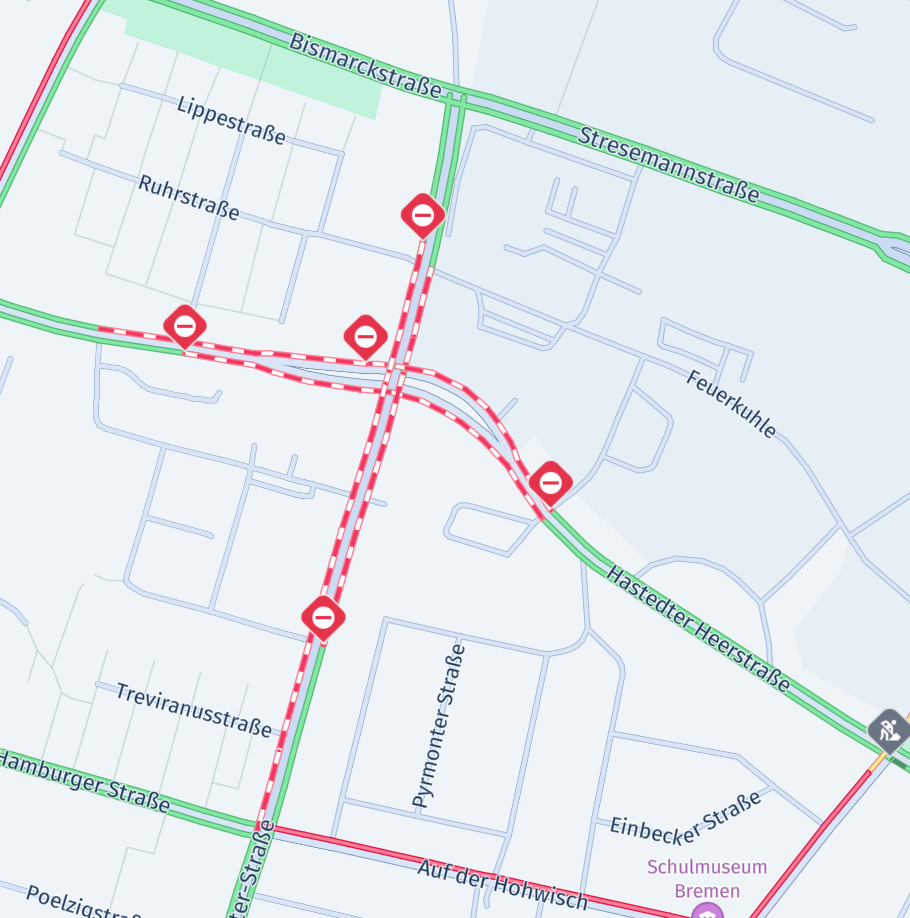

    For me, seasonal closures meant things like closed mountain passes in the Alps or roads closed in winter.
    Now I noticed this difference on a route with roadworks.
    I was pleased to see that Here® plans around the roadworks.
    Then I deactivated seasonal closures.
    And now Here® plans the route through the roadworks.
    It's good to know that this is possible. And I can live with it, but it's a setting that changes something significantly without the user being aware of it!
    But what are seasonal closures really?
    This is how it looks on HereWeGo®:

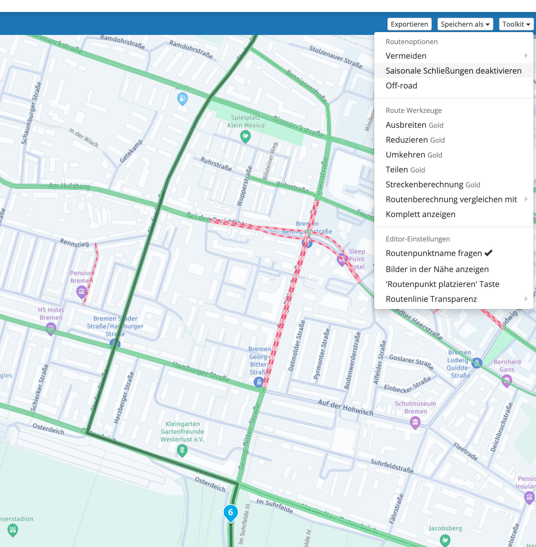

    Route Planning With seasonal closures activated:

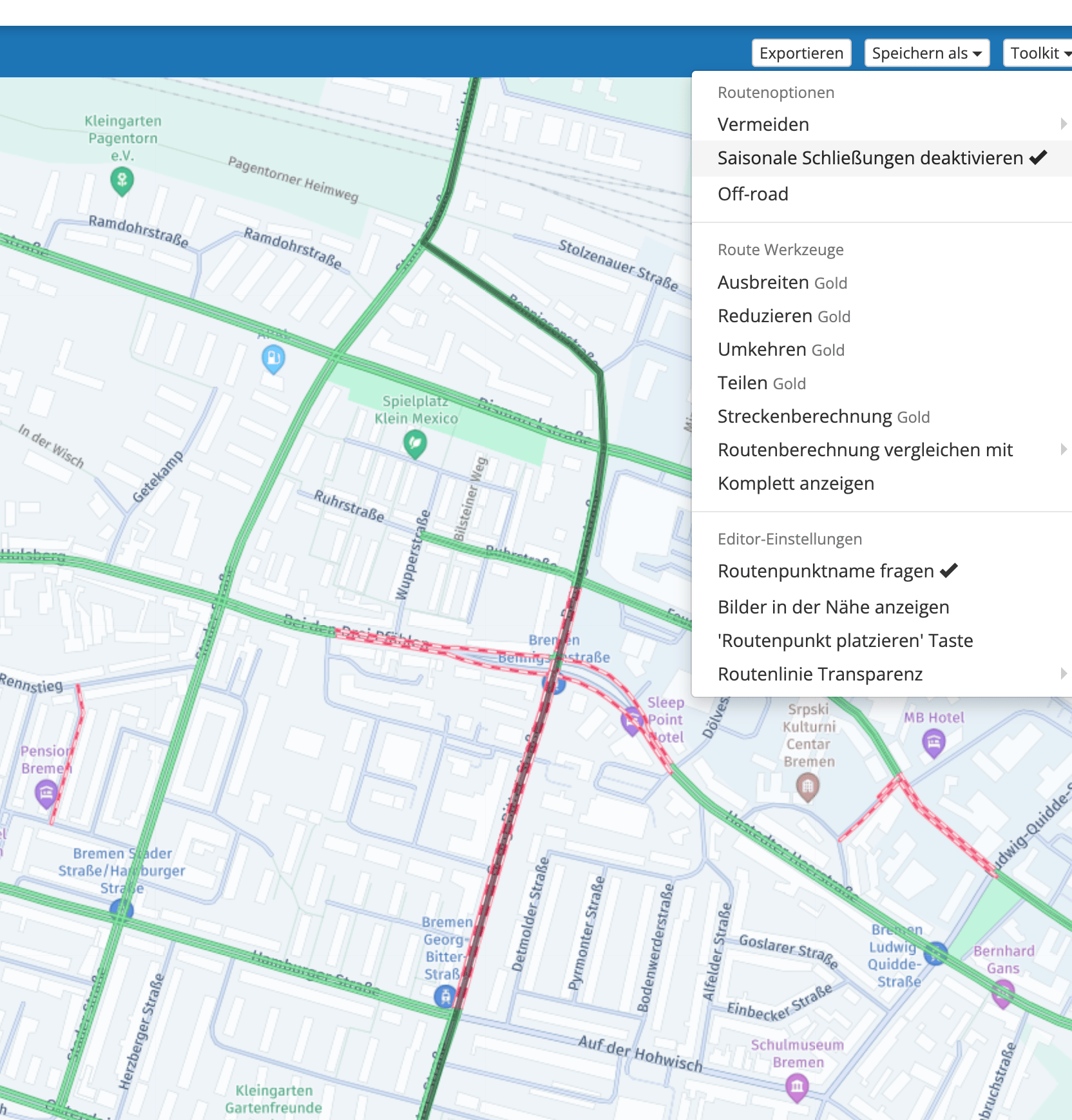

    With seasonal closures deactivated:

      The pictures you show look more like traffic restrictions due to road works

          @Rainer-Treichel I would say no it is not a wrong classification by Here,
          rather the "Disable Seasonal Closures" ignores all closed roads

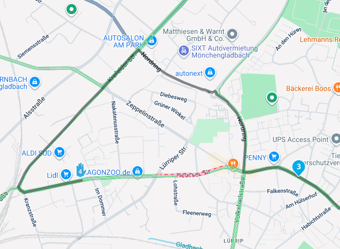

              Hi, I tried your problem with a closed road in Mönchengladbach and see the same issue.
              If “sessional closure” is active you will be guided around the closed street, if deactivated you drive through the closed street.
              This looks like a bug in the Here map that needs to be noticed to HERE from MRA.
              Active
              Deactivated

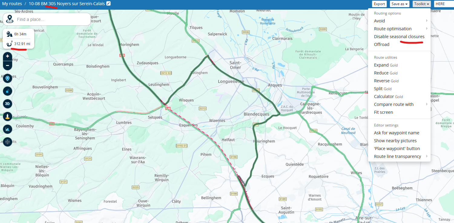

                      @Con-Hennekens I find the way the "Disable Seasonal Closures" works now quite useful
                      If I am planning a trip several months ahead I do not need my route calculation to take account of every current road closure
                      Many of these closures will have been removed by the time I come to ride the route
                      The "Disable Seasonal Closures" allows me to ignore these closures & plan the route I will most likely ride in several weeks
                      An example - I am heading to france & spain in a few weeks & on the return journey, today the A26 near St Omer has road closures
                      Using the "Disable Seanoal Closures" allows me to plan the route more accuratley
                      If the "Disable Seasonal Closures" is modified to ignore road works then to me it would make sense to also add a switch to enable "Ignore Road Work Closures"
