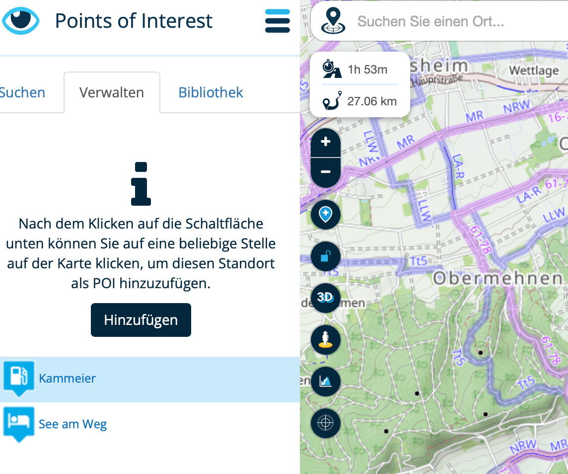

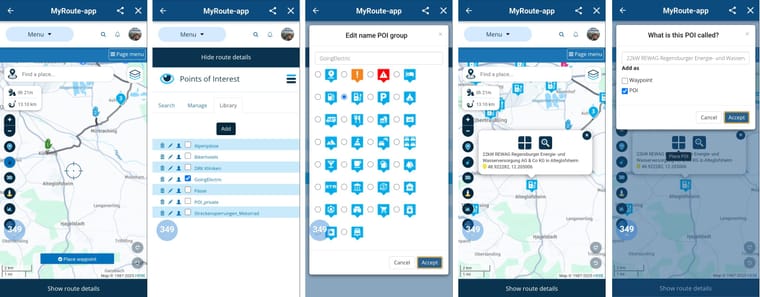

    • RainerT
      RainerT
      RainerT
      Enter GPS Coordinates into search field or get them from google maps or earth.
      Set a point in the map.
      Goto the second tab in POI
      Start POI Generation an point klick on the point in your map

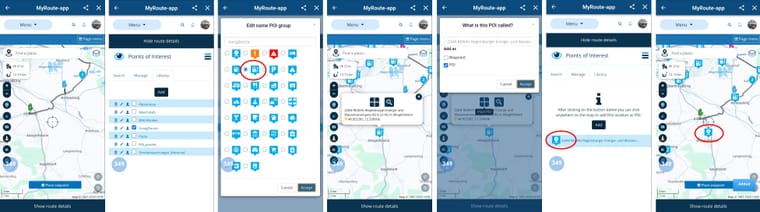

            Hi @Brett-Bartick POI's are a fairly limited in MRA so to answer your questions
            1. you can find the location by entering the GPS coordinates into the search bar, this will attempt to create a waypoint at this location which is not what you are after, so you have to cancel or delete the waypoint & as @Rainer-Treichel suggests go to the POI Manage tab & add the POI manually
            2. I do not believe so, the icon is decided on creation
            3. No there is no "Move" function associated with POI like there is with waypoints

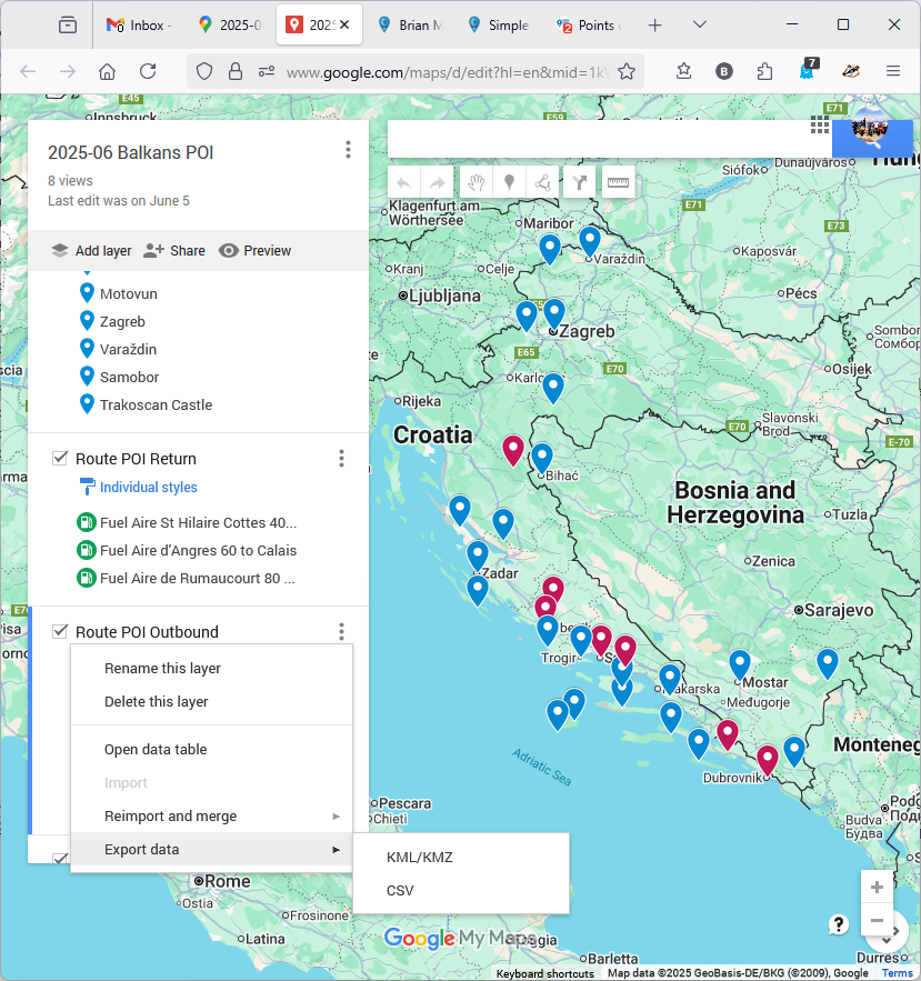

            IMO if you want to create a library of POI's you are better doing this in Google My Maps
            You can then export your list of POI's as a CSV & import that into the MRA POI Library tab
            In Google My Maps you could have a layer for Hotels, a layer for mountain passes, a layer for restraunts etc
            Each layer can be exported as a CSV & imported into MRA & each layer then is a collection of points in your MRA library.
            You can choose/change/edit the icon on each MRA collection/set of points
            It is not ideal as you have the usual issue with MRA not displaying POI till zoomed in
            With the Library & Managed POI the zoom level is 10km
            Plus you have to manually keep updating / uploading your MRA library, I tend to update my MRA library points about once a year

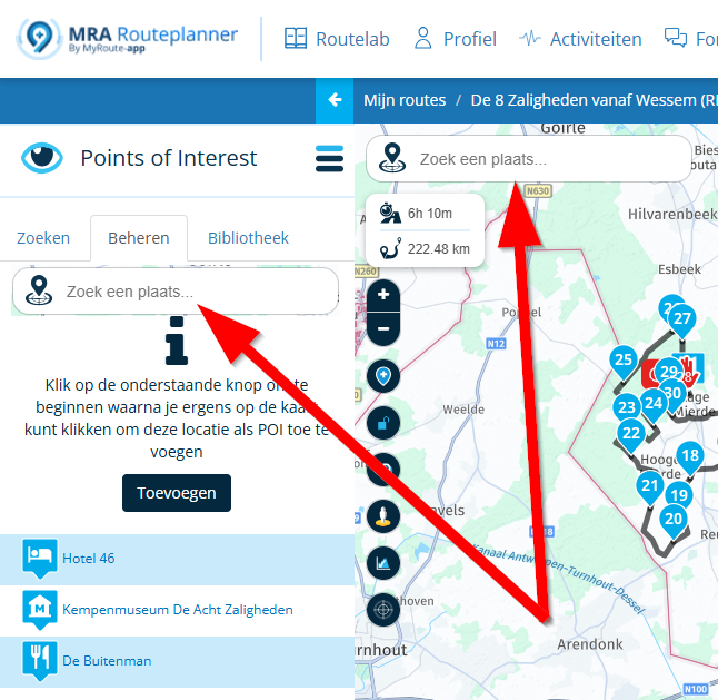

              @Brett-Bartick said in Points of Interest (POI) Questions:
              I'm not understanding what you are saying. Are you saying to
              1. Use GPS . . . .
              Well, It's quite simple.
              • Go to the menu item "Points Of Interest"
              • select the second tab (in Dutch this is "beheren", I don't know the English term, it might be "Manage")
              • just do what it says in the description and click on "toevoegen". I think it says "Add" in English.
              • Now click on the map at the location of the POI, give it a name and a symbol and the POI is shown on the map.
              Het is redelijk simpel.
              • ga naar de menu optie "points of interest"
              • kies voor de tweede tab (in het Nederlands is dit "beheren", ik weet de Engelse term niet, mogelijk "manage")
              • doe gewoon wat er dan in de beschrijving staat en klik op "toevoegen". Ik denk dat hier in het Engels "Add" zal staan.
              • Klik nu op de kaart op de positie voor de POI, geeft deze vervolgens een naam en symbool en je hebt de POI zichtbaar op de kaart

                  @white.mouse I understand everything you wrote and currently do that. BUT, I would think that having the ability add a POI with GPS coordinates makes sense since I can do exactly that with a "waypoint".
                    Well a work around is to make a via point with the prefered coordinates and then make a POI on the spot of this via point.

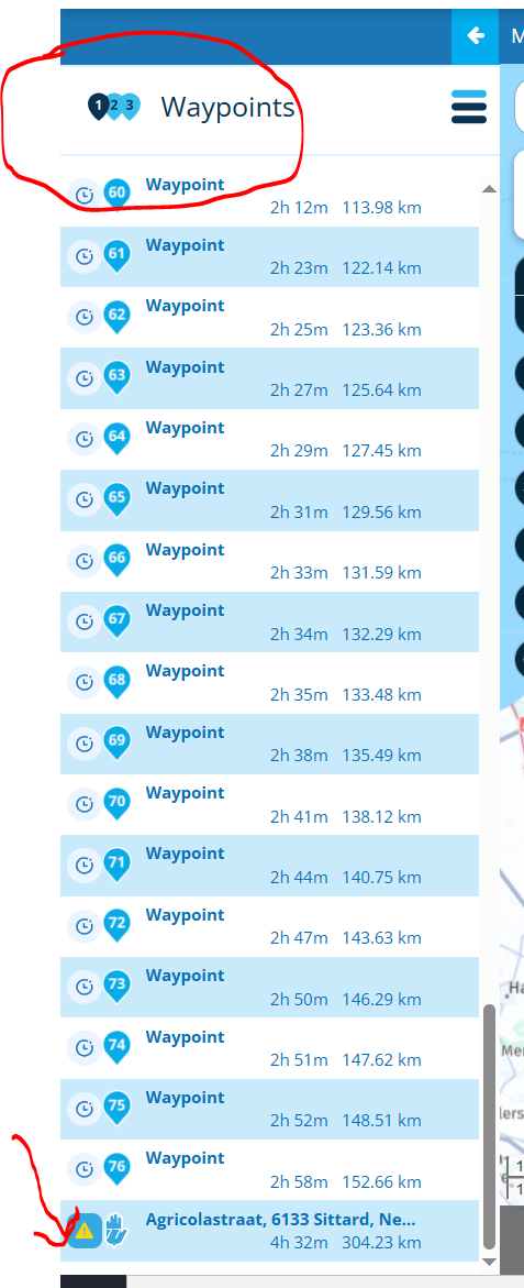

                      @white.mouse I'm not sure what you mean by the term "via point". If you mean "waypoint", I already mentioned in post #3, even though I want to add a "POI" and clicked on the "add" button in the "managed" tab, when I "click" on top if the "waypoint", I can't add the POI point, since the waypoint options are displayed.
                      Here are a couple of other POI issues I noticed.
                      1. If a route is locked, I can't add a waypoint. If I try, the program displays a message "Waypoints are currently locked".
                        But, if I try to add a POI via the "Library" tab, I do NOT get a message that the route is locked, and the POI just doesn't get added to the POI list under the "Manage" tab. Actually, I get a message on the screen that says "Added". That seems illogical to me. Why wouldn't the program display a message that the route is locked? Instead, the program just ignores my request. This seems like a programming bug to me.
                      But, if I add a POI via the "Manage" tab, it works. This seems inconsistent to me.
                      1. When I add a POI (Manage) to my route from the routes POI Library, why doesn't the added POI have the same icon as the POI from the library? The POI seems to be added under the POI (Manage) with a default icon???

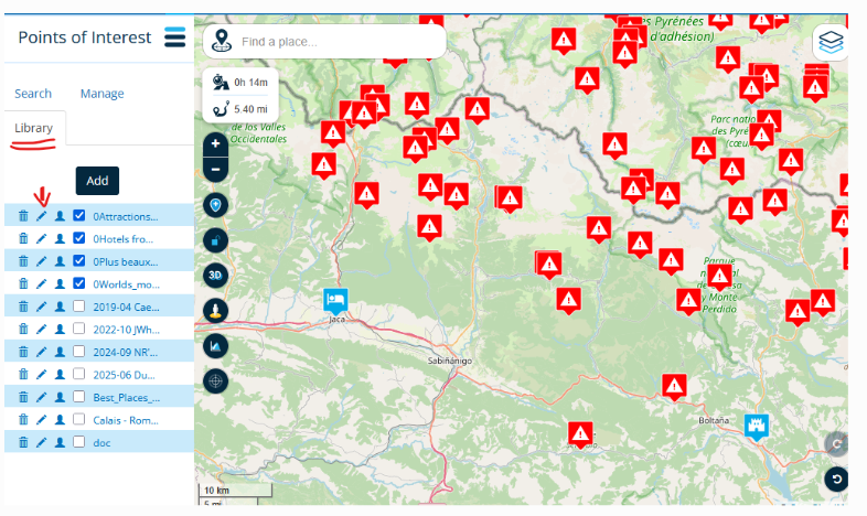

                          That's logic, because locking a route prevents it for (accidental) changes. Means: routepoints (waypoints) are fix. No change/move nor add nor delete.
                          But a POI can be added, without becoming a routepoint. Those will only be populated / made visible on the map; no routing/navigation to it. If you save the route as gpx file and import to Garmin, it will also not be included into the route as routepoint, but visible on the screen.
                          not inconsistent, as explained above.
                          You are mixing up something:
                          • if you add a POI via the POI list of MRA (serch tab), the added POI in map will have the same icon as this group in list
                          • if you add an own POI manually (manage tab), you need to tap on map, where you want to place the POI and you will be asked in the pop up window for a name for it and an icon you want for it
                          • if you ad a POI from an own imported list of POIs (library tab), the added POI in map will have the same icon as you have selected for this group during upload.
                            There is a possibility to modify the icon for a group in library tab.
                          Brett Bartick 1 Reply Last reply

                              • in POI menue, tab "Library", I have selected a POI group, which I have importet before
                              • the icon for this group has been modified to an most applicable one
                              • I searched one of this POIs close to my route and started to add it (only as POI)
                              • on the screen, I have got the message it "has been added" - but the POI is not on the screen and the POI is not in POI menue, tab "Manage"
                                That's what to be expected, because route is locked! Only the message "has been added" is irritating and should be fixed.
                              1. Unlock the route and in the POI menu, under the "library" tab, click on a POI. Does it get added under the "Manage" tab with the same icon?
                              • route is unlocked
                              • on the screen, I have got the message it has been added - and the POI is visible on the screen and the POI is listed in POI menue, tab "Manage"
                              • but it has a "default" icon - not that one, the group of this POIs has!
                                That isn't expected - that is the issue, because the expectation is: if the imported grou of POI has got a dedicated icon, selected/used icons in a route should have the same icon!
                              @Corjan-Meijerink please can you check and correct it?
