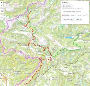

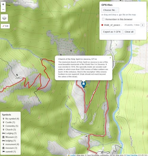

    With this little tool you can load your GPX file into a leaflet map and do the following:
    • Add symbols to your POI;
    • Add Notes to your POI
    • Move the POI, or add/delete one.
    • Geocode (get the address) with Openstreetmap Nominatum.
    • Merge tracks/POI files
    • Export it to an GPX file.
    • use different maps
    • Store your data in the browser cache.
    The tool is not storing your data on the internet, everything is handled inside the browser, also no API keys or other restrictions are used.

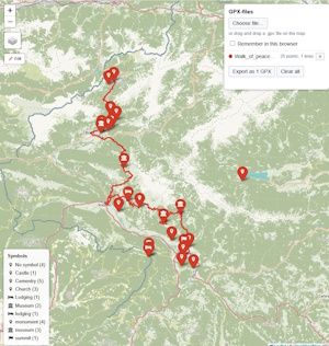

      some screenshots:
      loaded track
      Loaded GPX file

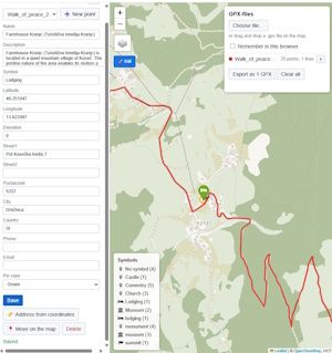

      POI without address data
      with address from openstreetmap
      POI with data

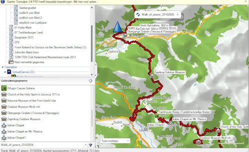

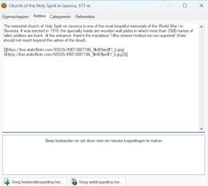

      imported in Garmin with symbols
      notes in Garmin POI
