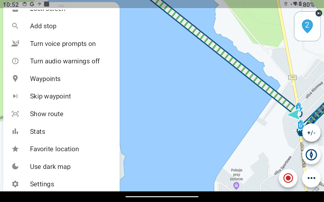

    Hello,
    I noticed that some (not all) menus are cut off so selecting an item on the bottom is not possible:

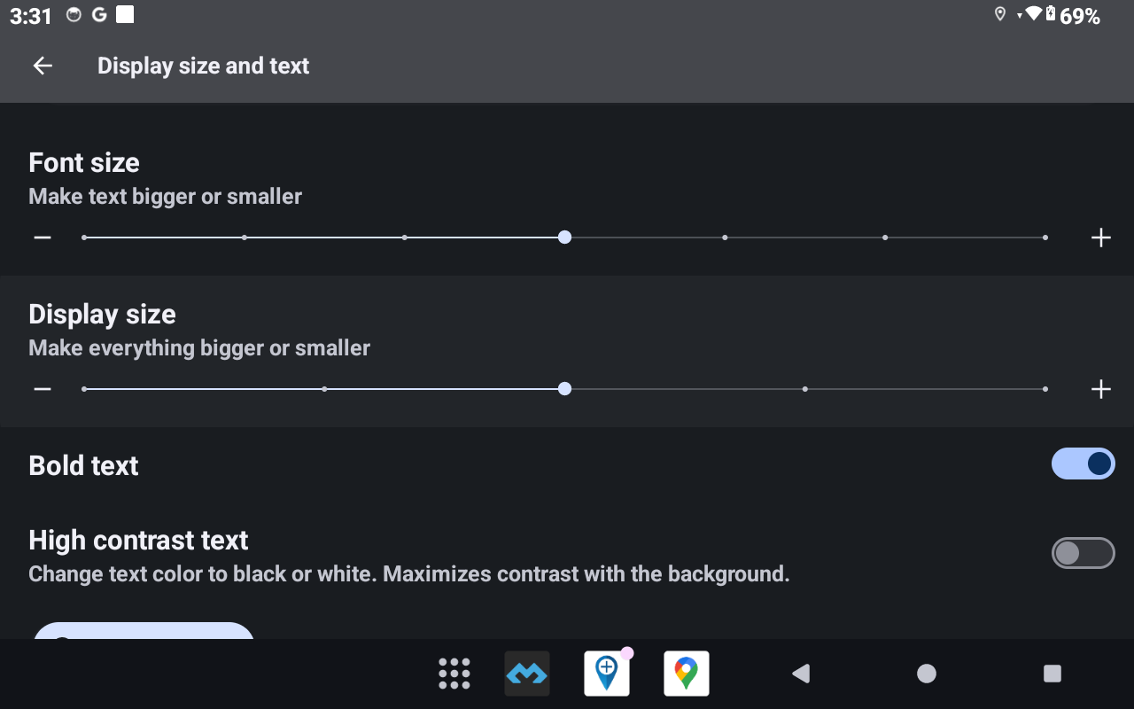

    This is a DMD T865X tablet, 1280x800, 210dpi.
    Display settings set as followed:
    App version 4.4.0

      Isn't that list scrollable...?

        Yes,
        but it never fully shows the last item(s)

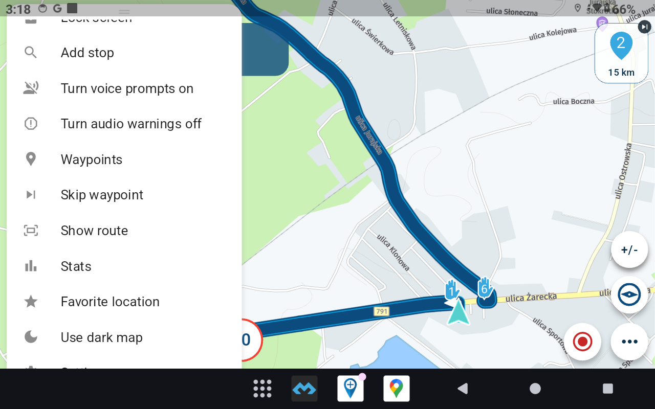

          @Rafał-Kukla Can you hide the menu bar?

            @Nick-Carthew
            What menu bar?
            If you mean the Android nav bar, then yes: switching from 3-button to gesture navigation helps:
            but this isn't a solution. I'm not going to use gestures while riding...

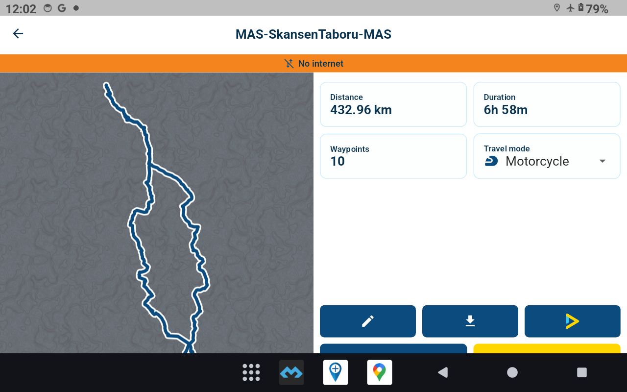

            BTW. "full screen" settings (Navigation Settings->Screen layout) is a workaround...
            however after exiting navigation track selection looks like this:

              @Rafał-Kukla Hi Rafal. I use the same tablet and have the same experiance. Trying to start your trip can be a Challenge Sometimes because the navigate button is mostly covered by the menu bar at the bottem. I could start the routes last week but having big hands like mine…….. using the full screen mode can be a solution but to my findings the result is even worse because you have to shut dien MRA to get something else started, like spotify. Shutting down the device completely solves the problem for a while, I guess it has something to do with the cache.
