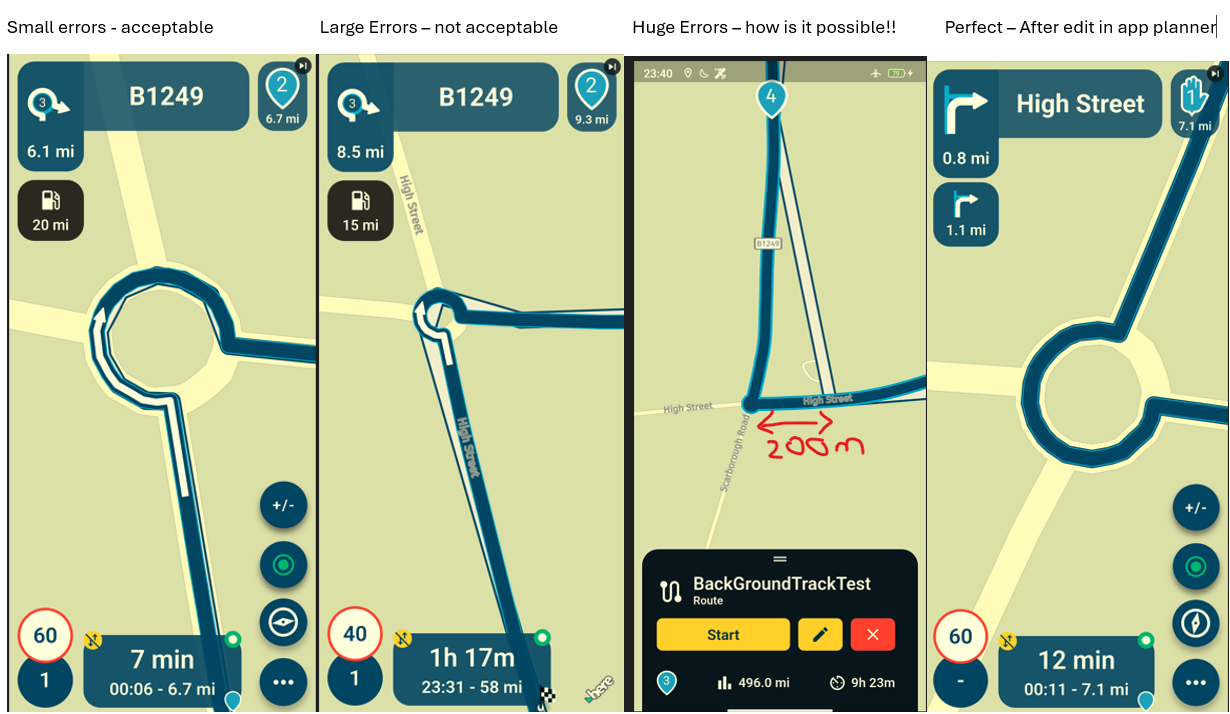

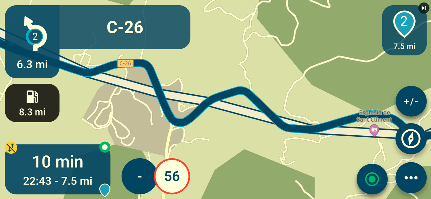

    When I load some routes for navigation the display of the "original route" beneath the planned navigation route does not conform closely to the road, it appears to straight line between some unidentifiable points
    On other routes it fits very close to the road & can only be seen to deviate a small bit when the navigation app is zoomed in to its maximum setting
    All the routes are planned with MRA on the PC & then navigated offline with MRA Navigation.
    Some routes may then be edited in the app
    Could someone please explain why with some of my routes the display of the "original route" differs?
    & while on the subject of the "original route" could the colour be changed from white to a much more contrasting colour?
    on a bright sunny day with a washed out garmin map style selected the white "original route" is virtually impossible to see
    (yes I know there are other map styles but occasionally for whatever reason my style reverts to the washed out bland garmin default colouring"
    • Brian McG Offline
      Brian McG Offline

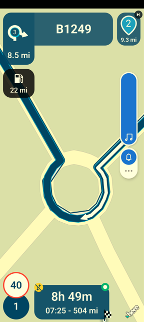

      sometimes the offset from the road for the "original route" (track) can be large
      when this happens & zoomed in at a junction the "original route" (track) can sometimes overlay the entire junction so the exit roads from the junction are hidden/obscured by the overlay
      This imo is borderline dangerous as instead of concentrating on the dangers of navigating the junction I am busy trying to guess which exit road from the junction the navigation system is telling me I need to take

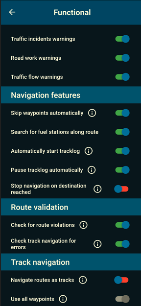

            @Brian-McG, I see you are using offline-mode. I suspect you have "Navigate Routes as Tracks" enabled. Tracks work best in online mode, because tracks van only be calculated online. If offline, you get a less optimal track. If offline use is a must for you, you would better disable "Route as Track".
            Brian McG Marinus van Deudekom 3 Replies Last reply
              Brian McG Offline
              Brian McG Offline
              @Con-Hennekens nope, not navigating tracks & option is always disabled
              I normally navigates routes as you can see from previous post picture - blue line with multiple waypoints
              The option to display the "original route" (track) is a great idea/feature, it just needs to work better (& be more visible/greater contrast on the garmin washed out style!)
              others seem to be seeing a similar issue so there has to be a cause/reason

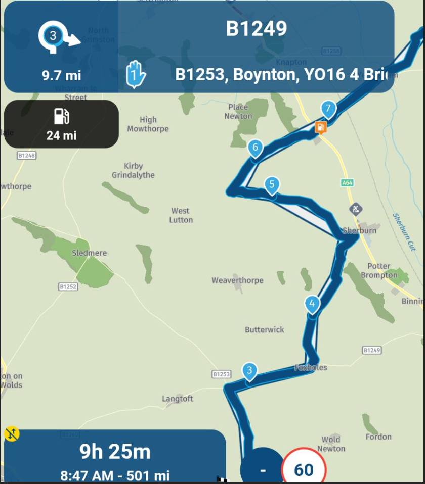

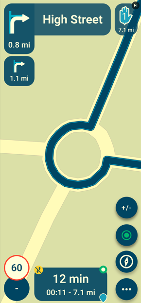

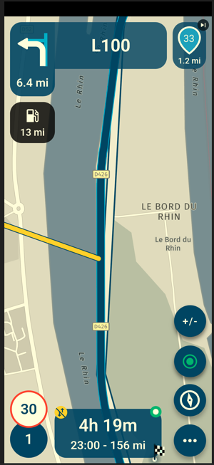

                If I edit a route in the web planner or via the app website route lab link - when I try to navigate this route offline the "original route" (track) displayed in the navigation will as you say not be ""optimal"
                In fact they can be far from it. In the second picture the right turn at the roundabout with the track disappearing off a couple of hundred metres before is the same roundabout shown in my first post which shows very small calculation errors, in this example the track error is huge.
                What I have found is that if I take a route that has been created on the web planner & then edit it within the app route planner I get a different & what appears to be optimal "original route" (track)
                Yes this is the same round about as in the above posts but with the "original route" (track) completley hidden because it is perfectly matched to the route/road

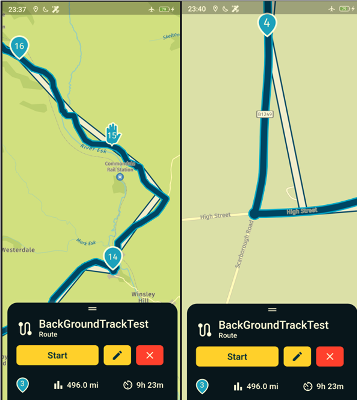

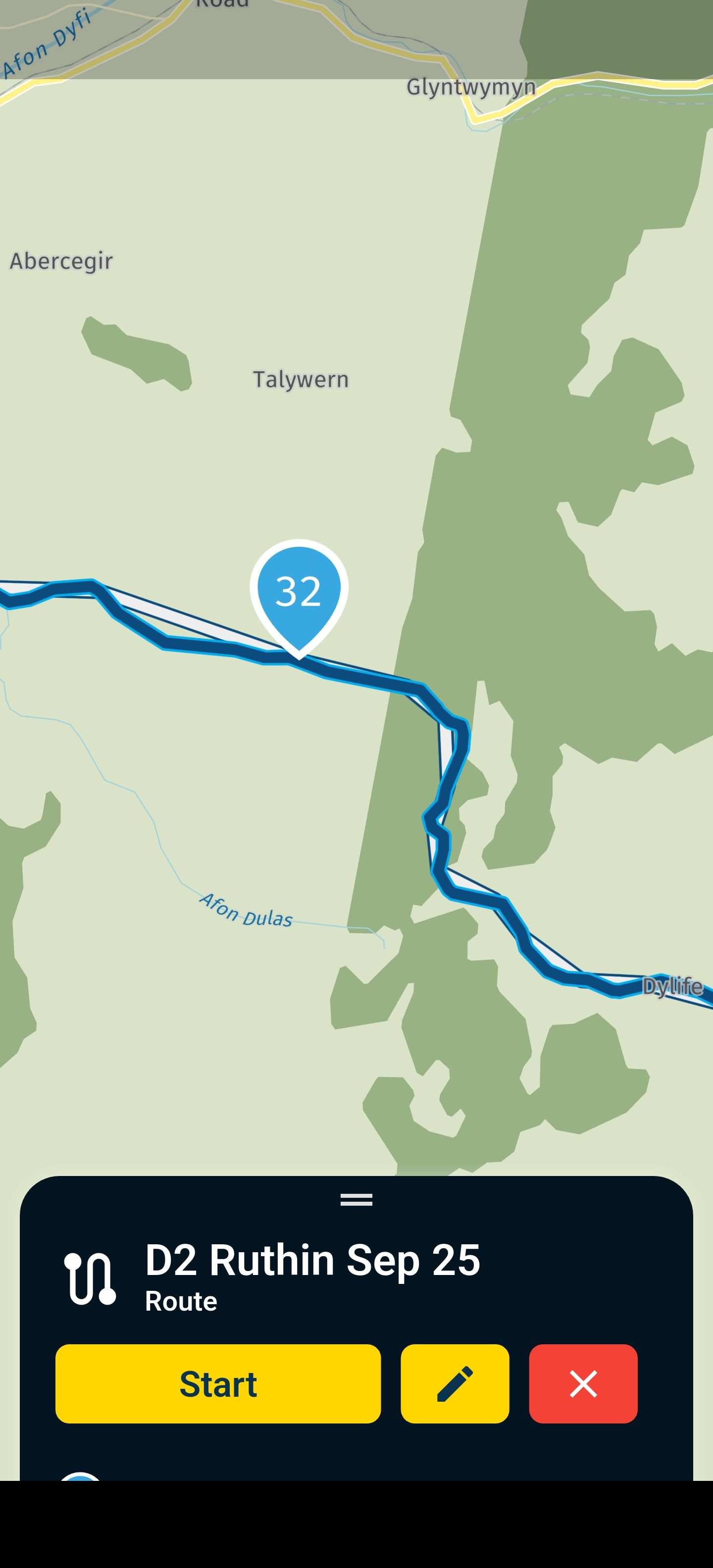

                                Sometimes the errors with the "original track" can be huge,
                                with the above route the "original route" is wrong by hundreds & hundreds of metres
                                what causes the wrong calculation of the "original route" in offline mode?

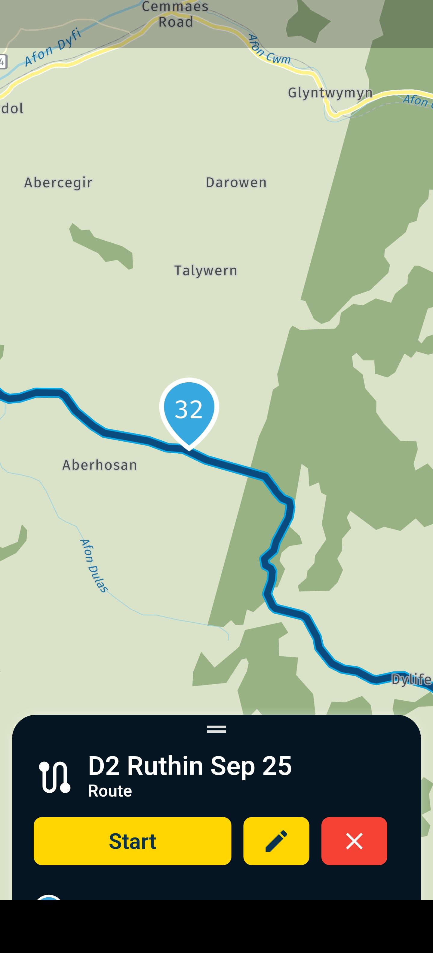

                                I have also noticed that with a route created in the web planner,
                                if the navigation is started with a network connection, the "original route" will fit perfectly to the road
                                the same as when the route is edited in the app planner, you get a perfect fit
                                I only seem to get the bad fit of the "original route" when I start the navigation in offline mode

                                          @Nick-Carthew yes the problem only appears if you try to start to try navigating with the device offline i.e. with no internet, no wifi connection
                                          the route must be last edited in the web planner
                                          if you open/edit on the device with an internet/wifi/online connection, it will recalculate the "original route" & you won't see the problem
                                          as far as I am concerned this is a definitive hard reproducible bug
                                          I can replicate it on 3 different devices with 2 different accounts
                                          now I know there are several work arounds, it is not so much of a big issue for me
                                          just a pain having to go through extra steps to get things to work
                                          but as this seems to be the norm for mra, things never quite work as expected ... hey ho
