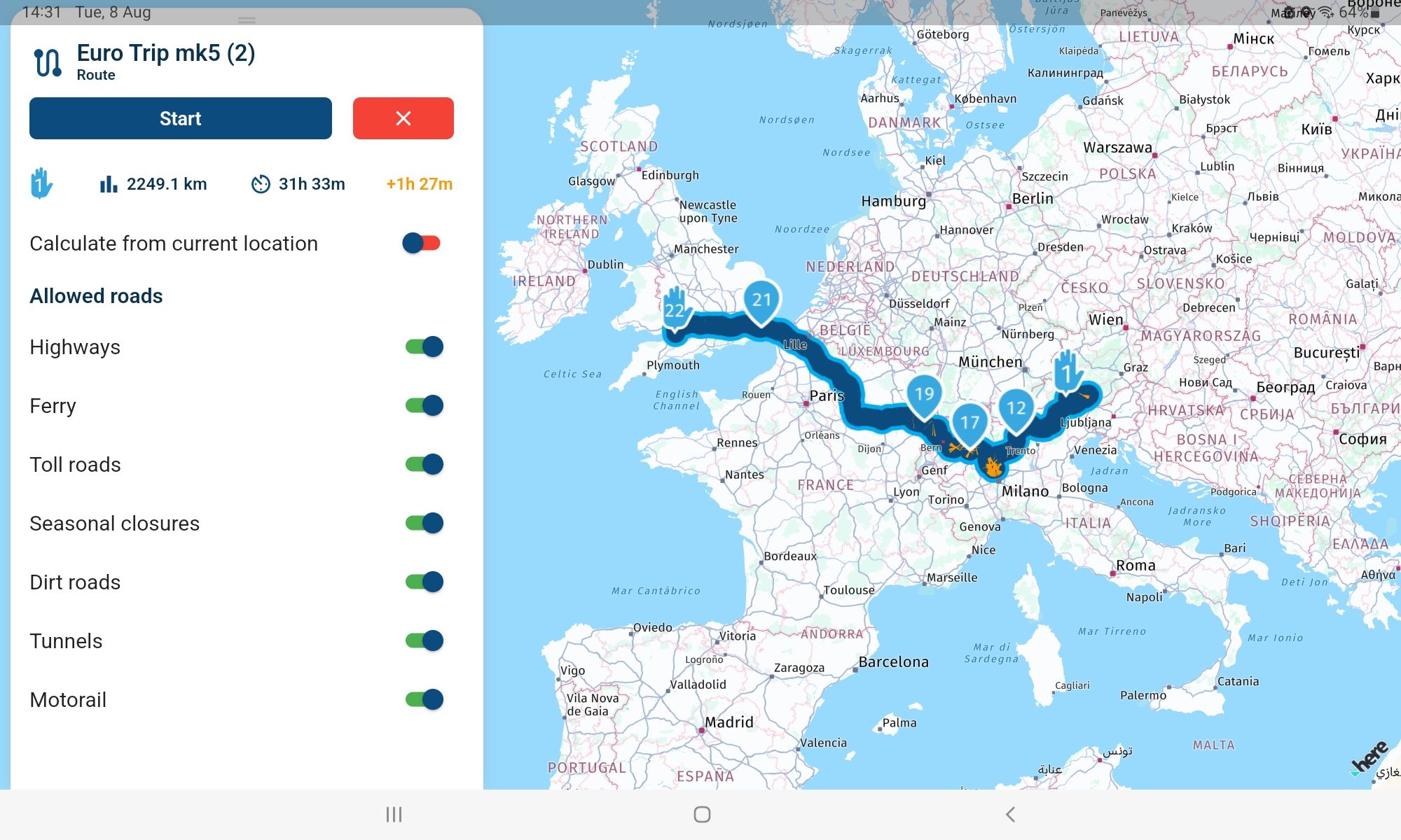

                                      • Tom Grzelinskiundefined Tom Grzelinski
                                        @Rob-Verhoeff
                                        Again, thanks Rob, I will look at multi-day trips.
                                        @Tom-Grzelinski I tried splitting your route in half and then half again. In each case the route loads but failed when attempting to navigate. I took a look at the last section of your route, the Waypoints are generally fine but it appears you may be dealing with closed roads. See below red sections. I had the traffic layer turned on.
                                          @Rob-Verhoeff
                                          @Tom-Grzelinski I did a little more testing. I'm not able to open the entire map but I split the map into two half's and I'm able to open each half. I'm also able to start navigation as long as I quickly turn off the option to navigate from current location (can't navigate from Canada 😊 ). So the end result is that I don't know why the app can't open the entire route ... other than it is simply too large. I had a similar problem when planning a 2 week trip. Once I was finished planning on the Web site I split into separate routes for each day. Good luck.
                                          Tom Grzelinskiundefined 1 Reply Last reply
