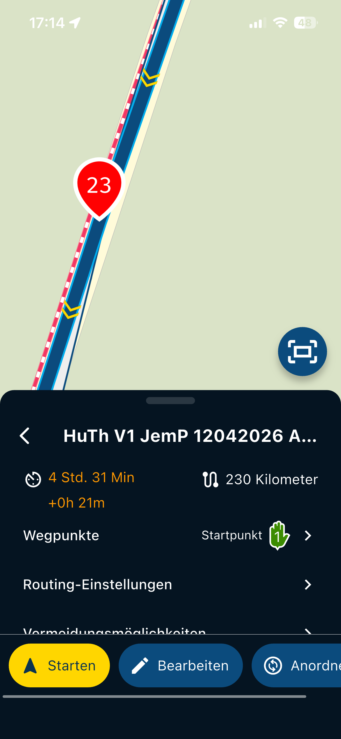

    Good Afternoon
    I have created a route last night to use today, all looks ok, used "Here" map like i always do. when i went to start the navigation it goes "crazy!! luckily i guided myself via the waypoints i put within the route.
    Please have a look and let me know if there is anything i can do from my side.

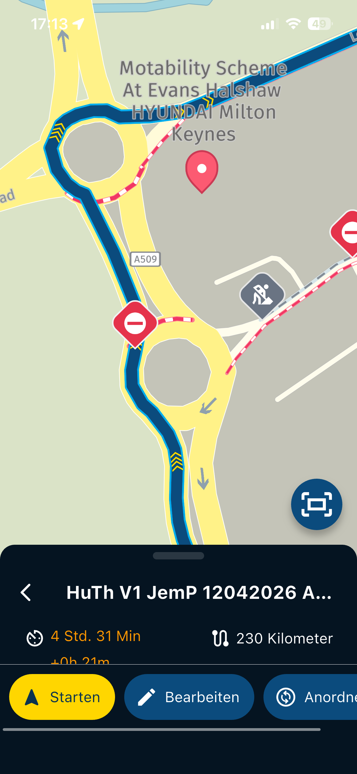

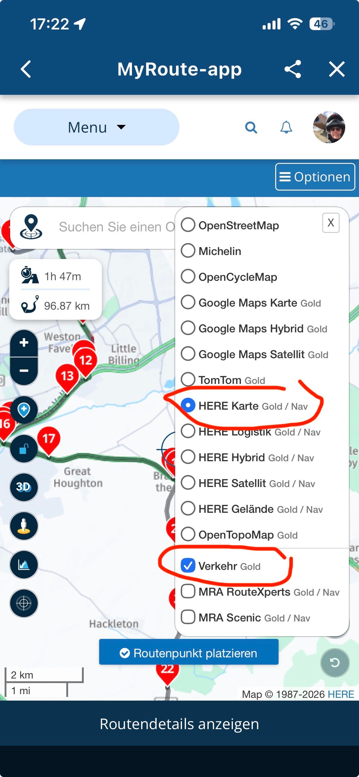

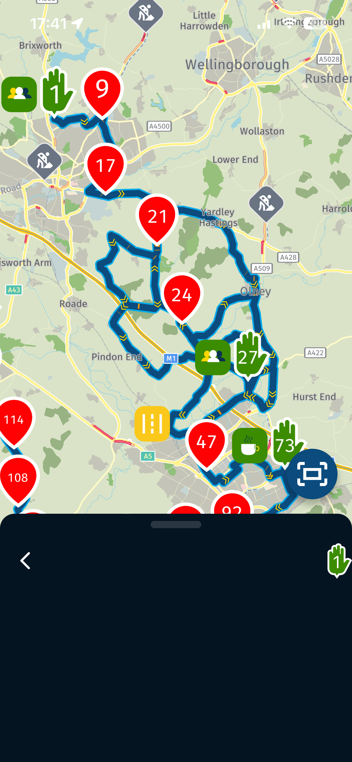

                  @ridetoportugal.com : The route has to cope with some construction sites ... these are real disturbances in the direction of travel ...
                    In the route lab on HERE map and traffic turn on then you can see it when you zoom closer ...IMG_9603.jpeg
                      Remove the rake so you can see something

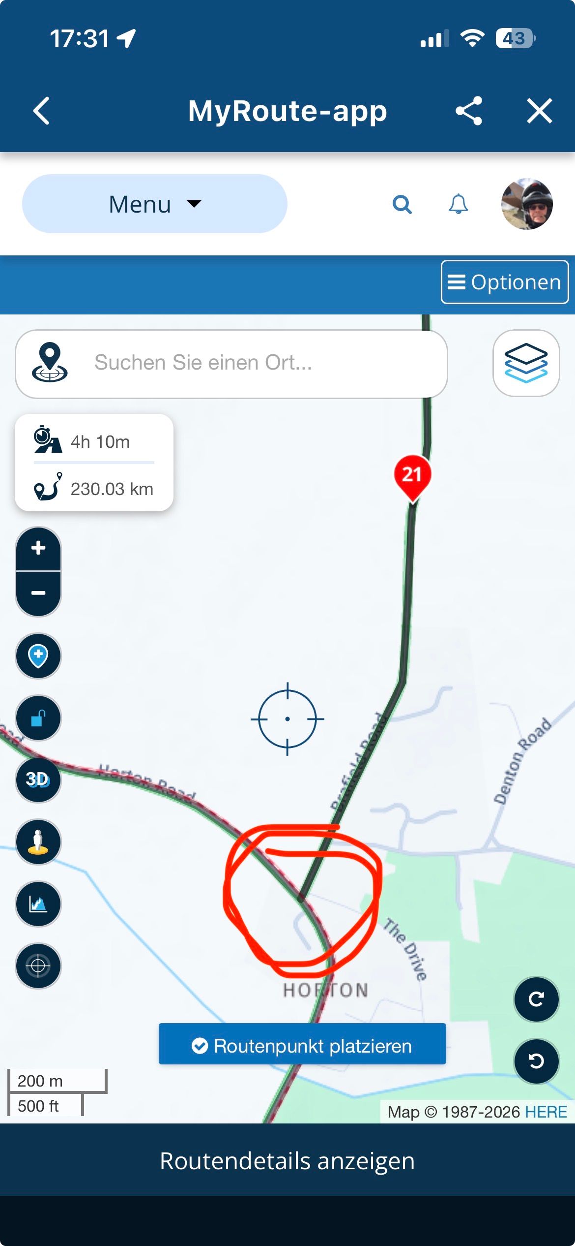

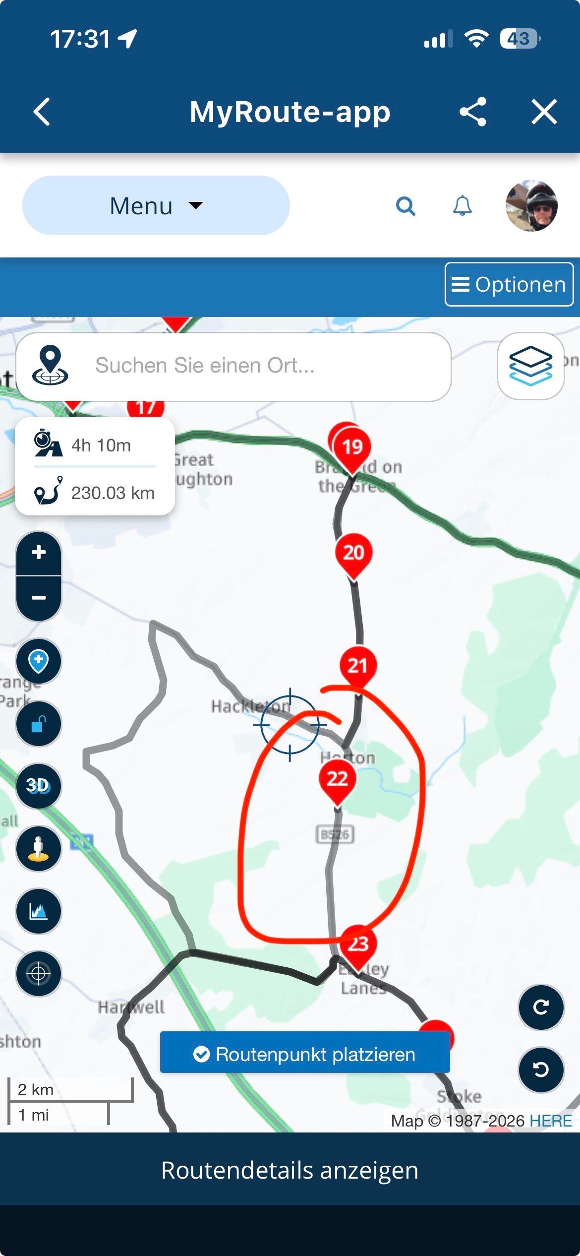

                        The road from WP 21 is causing problems in one direction or all? ..
                          I type approx. WP 21 to approx. WP 28 construction sites and direction of travel are only possible in the other direction, so the MRA tries to approach the WP from behind...

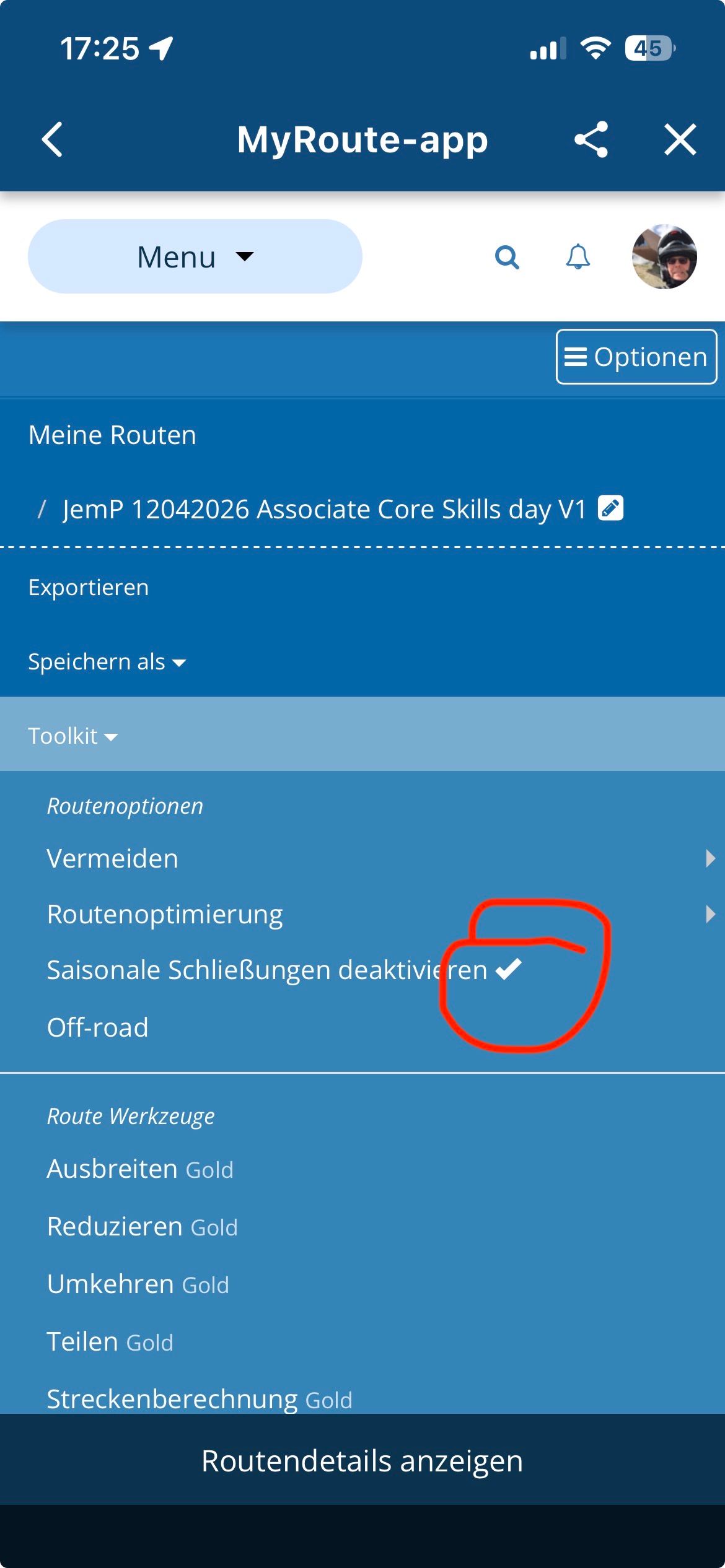

                            Thanks everyone, i know for a fact that there arent any road works, i have done it today again!!!
                            to bypass this, in "Route Planner" i have chosen, "OpenStreetMap" and uses as a track... its sorted!
                              Then, as so often, blocks are not unsubscribed in HERE, that will take another two days 😉

                                Good idea and solution to do this if you know the streets better than the HERE maps base specifies.
                                • Route algorithm "OSM"
                                • Navigate as "track"
