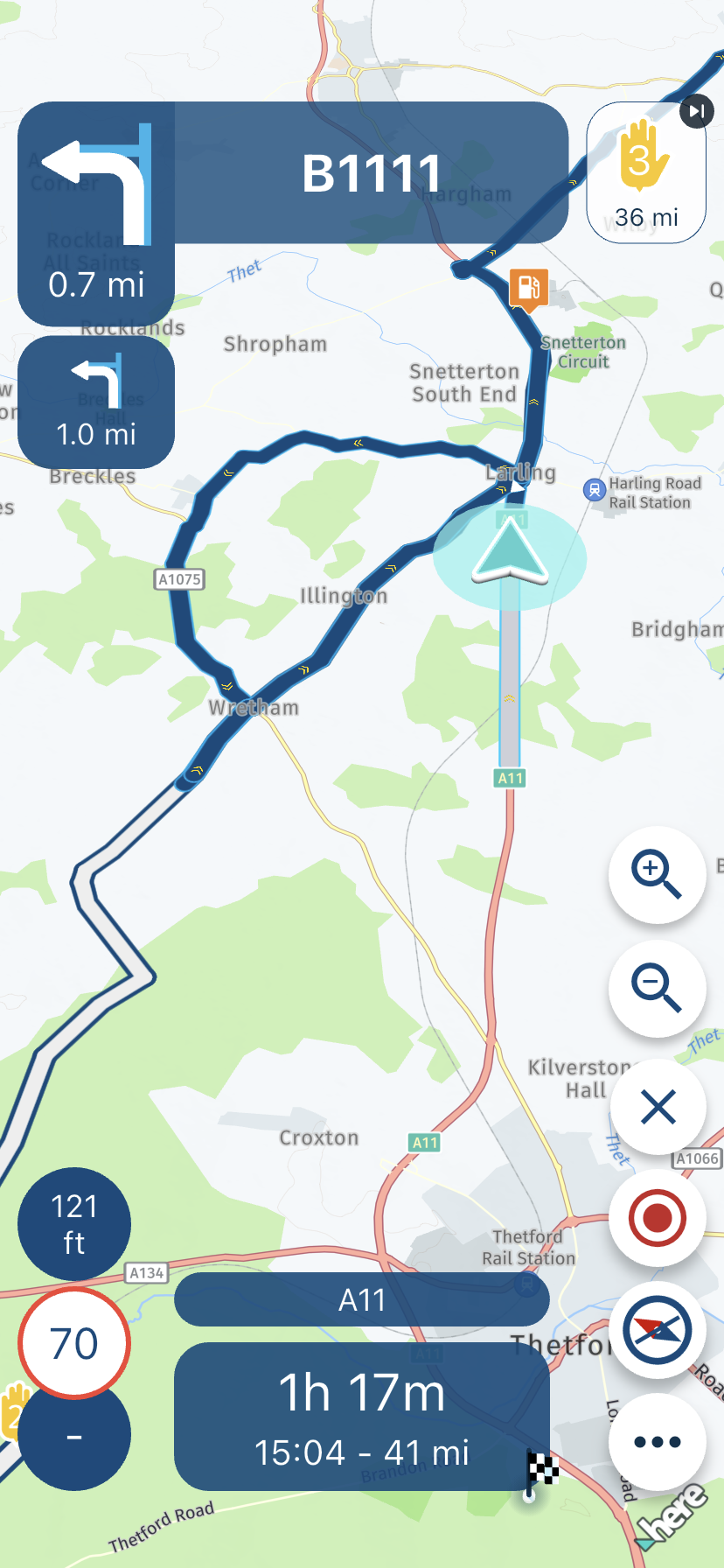

    ![alt text](![image url](IMG_0035.PNG image url)I uploaded a route with lots of way points - it looked fine on setting out but kept going on loop diversions. I had a similar problem on a short, simple route that would keep trying to send me on random loops and diversions - see attached screenshot. The original route was from the bottom of the screen on the A11, but it asked me to do a U-turn and then corrected, but wanted a loop from and back to the roundabout at the top of the screen.

      This is definitely because you are navigating the route as a track and it is trying to preserve as much as the track as possible.
      Is this ideal? No! We are going to improve this in the update after 5.1
