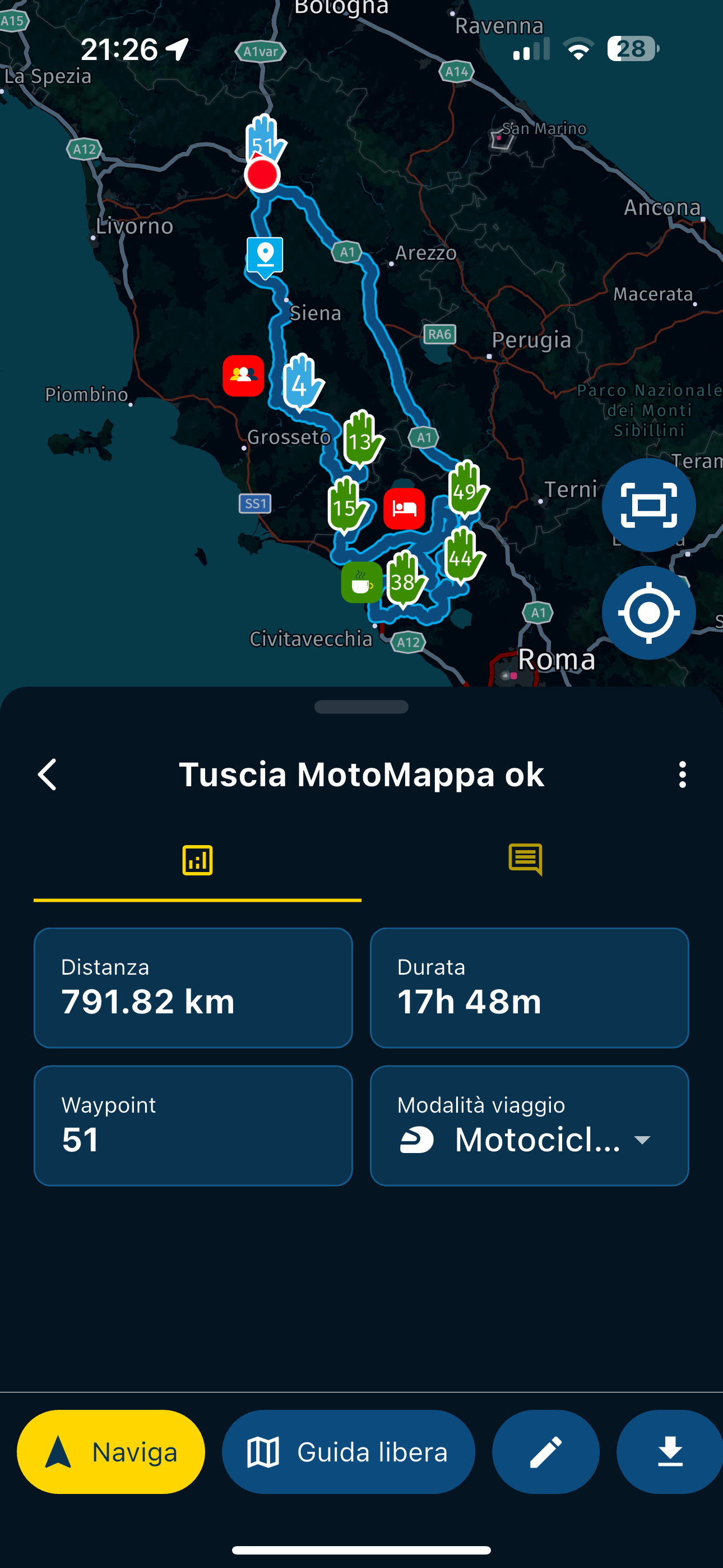

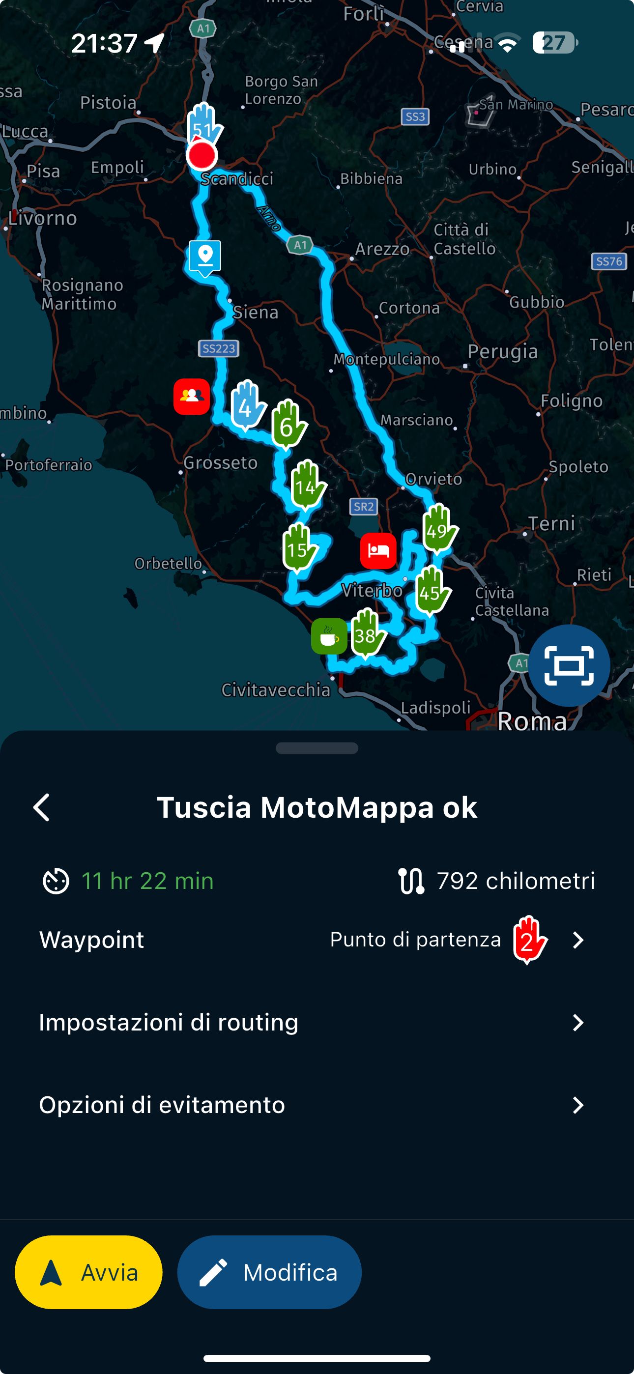

    I convinced a friend to buy Myroute App, the planning and navigation package, today we went on a weekend together, he has an Android, when he goes to open a route, these two screens that I'm showing you in the photo should appear, unfortunately however the second of the photos doesn't appear, from the first screen (photo) it goes directly to the navigation of the route, without giving him the possibility to choose where to start... we haven't been able to understand why... do you have an explanation
      He probably has “navigate route as track” enabled

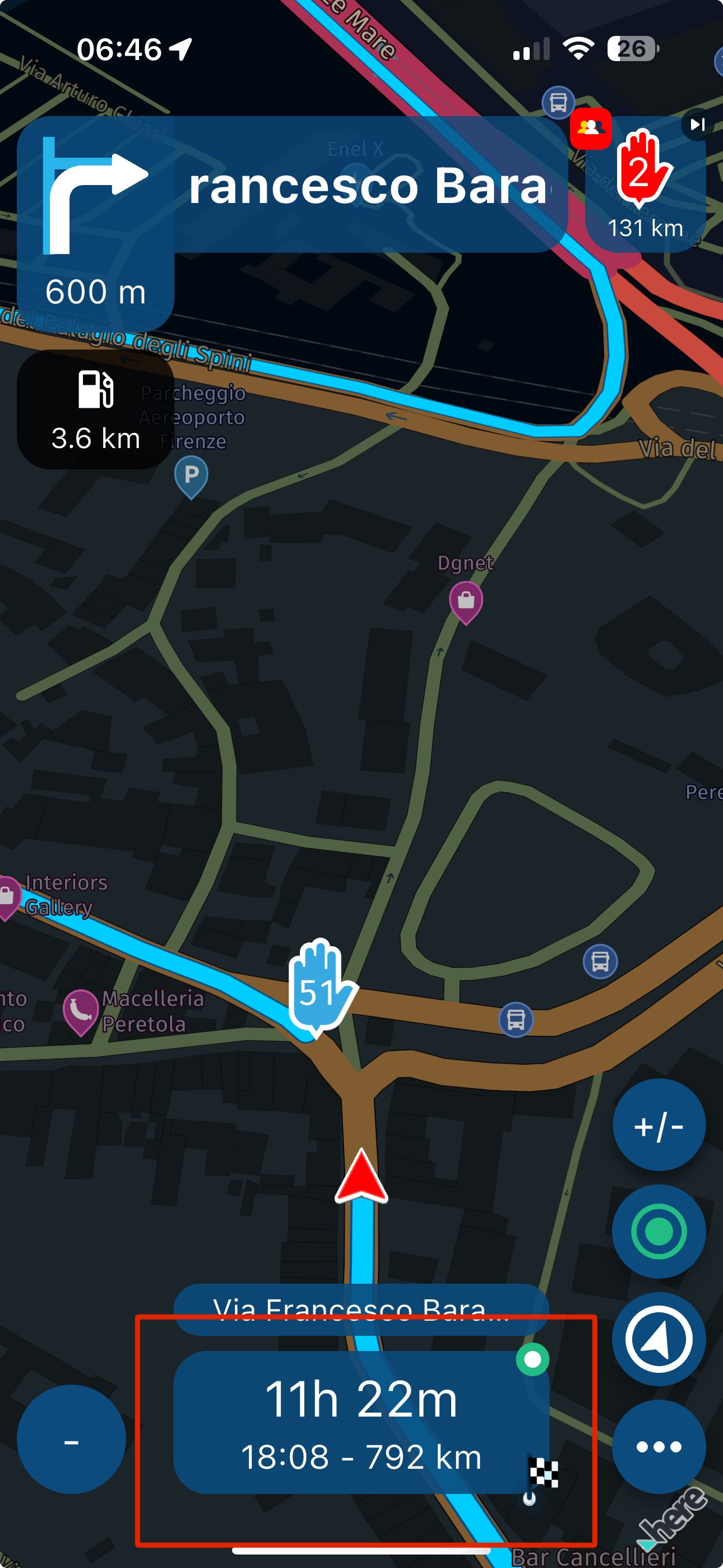

        Thanks @Corjan-Meijerink in fact I remember that it had the function enabled, but I didn't think it could be that, while I disabled it...another question...he had the recalculation disabled, when we went off track and the app asked to do the recalcling, he clicked on the box in the photo but the app was like it crashes and nothing happens...then after 30-40 seconds it came back to answer...I state that there was a data connection...IMG_3425.jpeg
