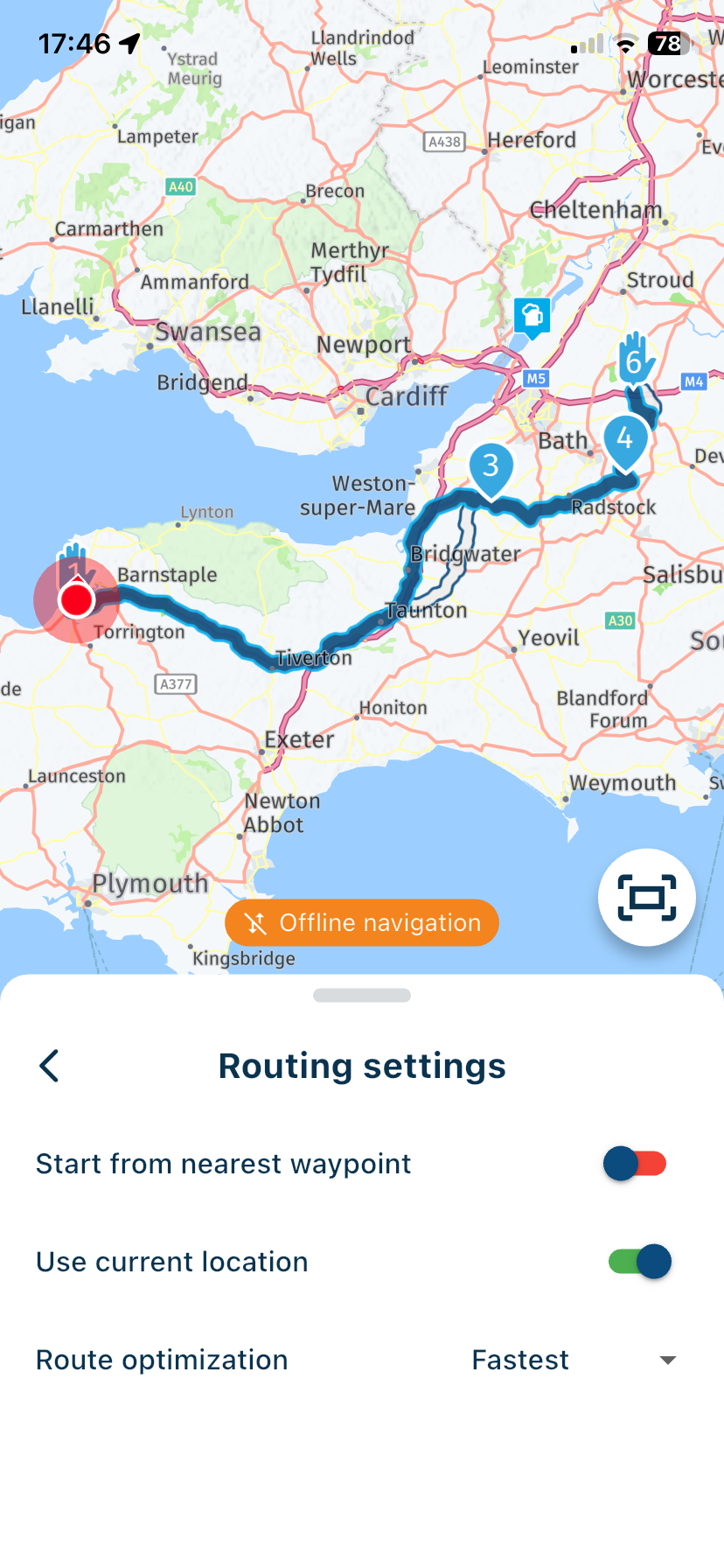

                              Nick Carthew Offline
                              @Philippe-Veys Are you using an A -B route?
                              I see the option to Start from nearest waypoint

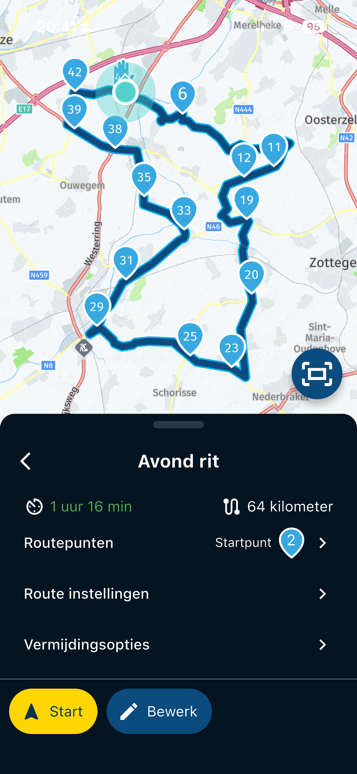

                                Philippe Veys
                                I’m using A to B route indeed. But I just noticed that if I create or change a route in the MRA app on my IPhone, I do have the options ! This must be a bug in the system 🥴

                                  @Philippe-Veys said in Start route bij dichtstbijzijnde routepunt werkt niet:
                                  I don't use the routes as tracks.
                                  I think you do, you just don't know when a track is a track, so
                                  no it is no bug...
                                  Everything you do with roundtrip generator or curvy routes actually IS a track.
