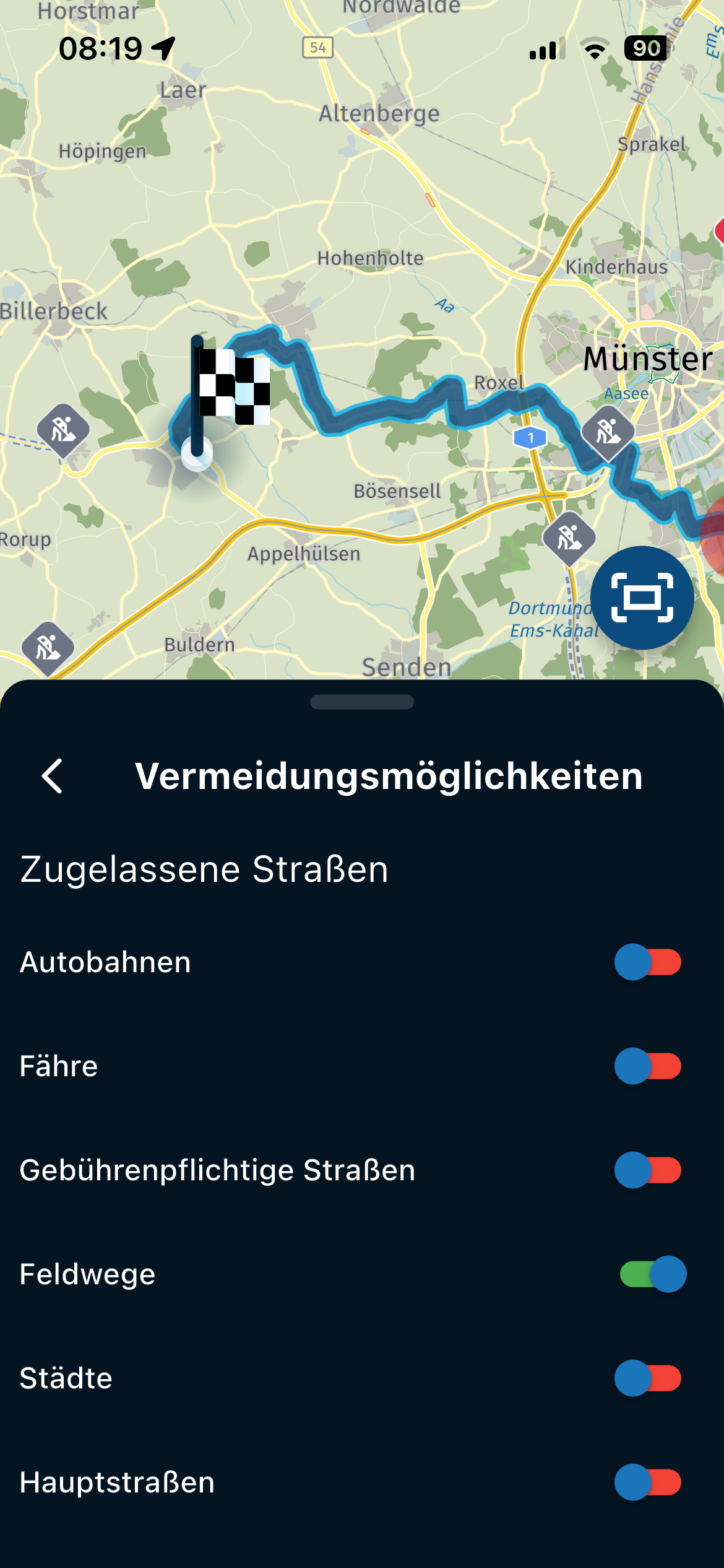

                      I just used some waiting time to make a small test: Inused my iphone with myrouteAPP and surprisingly the iphone version is not using the motorway. I will double check this when I am back home again.
                      MyRoute-APP Navigation Next (V5.2.2 - 489) on DMD T781

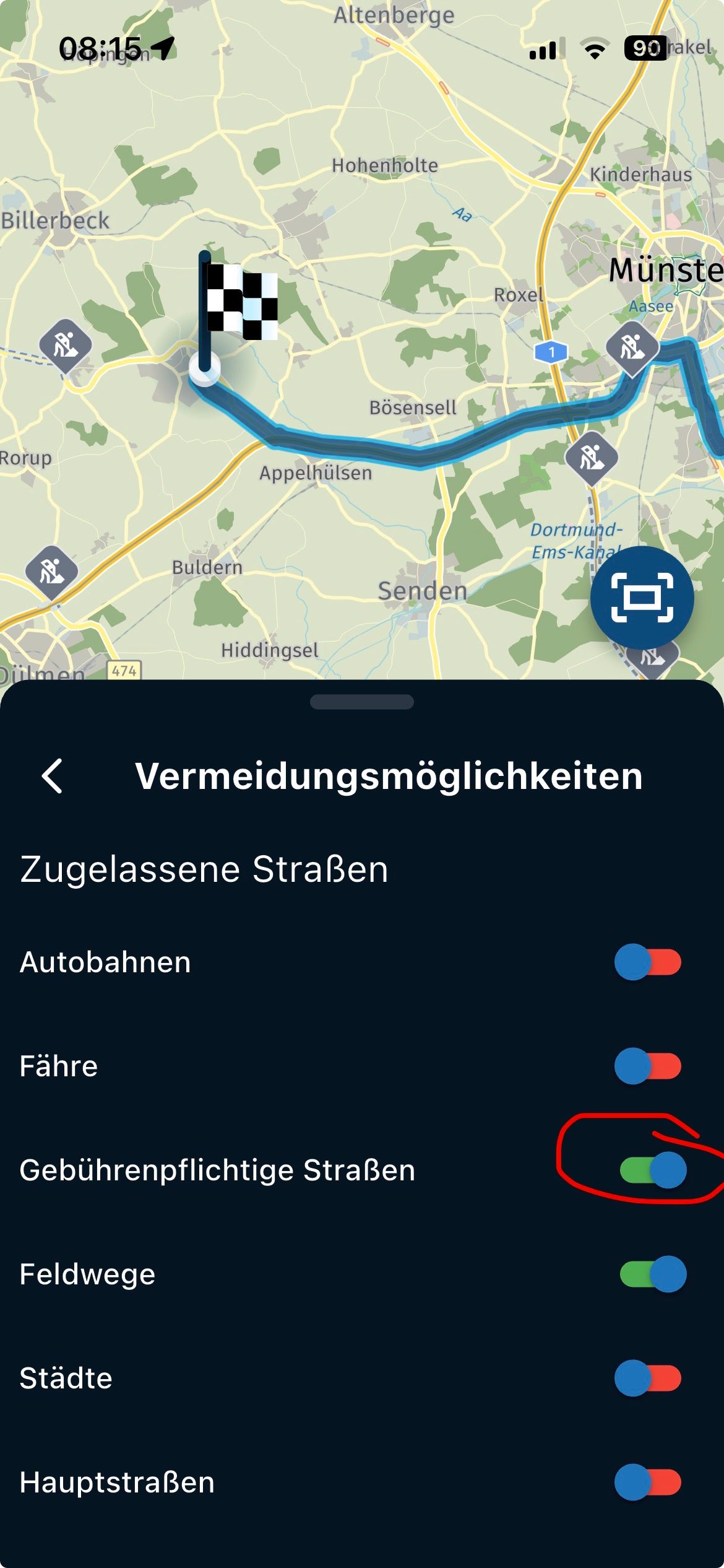

                        @TomOnTour , @Jörgen , @CD130
                        Hey can confirm the error, switch off the chargeable road at medium curve, then the A43 will no longer be used for me !!
                        We do not have such a chargeable street in the region !!
                        Hey kann den Fehler bestätigen, schaltet mal bei mittlerer Kurvigkeit zusätzlich die Gebührenpflichtige Straße aus, dann wird bei mir die A43 nicht mehr genutzt !!
                        Bei uns gibt es keine solche Gebührenpflichtige Straße in der Region !!
                        TomOnTour 1 Reply Last reply
                          TomOnTour
                          TomOnTour
                          TomOnTour
                          @Hubert-Thoring @CD130 @Jörgen
                          Thank you very much for all the information.
                          I have done some more testing and can confirm, that switching off "Gebührenpflichtige Straße" fixed te issue.
                          I also dine sommore testing around potetial different behaviors between iOS and Android and can confirm, that both versions behave in exactly the same way and the workaround provided by Hubert works for both platforms.
