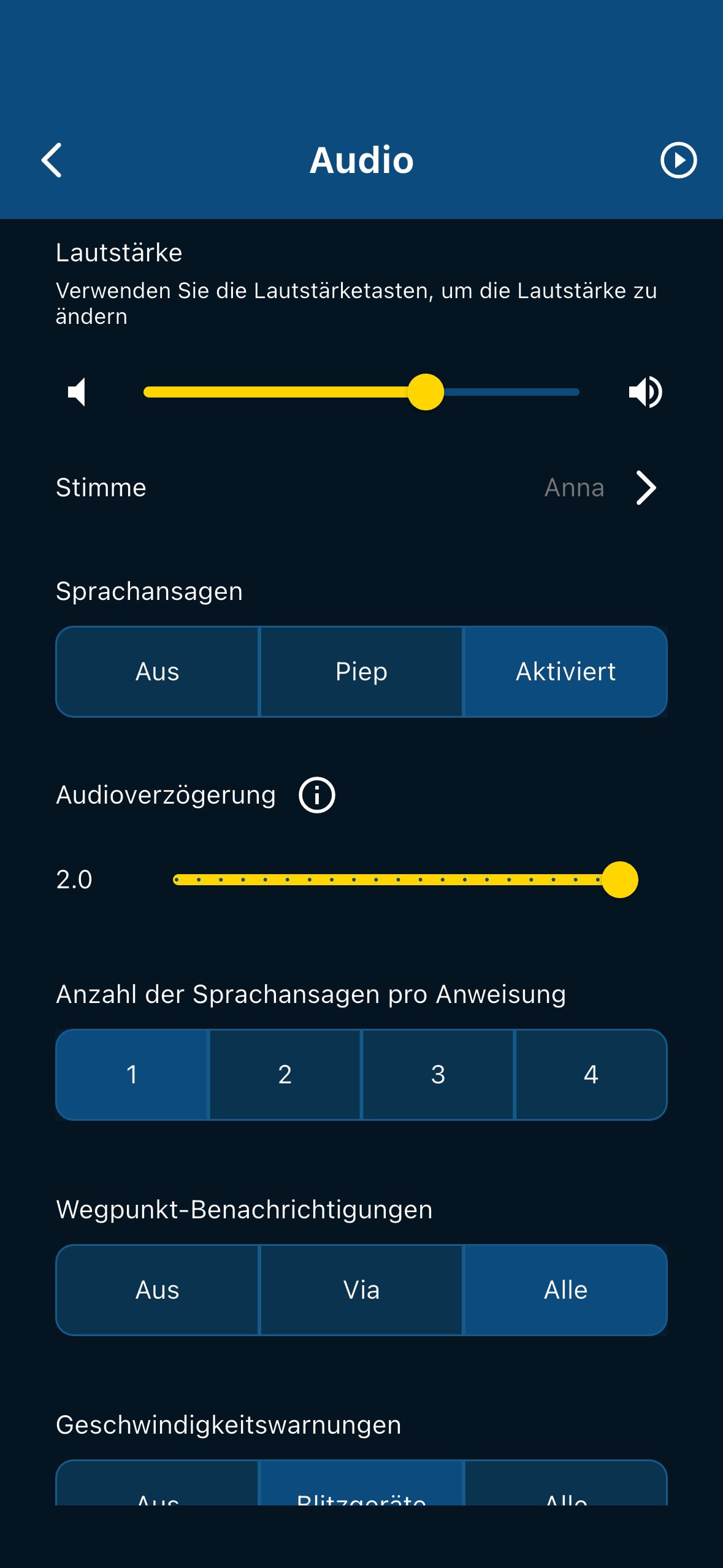

            Hello MRA User,
            I have the Problem, that Audio commands via bluetooth a cuttet at beginning. When I use Audio Output via the iPhone speaker, everything works fine.
            For sure it has to do with Delay to the Bluetooth device.
            On other Apps you can set up a Delay for Bluetooth Audio.
            Anybody Else with this Problem?
            Thanks
            Günter

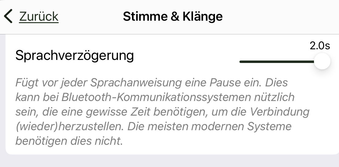

              I set now a delay of 2 sec but the beginning of the speech is still cuttet.
              • Haug Haug

                @Haug, can you please check the version of the app?
                Main screen, tap the account icon top right, scroll completely down.
                What's the number there?
                  #24
                  @Con-Hennekens We all know what number it says 🙂
                  This setting has only been available since the last update!
                  @Haug If the delay does not work could you share the following info?
                  • What phone are you using?
                  • What version of the above?
                  • Does the delay setting actually add a delay (disregard that you still have the issue but is there a noticeable different between 0 and 2 seconds)
                  Haug 1 Reply Last reply

                      Good evening,
                      App version is 5.0.1 - 433
                      I use iPhone 15 with iOS 26.1
                      There is a delay but even at 2 sec it’s not enough

                        Hello Corjan,
                        Today I did some Tests in the car, connected via Bluetooth to my Autoradio. It doesn’t matter, what delay you adjust, the cut at the beginning is always the same length.
                        So I assume,
                        the slider is just fake.
                        Regards
                        Günter

                          @Haug Thanks for your reply!
                          I can guarantee you, the slider isn't fake 🙂
                          Your audio system not respecting it, is another thing.
                          I haven't yet seen any iOS device with these issues.
                          It's always Android to be honest 😉
                          I'll test some different configurations to see if I can reproduce this.
                          Just to be sure, you are not using CarPlay but simply the car radio as bluetooth audio device?

                            Exactly, my car has no CarPlay.
                            The same happens, if I just connect a headphone.
                            Can even try another apple device
                            Haug Con Hennekens 2 Replies Last reply
