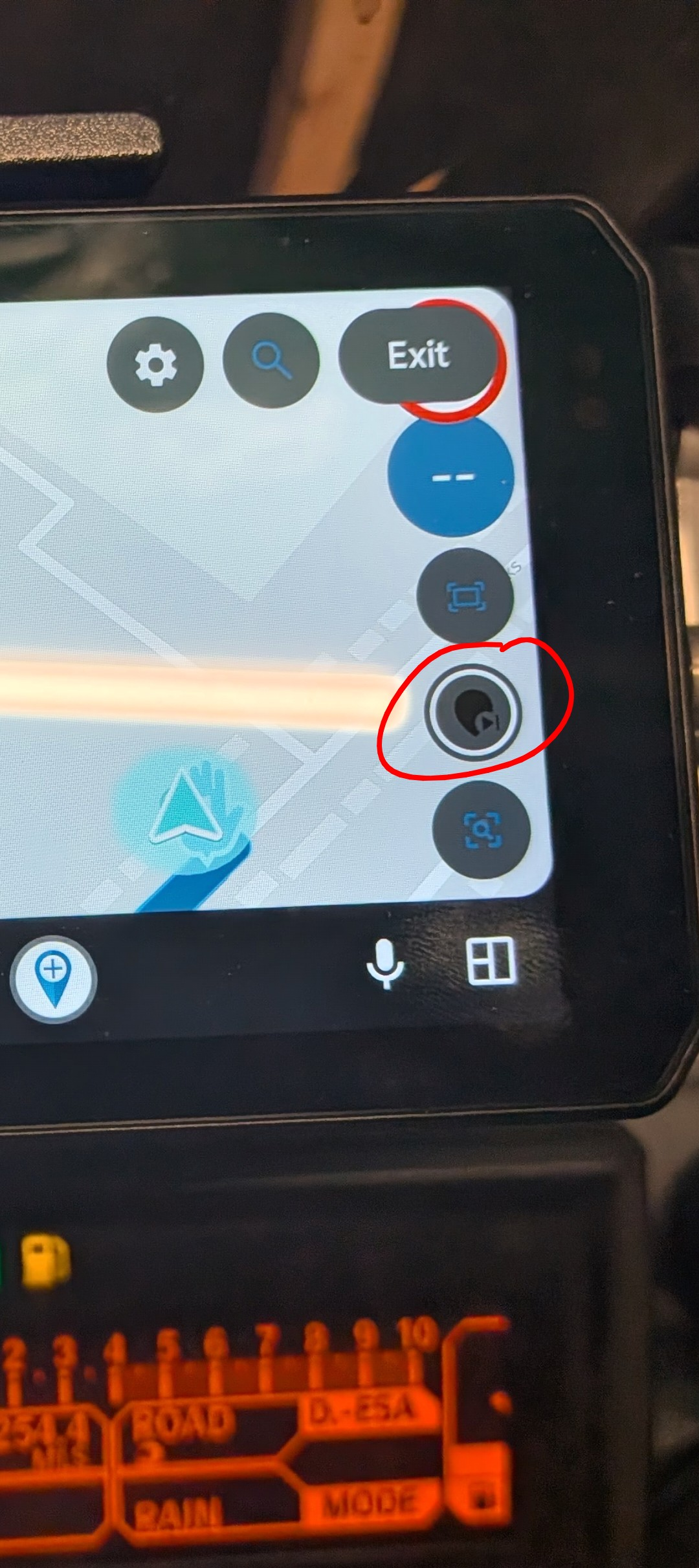

    I have just returned from a 3 day tour around East Anglia using My Route App on my Android phone and Chigee Aio-5 for BMW. Two problems I found both related to skipping way points.
    First the 3/4 circles (button) on the right of the screen a dark in colour and I cannot distinguish what each one does.
    Secondly I couldn't delete waypoints as pressing any part of the screen or these buttons seemed to do nothing. Sadly, in the end, I had to abandon the MRA and revert back to google maps to get me to the hotel.

      @Peter-Gordon-Whitmore, the dark buttons are a know problem and is already being worked on. I am not sure if it is know why this happens, as for most users there seems to be no problem. For the rest it would be good to take a look at the support page about Android Auto. You know that MRA is not here to create a gMaps clone? It has a fully different set of competencies targeted at scenic navigation of pre-planned routes.

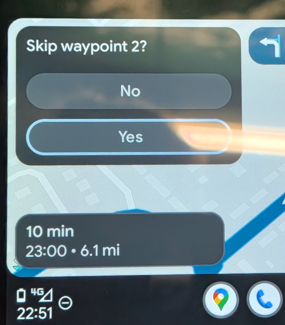

              • Dave Edge Offline
                Dave Edge Offline
                Dave Edge
                I run a Chigee BMW and android too, may be able to help.
                Also having the same colour contrast issues but have been using MRA on the Chigee for a while now so can usually remember which icon doesn't what.
                You shouldn't need to touch the screen or use the phone to skip waypoints as long as the wheel is active on the MRA screen when scrolling and not the Android Auto (AA) shortcuts on the bottom row.
                A short press of the bikes indicator cancel button switches from AA shortcuts to the current open App screen. Long press of the bikes indicator cancel button switches back to the AA shortcuts.
                Scrolling the wheel, look for this icon and toggle the wheel to the right.
                Hopefully you'll get a confirmation notification to scroll through No or Yes and toggle the wheel right again to accept your choice.
                Hope this helps & fingers crossed the colour issue gets resolved.
                Peter Gordon Whitmore 1 Reply Last reply

                    @Dave-Edge Thank you for that piece of advice. I haven't used the combination of Chigee & MRA before so it was a trial by 'fire' so to speak. I appreciate that the wheel could be used but didn't know how so you advice is very much appreciated and I will give it a go next time I am out. Many thanks
