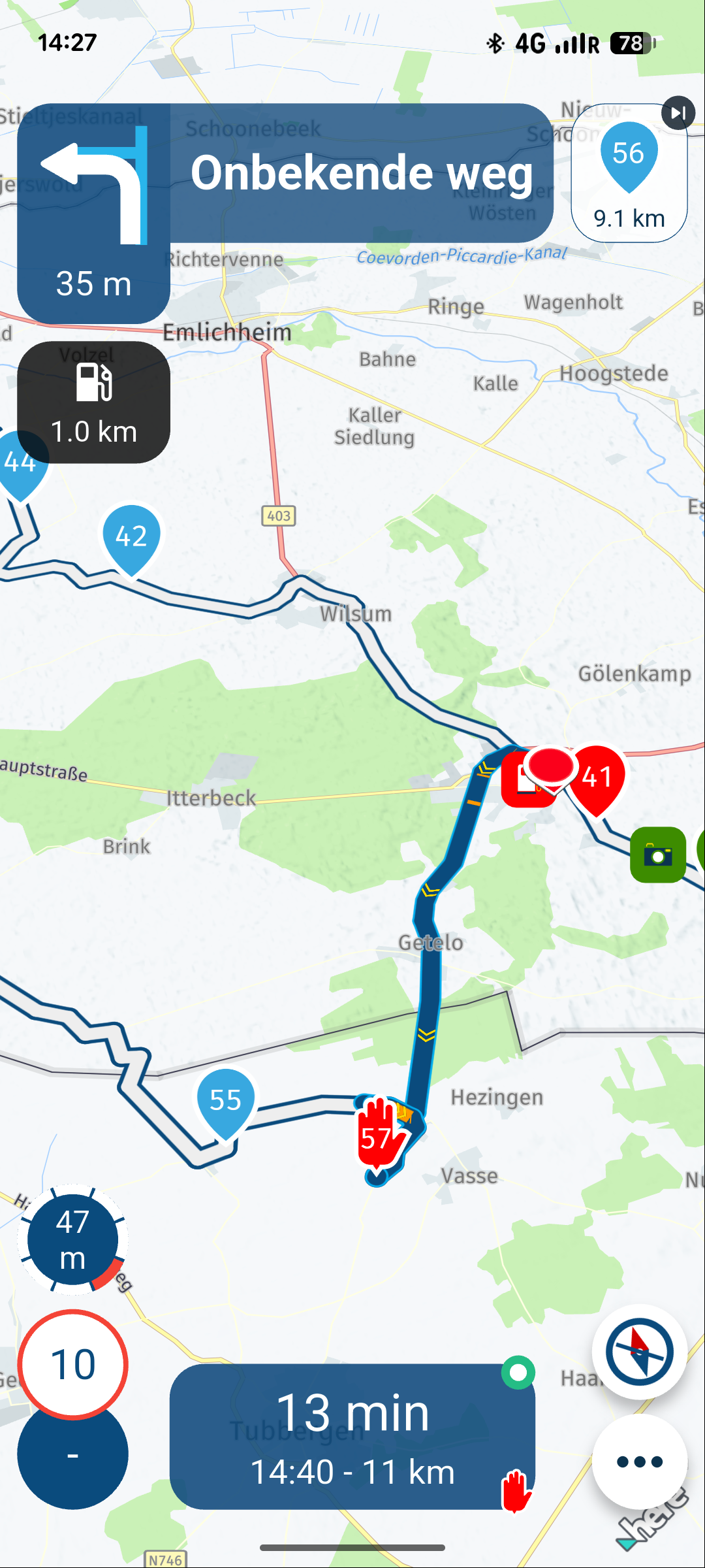

                                          #40
                                          Today i rode the route again. Just to see if the same problem happens again. And it did. Same place same result.
                                          I lost cell coverage and approx 500 meters later, point 42 was skipped to point 56.
                                          See the result in the screenshot below
