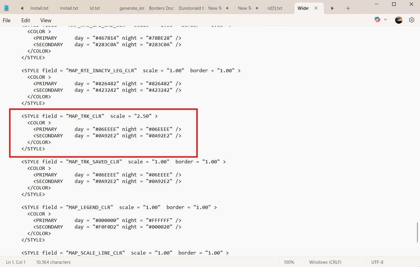

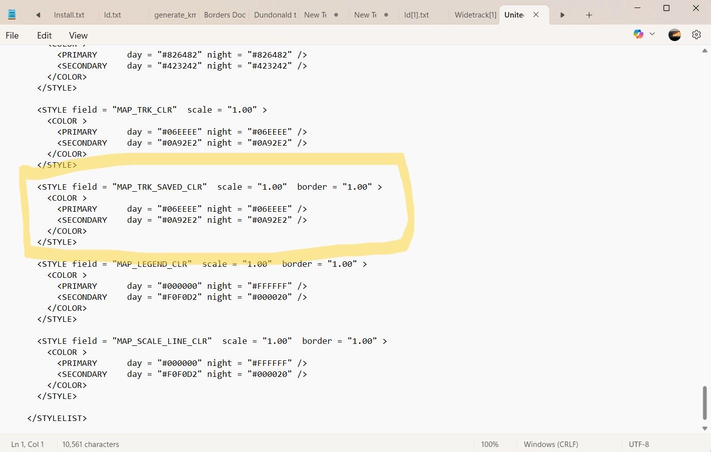

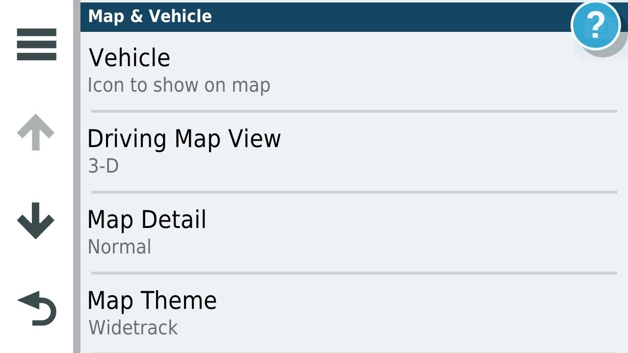

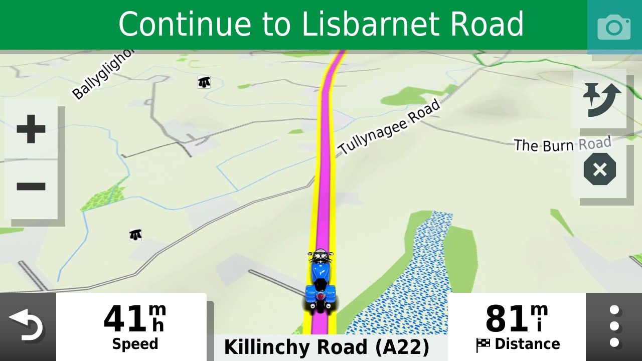

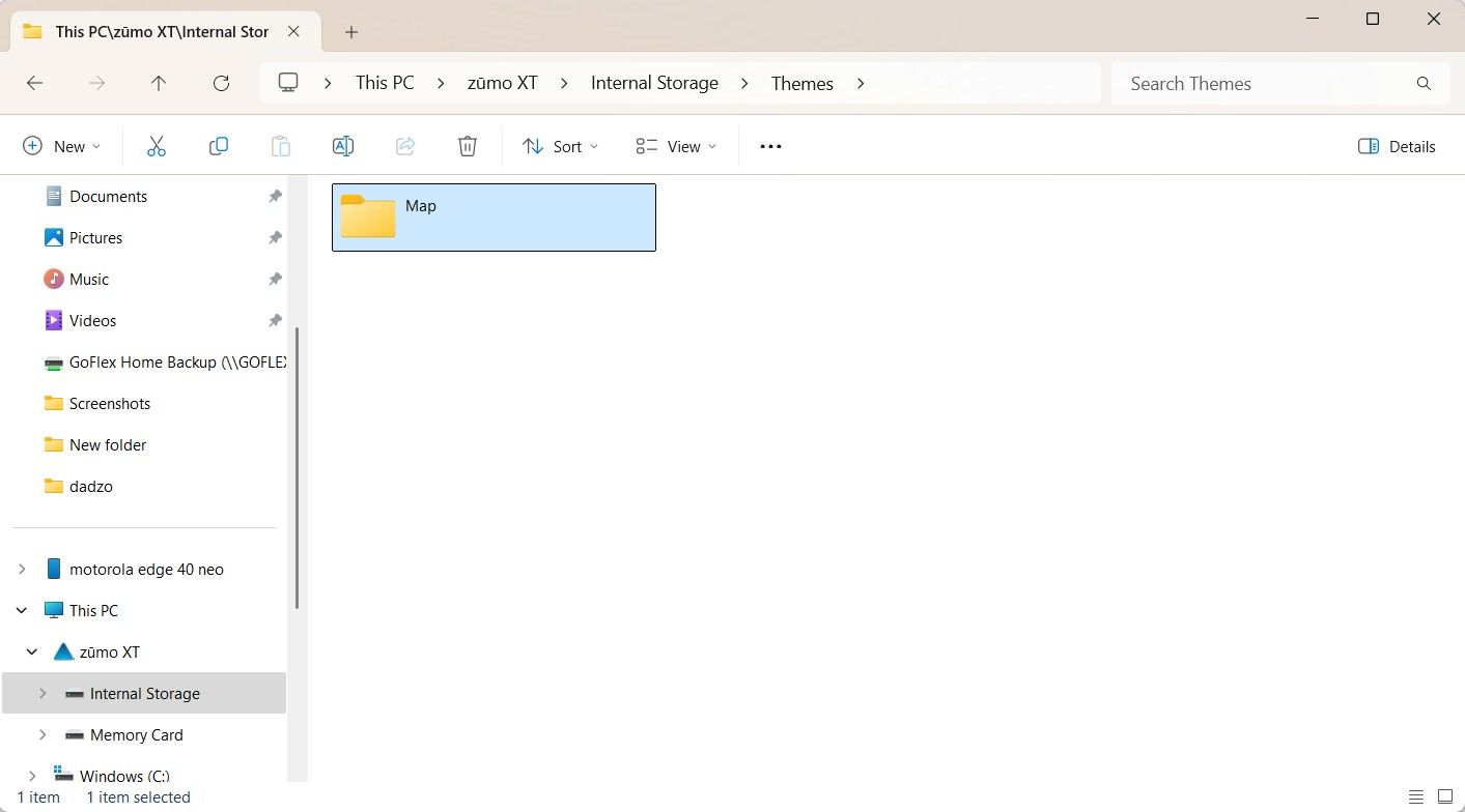

                        Tracks can be set at various widths on the Garmin Unit for the XT at least (the XT2/3 might be similar) the maximum track width is too thin to be seen beneath the route unless the route diverges. To change the displayed track width you need to edit a Theme file. These files are stored on the XT and can be accessed and changed here on the unit. I created a theme called Widetrack which means that the track is always wider than the magenta route line and easily seen. By default this is not the case.
                        There are several themes available on the unit and the default for UK units is unsurprisingly United Kingdom.

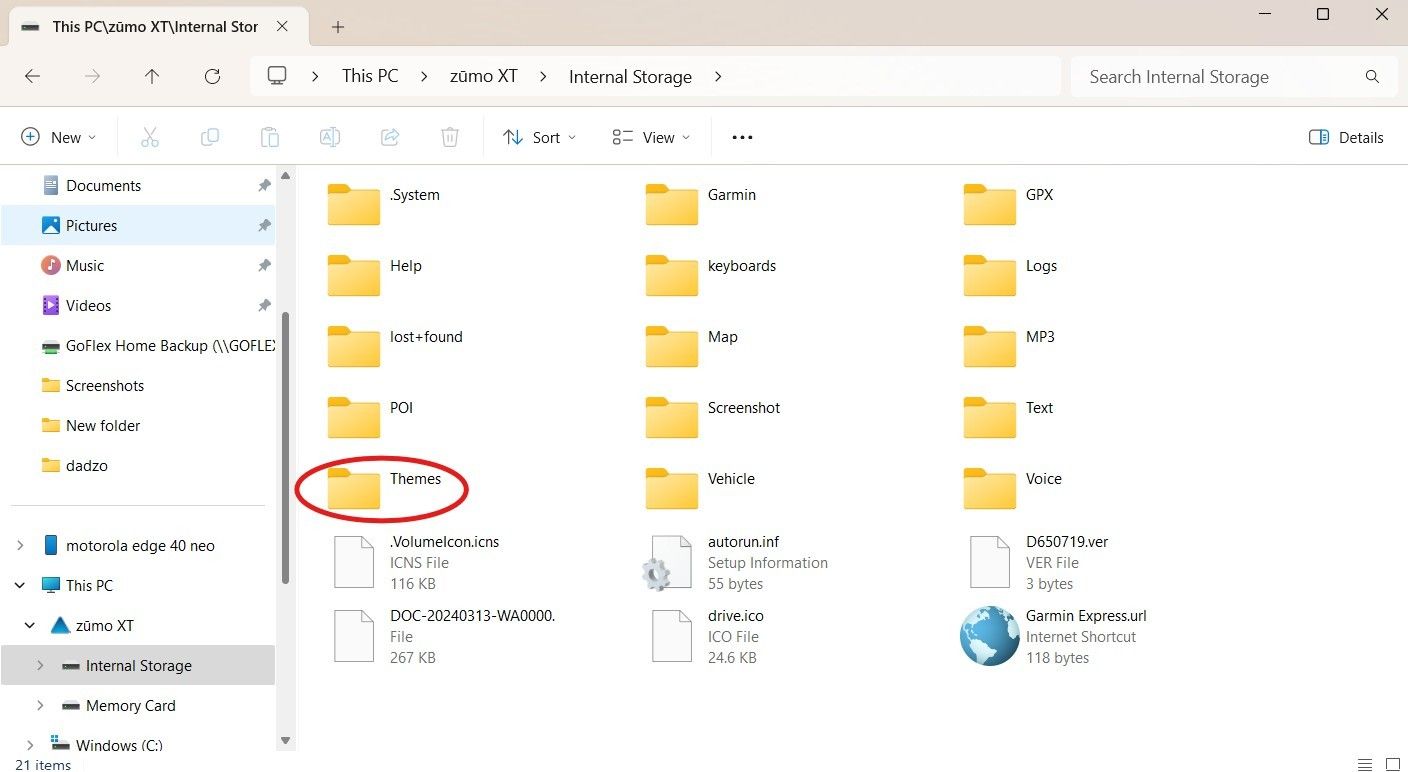

                        To change the Default width of the track I copied the United Kingdom theme on the unit these are .kmtf files and can be read and edited by a text editor such as Notepad.
                        They are accessed by connecting your unit to a computer.
                        This is a list of the themes onthe UK units and there might be a layout you like more than the one you are using. I copied the uk theme and changed the name to Widetrack.kmtf.
                        to Edit the >kmtf files open in notepad
                        And scroll down to the track width parameter in the text file. The default for the parameter of track width is "1.00" by default I changed this by trial and error to "2.50" you can fiddle with this yourself to devise a width that suits.
                        For comparison this is the same parameter in the original file. You can mess with all of the parameters and as long as its with a named file of your own making you can't break anything.

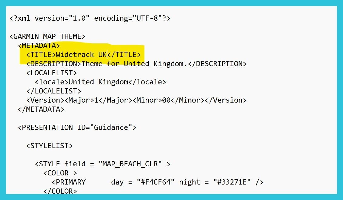

                        Don't forget to change the name of the theme at the top of the file in the text editor so that you can select it in the menu on the unit and it does not overwrite the theme file you altered.
                        With the wider track in the theme you can have it look like this during navigation.
                        I usually select yellow but you can pick whatever track colour you prefer.
                        Guzzist 1 Reply Last reply
