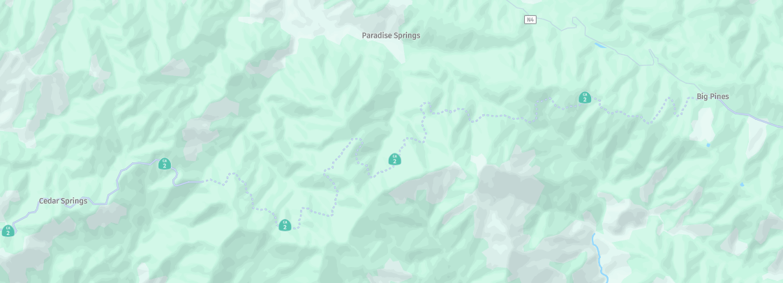

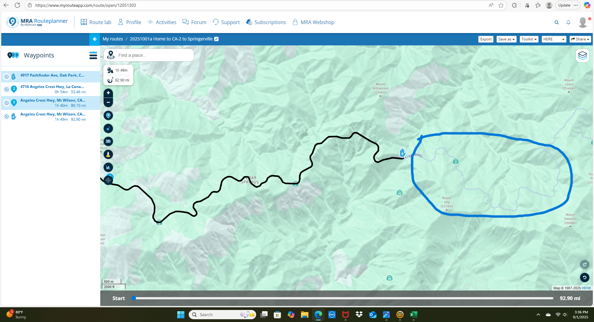

          • John S Parry
            wrote on last edited by John S Parry
            Thanks Brian. I appreciate your input.
            Yes, you got the section of CA-2 that had been closed absolutely correct:
            It's a been a long-term closure due to difficult road repairs. That's why it shows as closed in HERE. Well, it's open now. With the track record of HERE, it could be weeks before they update their map to a "road open" status. It's easy just to blame HERE, but how does Basecamp (which is also HERE based) allow routing closed roads? I also use an Apple based navigation planner called inRoute, and they have an explicit setting option called "Ignore Closed Roads", allowing you to route through them for whatever reason you have. Of course it's a buyer beware kind of setting, but the reality is that Google Maps is the gold standard and your best friend for up-to-date road status into, which is why I use it for final validation regardless of route planner I'm using.
            If nothing changes, my options are to either use Basecamp or inRoute as an alternative to create the route I need. I'd rather not play gymnastics with MRA and have to work around it. If this is simply a wart we have to live with, I'd just like to know.
            On Edit: I tried both TomTom and OpenStreetMap views as a workaround. I can place a waypoint in the closed section, but MRA won't create a route line to it.

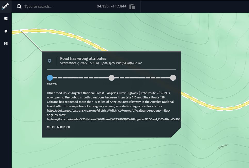

                      @John-S-Parry I think the best option is to report it to HERE using the website that @ErikMatthezing shared above. The more often it is reported the more chance there is of a map update. He who shouts loudest 😊
                      I have just reported the re-opening of The Angels Crest Highway.

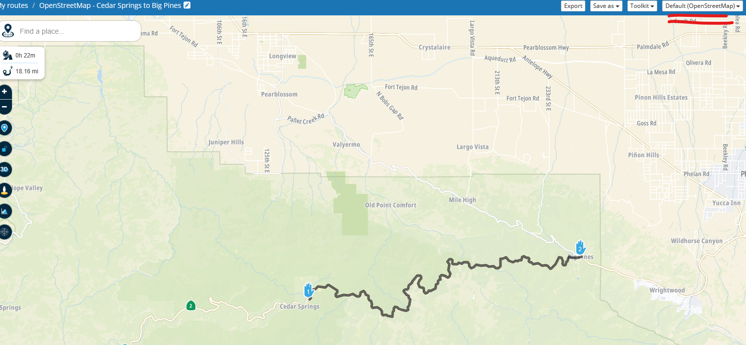

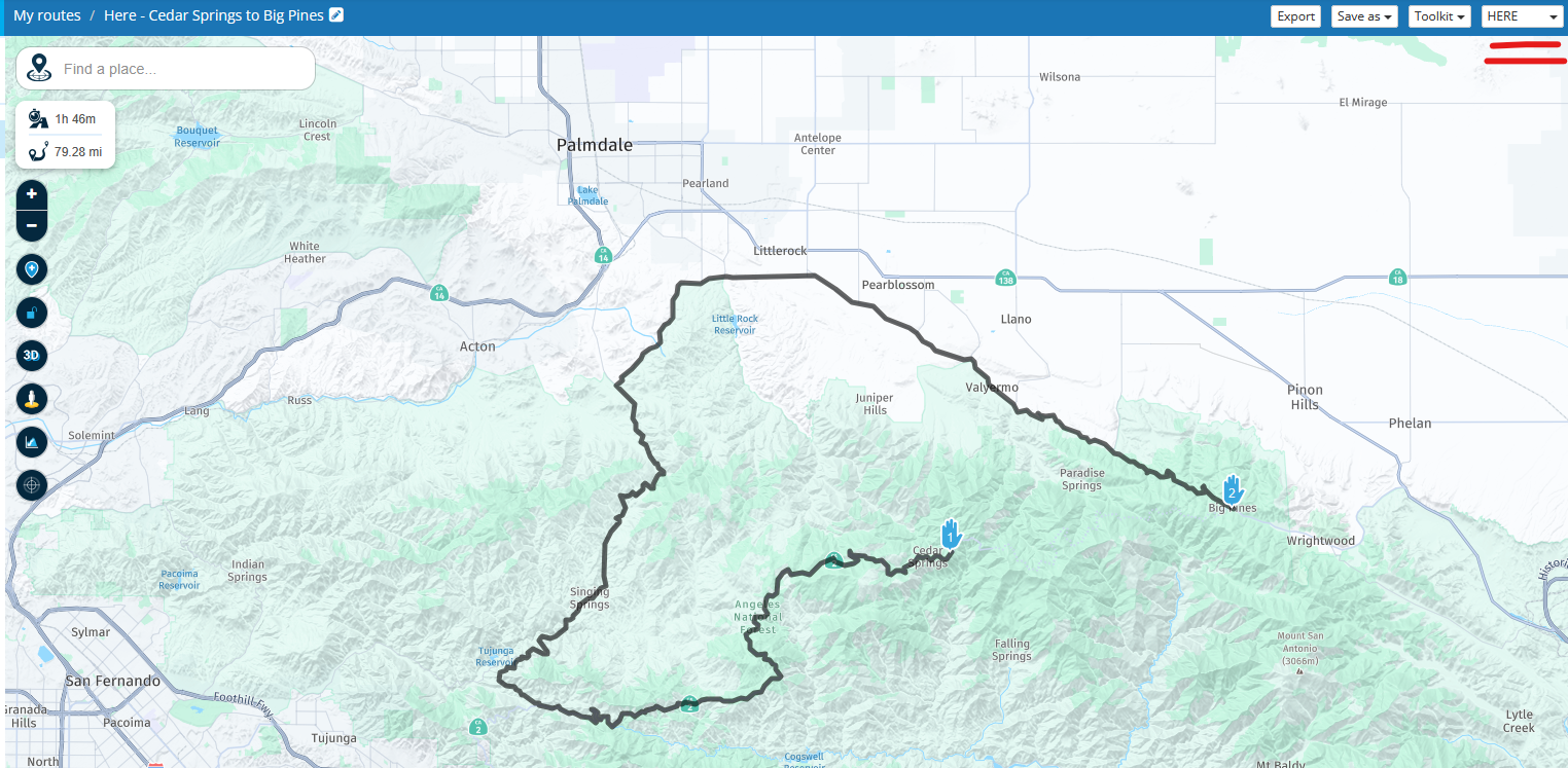

                              • BMcG BMcG
                                Hi @John-S-Parry said in Here Maps not Recognizing Road is now Open:
                                Sorry but I have to say it is possible to route along the CA-2 between Cedar Springs & Big Pines with both OpenStreetMap & TomTom selected as the routing options
                                TomTom - https://www.myrouteapp.com/en/social/route/12058866?mode=share
                                OpenStreetMap - https://www.myrouteapp.com/en/social/route/12053492?mode=share
                                The Here option obviously does not route - https://www.myrouteapp.com/en/social/route/12058878?mode=share
                                I am very confident that the idea in my first post, using OpenStreetMap or TomTom in offline mode works, as the second image in that post is actually MRA navigating along the CA-2 just outside Cedar Springs & heading towards Big Pines.
                                All the red warning triangles are advising that the road in the Here map is not passable
                                It is possible you may have another setting MRA that is preventing the routing in your account, if you share your route it may be possible to see why you cannot route along the CA-2

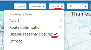

                                        @John-S-Parry the routing calculations in MRA are controlled in this drop down
                                        29c4f3ac-59c7-4646-9a31-1e96047ef2b5-1755462616223-7be96ad9-be99-45cc-99ac-aaa24d9e5de5-image.png
                                        The map layers are just graphic overlays they just show you where the roads are, they are not responsible for calculating the routing, it is irrelavant what Map Layer you use, they just make the screen look nice
                                        82728374-0a07-4fc3-8d60-9c50a765d6f9-1755463302362-8f4a81f2-bdf9-43b4-92fe-e760431a048f-image.png
