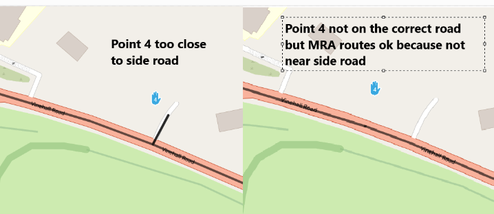

              Hi @Jan-Smerke have had a look at the shared route & can see no issues, no mini diversions
              As you correctly state this revised route is probably not going to reveal the cause of the issue.
              I did notice the shared route seems to be set to route using OSM & not Here which is not ideal if planning to navigate with MRA
              I know you said the original map was saved as routing with Here so this routing change is probably one of the revisions you made
              As @M.-Schrijver says placing points near junctions or side roads is a common issue that can lead to mini diversions. It is far more important to avoid this misplacement on side or adjacent roads than it is to place the point directly on the correct path / road.Navigation systems will generally cope okay with reasonable placement errors, they will automatically try to route via the nearest road.
              Examples below show how mini diversions can easily occur ( I have just played with point 4 in your route)
              Different navigation systems have different tolerances to what they consider a reasonable placement error.
              I have found MRA navigation is very tolerant to misplacement of points off the intended road, a Garmin XT however a lot less tolerant
              All navigations systems will have a problem if points are placed near side roads, they have no idea if you wish to take the side road or not
