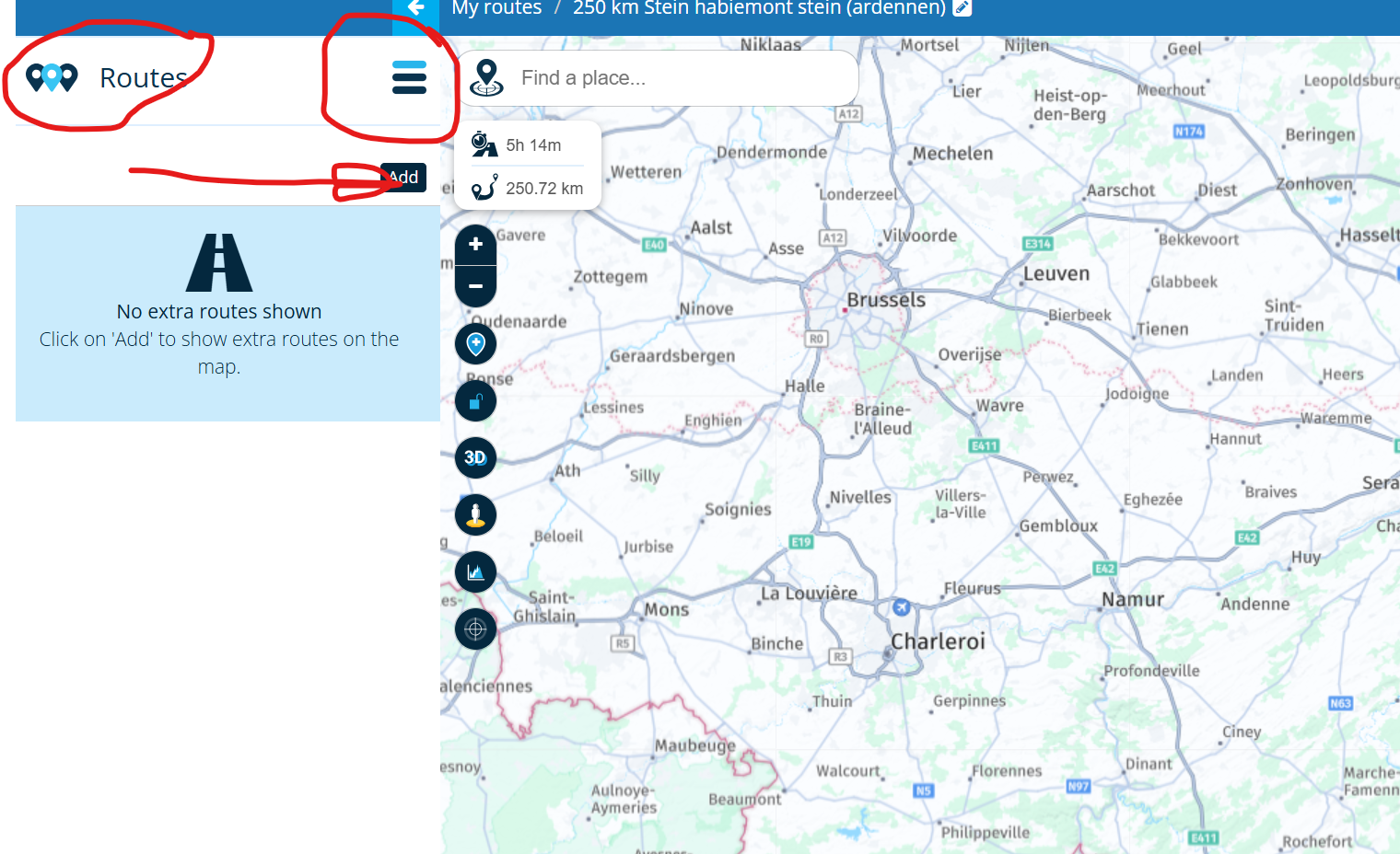

    • Leike Lodiers
      wrote on last edited by Leike Lodiers
      When you open one of the route you made klick on the hamburger menu on the left side and klick on routes en you can add the other routes to you're open route!

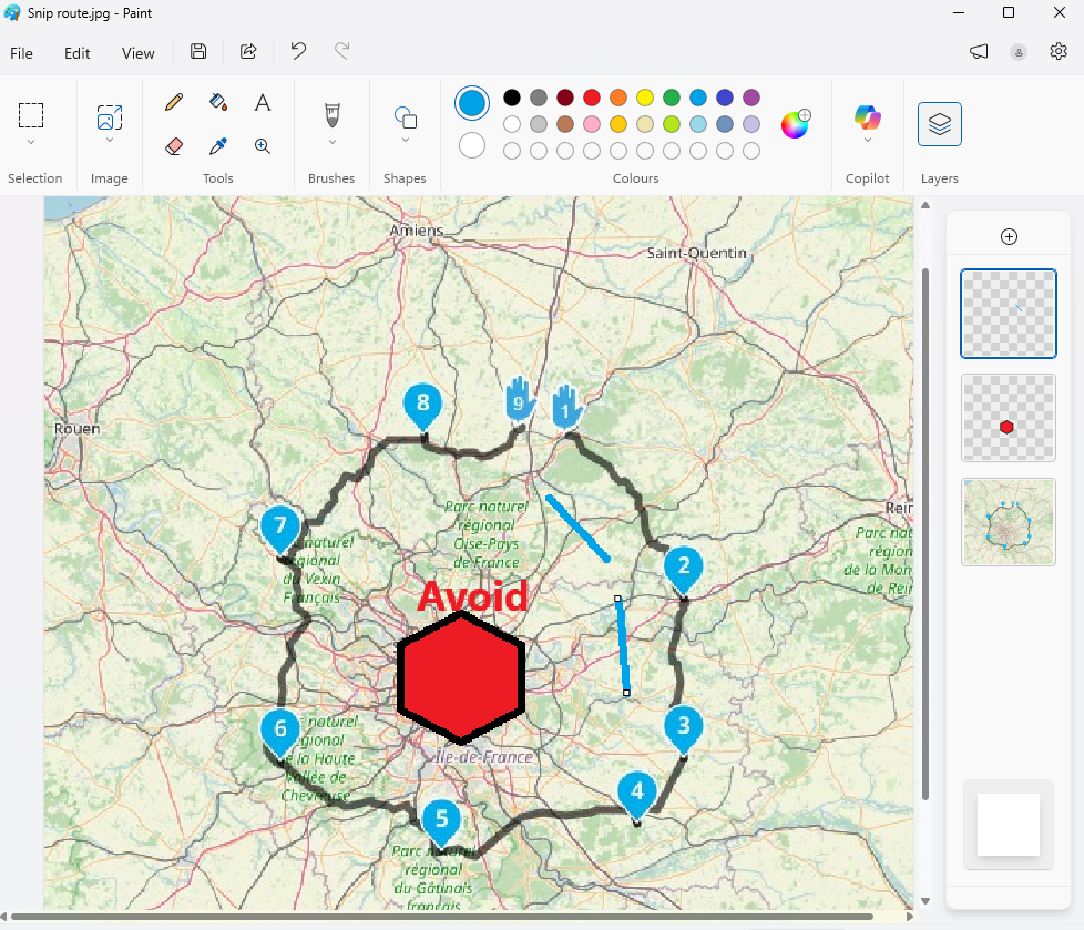

        Hi @Steve-James I don't believe you have missed anything & as far as I know such a feature is not on the radar for the near future, maybe on some distant plan / wish list
        My suggestion to achieve sort of what you are after, all be it not within MRA, would be to use the windows Snip tool to clip a picture of your route.
        Open this picture in MS Paint & then use the Layers function to add each individual set of lines, areas or text.
        Use Layers so you can update the base route map when it changes & remove stuff thats out of date or errors

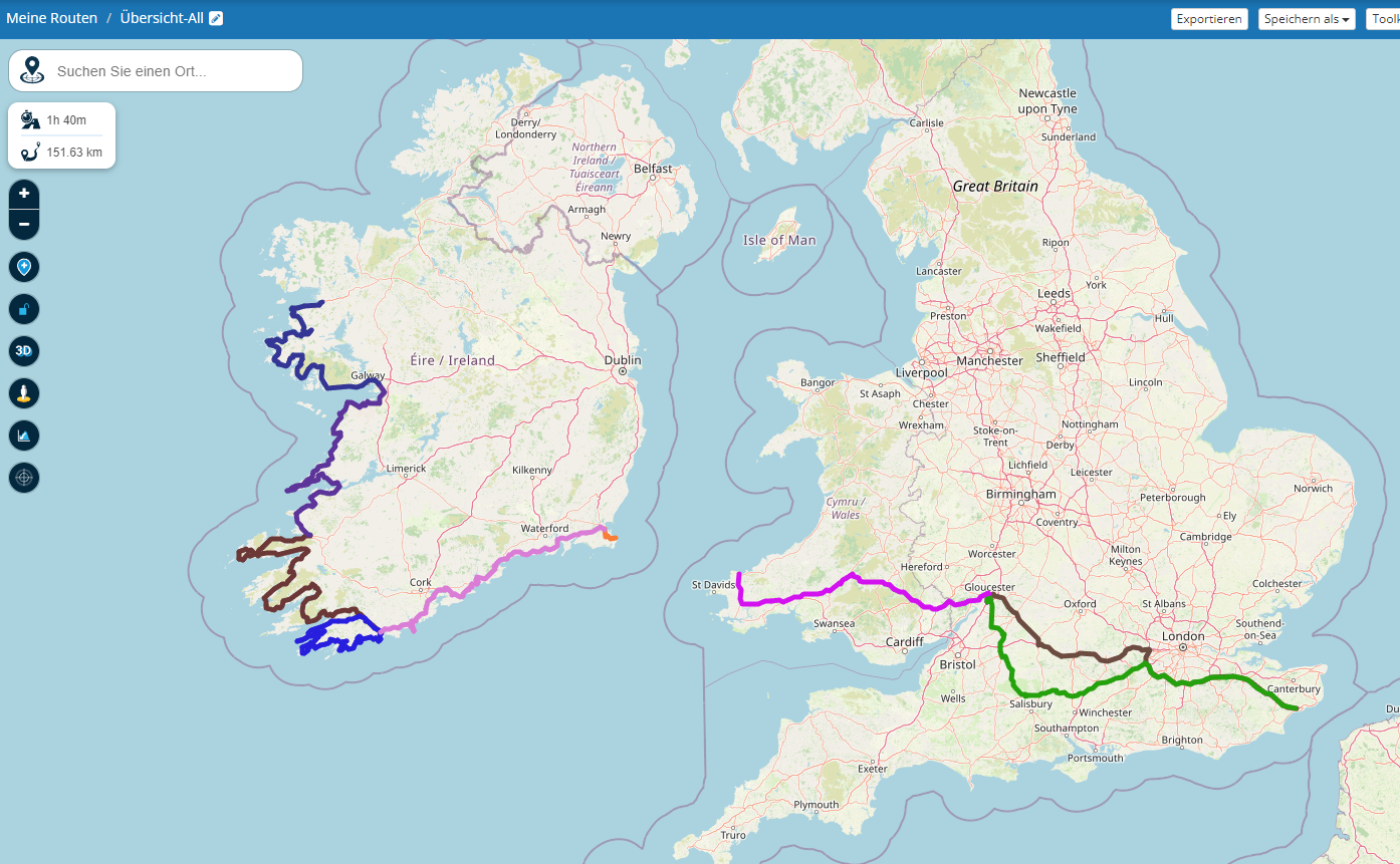

            As explained above, it is possible.

              • Jörgen Jörgen
                Each color is a day tour.

                    Eine Neue leere Route erstellen, z.B. "Alle Tage der Tour XYZ".
                    Dann in dieser nur die einzelnen Tage (Routen) über "Routen hinzufügen" hinzufügen.
                    Wenn man möchte, kann man in der Routen Information und Beschreibung noch was zu den Farben usw. sagen.

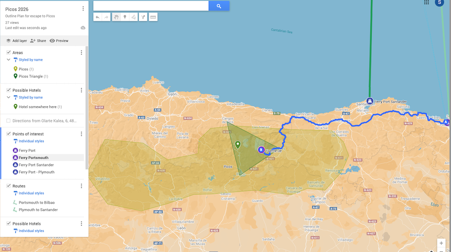

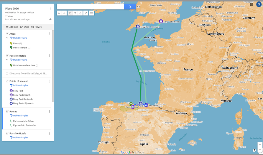

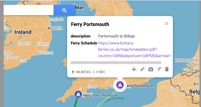

                          Just incase anyone is interested, my latest work around is to use Google's mymaps, to overlay annotation on a google maps background with goolemaps functionality. You can share the overlay with others.
                          I've added a screenshot of the overall, plus a couple of 'zoom ins'. Note you can add information to the points, if you look at the ferry port icon that I added, I have been able to link to the ferry sailings schedule. All useful stuff in the early stages of planning, especially if sharing.
                          It's a shame that I can't select the overlay to be visible when planning on myrouteapp.
                          To do it this way would make implementation easier.
