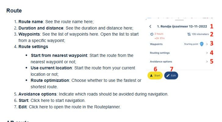

          https://support.myrouteapp.com/en/support/solutions/articles/12000106512
          I don’t think you’ve understood what Rob was trying to tell you.
          This one-click function is also available in MRA.

                                        @Stevedo-6-0 After opening the link from @con-hennekens click on Navigation to go directly to the Navigation section. The wording may not say it skips all previous waypoints but it does state that the routes starts from the chosen waypoint. Here’s the bullet point:
                                        When starting, you can also start from a specific waypoint by pressing it on the map for a long time.
