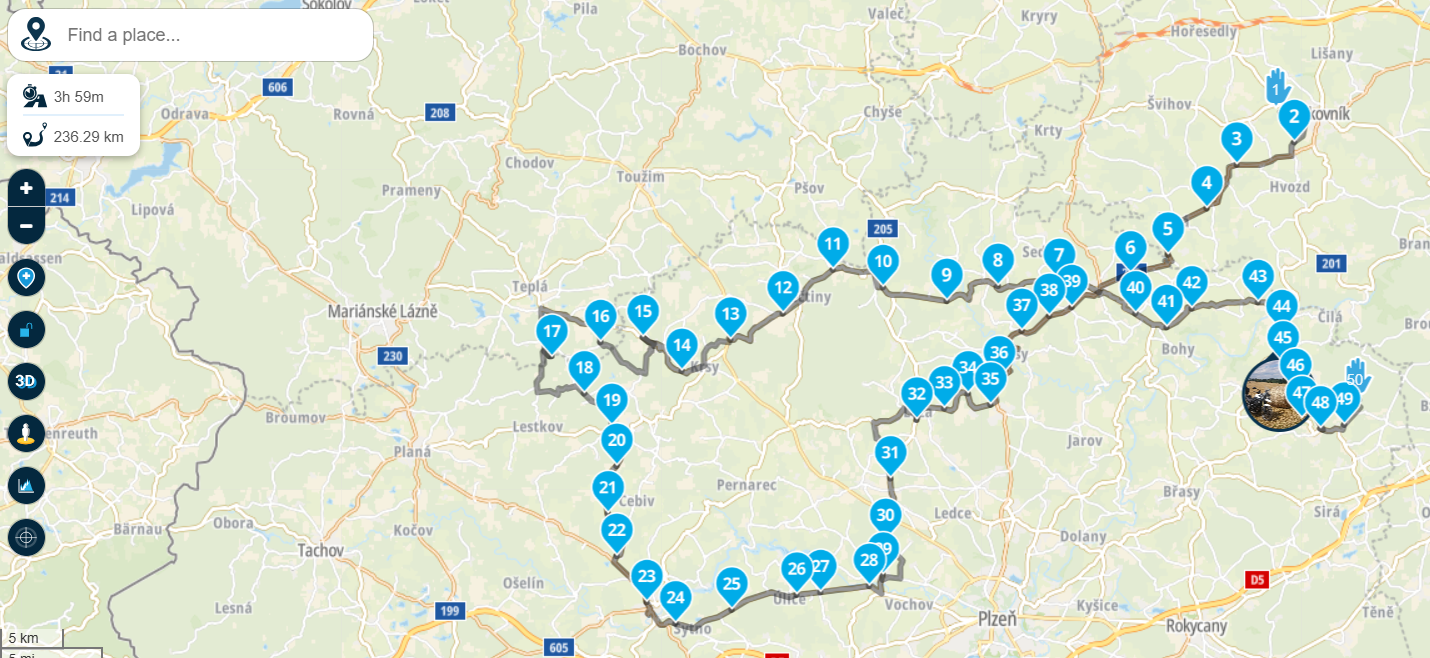

    I have a question. in the MRA planner I have planned a basic route (openmapstreeet layer - image with five points). When I put the function "expand "to 50 points. the miplanner replanned the whole route. I thought that "expand" would add 50 points to my planned route.

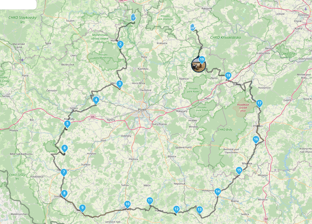

          At this point, this function does not make sense to me. so to keep the same route as in picture 1 (created by OMS) and HERE does not recalculate it according to its algorithm, I have to manually click another 100 points. otherwise HERE recalculates the route according to picture 2 as I do not want it. I thought that "EXPAND" would make this manual work easier. Too bad

              I tried this function three times and every time I put "EXPAND" the route changed.

                I’ve looked at your route.
                You’ve got a couple restrictions active and most important you’ve set the OSM to use the curvy road option
                You Said the route was a gpx file to start with.
                What does the original gpx route look like.
                If you expand while use curvy road is active you’ll get a different route

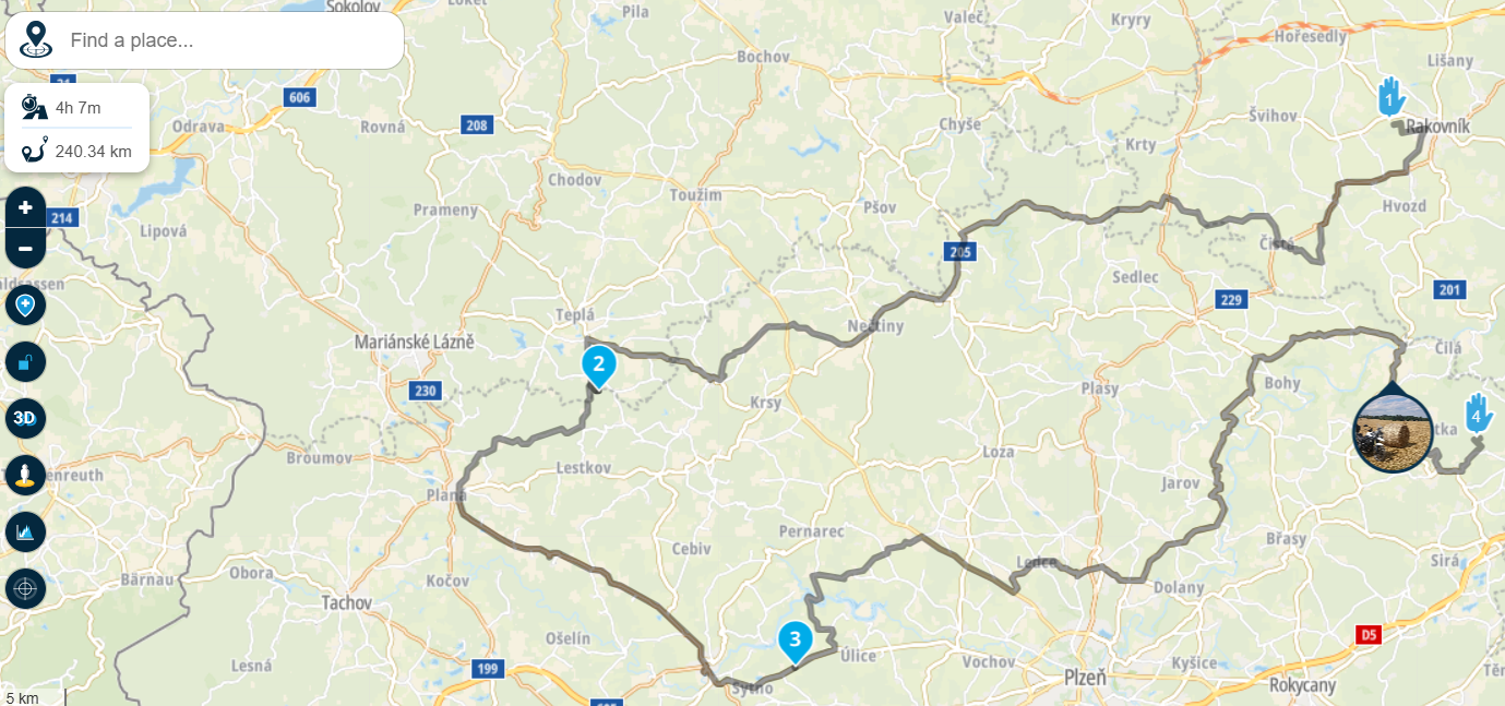

                  I did not create it directly in OSM, but in MRA through the OSM layer, see picture. Yes in the settings it was zigzag, out of town, off highway. I liked the route and that's why I wanted to add more waypoints, so that the navigation (MRA) would navigate me exactly along this route, because I know that MRA follows HERE and it has a different algorithm for creating routes and would guide me differently. Unfortunately after adding 50 points it created a completely different route. I kindly assumed that it would add the points to my original route. Now I hastily made a second route and the same result.

                                      So I found a bug. when I perform the same action on the base of TOM TOM maps, the "EXPAND" function works as I want. On the OSM base it generates a different route. I attach a video of the creation on TOM TOM
                                      video TOM TOM (there is OK):
                                      https://k00.fr/n1vrs605
                                      video OSM (wrong route):
                                      https://k00.fr/kvxz2d3t

                                          That is not a bug. TomTom and OSM use different card material and different algorythms for calculation of the route. Compared with different setting like cury route, restrictions like don´t use highways, etc. that behaviour is absolutely normal.
