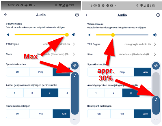

    Dear MRA Team,
    am using Myroute app 4.4.0-404. During the navigation the Voice get quiet, and quiet.
    When using the volume down buttons, the voice announcement becomes quieter and quieter. You can no longer increase it while driving. Eventually you can no longer hear the announcement at all. If you want to vokume up it doesn't.
    The volume always refers to the connected BT device. The Myroute, however, refers to the volume of the cell phone. You have to stop an navigate to Audio settings. At the next volume down on an connected SENA 30K Myroute app get quieter an quieter. The same procedure, you got to stop and level up in the app.
    I testet it on SENA 30 and Carpuride in my Car. It is both. At all devices the same issue.
    You should offer three levels: quiet, medium and loud. Or a fixed level hook so it get not quieter. So that the navigation instructions can be heard clearly above the music.

        @Westerwald_Rider said in Voice Navigation anncouncement too quiet:
        That's a new one...
        Why can't you increase the volume while driving, does it already show max volume?
        I never saw (heard) this behavior.
        I assume you are talking about the volume slider in the MRA app settings? This slider shows the system volume, equal to pressing the volume buttons. The slider may not show the BT symbol, but when your phone is connected to a headset, it certainly influences the BT volume.

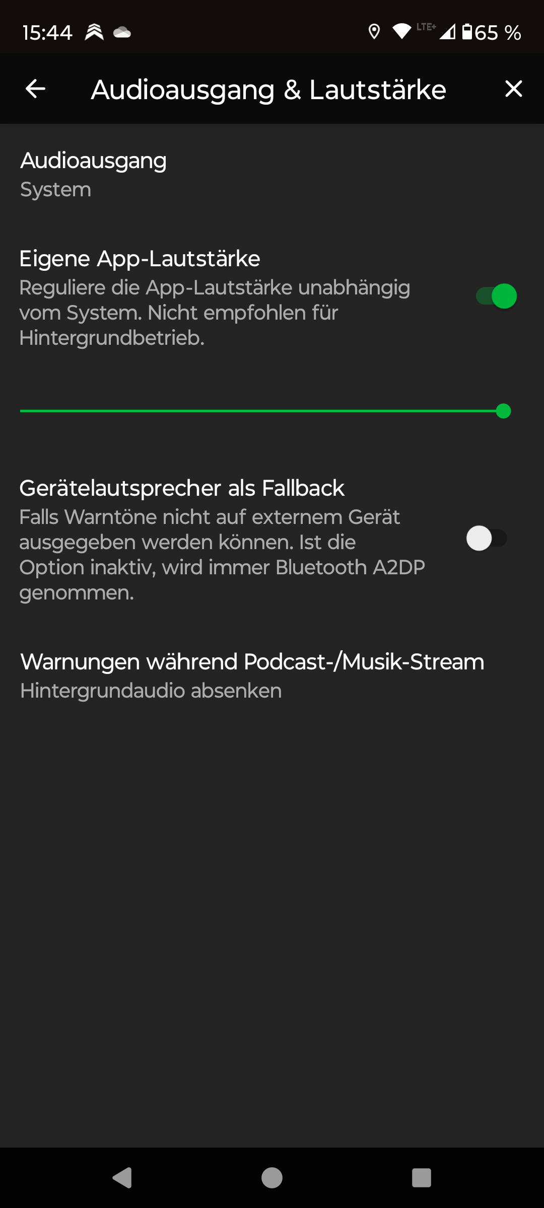

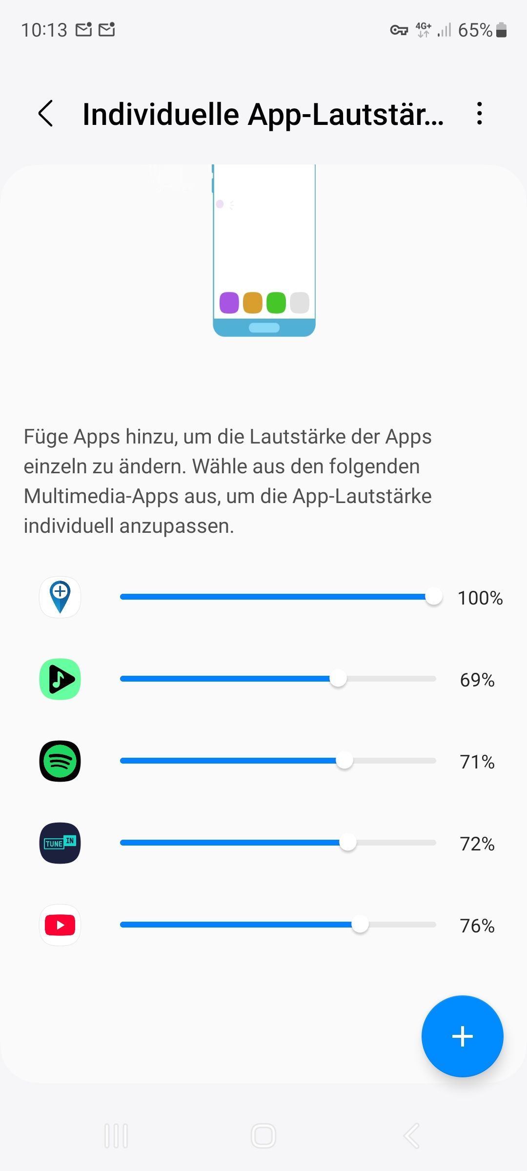

            @Con-Hennekens Hello Con,
            Even with the volume control in the MRA app set to maximum, I couldn't hear any navigation announcements.
            Only when I set the media volume to maximum in the Android phone's "Sound and Vibration Settings" could I hear the navigation announcements again.
            In other apps, the volume can be adjusted independently of the Android system in the "App Settings."
            I would welcome this option in the MRA app as well.Screenshot_20250630-154018.png Screenshot_20250630-154404.png

                                      • M. Schrijver
                                        A few beta versions ago there was a line in the release note that the volume can be set louder than before.
                                        In that specific version. The line of the volumeslider was a bit different It was a dotted or dashed line. Not continiuous. I didn't had the change to test that specific version because a newer version was there pretty soon.
                                        In the current version the slider has it's usual continuous shape again. And at maximum volume level, the volume is still low.
                                        Is possible that this change has disappeared in the newer versions
                                        MotoCon 1 Reply Last reply
                                        • M. Schrijver M. Schrijver
                                          @M.-Schrijver, I do not remember the slider's looks changed much. That volume slider just mimics the phones volume buttons and system slider. Some claim it is louder since that changed, but personally I don't notice any difference regarding the loudness of the voice.
