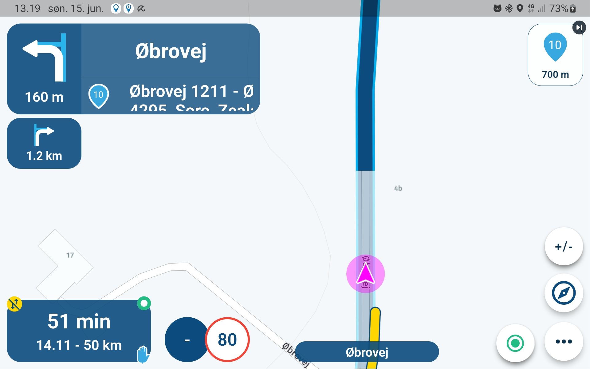

              @Con-Hennekens said in Improvement suggestions after long trip - and a single bug:
              I would not want to zoom that far out. It would eliminate all detail in the map. The purpose of the map is that you can relate the route line to the reality surrounding you. Zooming that far out would destroy that.
              Have a look at this screenshot from todays ride. Only 160 m to an intersection, but the intersection is not visible, because it's too zoomed in. That needs improvement.
              ![alt text](image urlScreenshot_20250615_131940.jpg )
              A higher zoom out level is needed, but of course the agrorithm should zoom in on an intersection as it gets close.
              I tried changing the setting "default zoom correction" but it didn't change anything worth mentioning.
              Maybe the zoom algorithm needs to take various screen sizes and orientation into account.

                @Makro, This compass icon:
                Shows you are NOT in dynamic mode, but in top-down mode. In this mode the zooming is done manually. Tap the compass icon until it looks like this:
                This is Dynamic mode, and zooming is done according to your self chosen values in the settings.
                          Aaaah I see. Tried it again today, Dynamic Mode is much better and usable while riding.
                          In fact I fail to see why anyone would ride with the app in top-down mode. The manual zoom only lasts two seconds, then it zooms in so much, it's not usable while riding.
                          I would prefer if the app always switches to Dynamic Mode, when a route is started.

                                @Makro Yes, my favourite camera view is Dynamic too. There were several users that requested a North up view, and others that prefer the Birdseye view, so if the developers were to make the Dynamic view the default view when starting navigation, there will be some that are not in favour of it. I think it is better left as it is, that we we all get to start a new navigation with the camera view of our choice.
                                Makro 1 Reply Last reply
                                  Makro Offline
                                  Makro Offline
                                  Makro
                                  @Nick-Carthew said in Improvement suggestions after long trip - and a single bug:
                                  I surely respect people having other preferences than me. I just don't understand why anyone would want a Birdseye view while moving, when that view only keeps your selected zoom level for 2 seconds, before zooming in a lot.
                                  IMO the Birdseye view is only usable while stopped, because that's when it won't keep reverting the zoom level.
                                  So when a route is started, I still think it would make the most sense to switch to Dynamic Mode.
                                  Since I have experienced the pain with the Birdseye view while moving, I will remember to change the mode. My intention was to make the app as intuitive and easy to use as possible, so others won't experience the same annoyance as I did ๐Ÿ™‚
                                  Best regards, Makro
                                  • Makro Makro
                                    Nick Carthew Offline
                                    @Makro I fully understand your point of view and maybe, because I use a SilverFox controller, zooming and changing the camera view is easy for me but I still think that retaining the last used camera view is the best option.
                                    • Makro Offline
                                      Makro Offline
                                      Makro
                                      We will never agree on what view is best, and that's okay. We are entitled to have different opinions. Now we have given our opinions. The dev team will have to decide now.
                                      Regarding my suggestion "Current location menu"
                                      I have thought more about my suggestion to add a menu with features related to the current position, when long-clicking the position indicator. Such a popup menu could be like this:
                                      Save current position as aโ€ฆ
                                      • red waypoint in current route (to indicate this is a location to avoid in the future) *
                                      • green waypoint in current route (to indicate this is a nice location to be remembered) *
                                      • Favourite
                                      • Share my positionโ€ฆ
                                      Ref *: (this option should only be visible if a route is active. The current position could instead be saved to the current track, if track recording is active).
                                      Once an option is clicked, the next step could be for the app to suggest a name for the location being saved, like the nearest address, or name of a nearby road or something else, the wording is not that important. Then the user can simply click OK - as if the user thinks โ€œyeah yeah whateverโ€, or the user can modify the suggested text before saving it.
                                      Best regards, Makro
