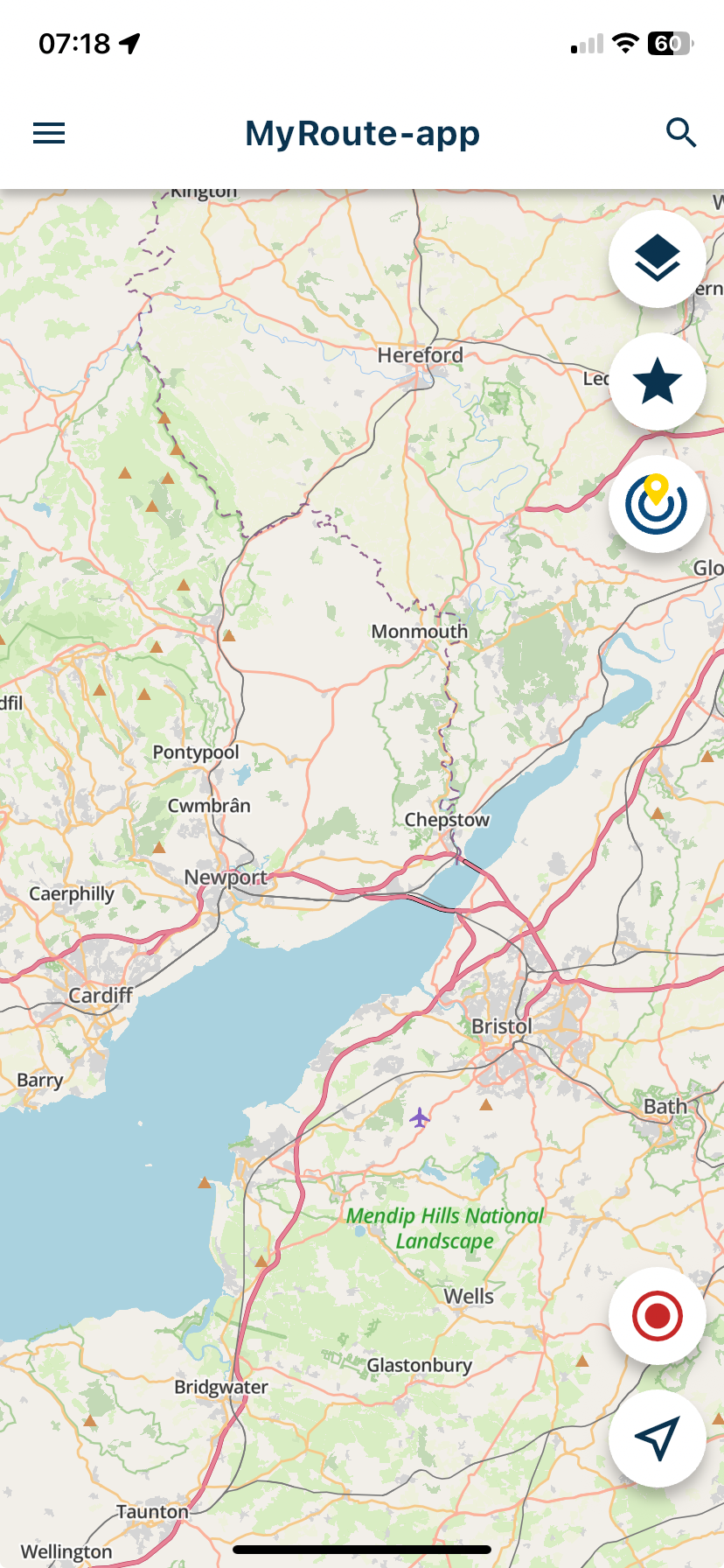

    Today I tried something different and it didn't work. Before starting off on my 75 mile ride, I opened the MyRoute app on my iPhone and pressed the red circle in a circle in the lower right corner. At the top of the map, a green oval with "Recording" popped up. I then opened other apps to get music, etc., and came back to the still open MyRoute app 75 several hours and about 75 miles later--I never closed the MyRoute app, I just opened other unrelated apps.. I can't remember exactly what menu popped up, but I think one of the choices was Resume. What I expected to see was the same screen I left earlier, only this time I would stop the recording and see a line all over the map showing where I traveled. The only "line" I had was slightly down my driveway. For most of the trip, my iPhone was in the right glovebox of my fairing, and at other times, with me when we stopped for gas or a restaurant.

        @Sam-Kramer Tap the red record button when you start and it will turn green indicating that it is recording, tap the green button and save the tracklog when you have finished your route.
          Make sure that in your phone you have set locatikn/GPS permissions for the app to "ALL THE TIME".

            Hi @Sam-Kramer ,
            as @RetiredWingMan wrote: access rights for MyRoute-App to location must be granted for all time. Not limited for time in wich App is used! And battery saving for the App must be off!
            Then, as @Nick-Carthew wrote, tap the red circle icon down right on the screen, to get it green. This will start recording your trip.
            At the end of your trip, you need to tap again the now green circle icon, to start saving procedure; this will take a couple of seconds. If you don't have Internet connection this time and saving fails, check upload queue in App. You can repeat uploading of failed tracks, if you have a Internet connection later on.
