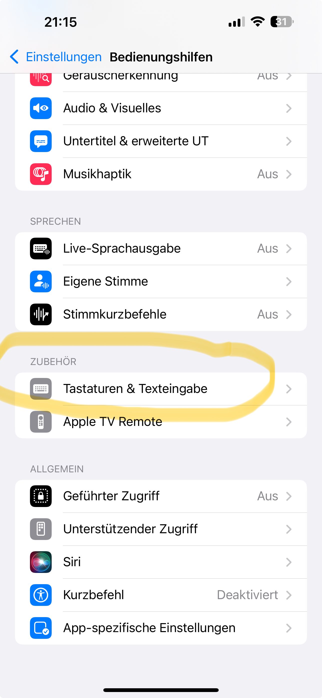

              Hello, I compared the settings of the two phones. On the first phone with the strange behavior there was the external keyboard enabled because I was playing some time ago with different controller and Osmand. After changing this setting MyRoute is working fine. No issues anymore. Thomas
                Could you elaborate a bit more (perhaps with a screenshot) what exactly was causing the issue? This for future reference 🙂
                Glad it all works again!

                  Hope this works.

                        Yes, that's exactly my experience for a long time, I drive with the Remotek One as Corjan may still know, and after longer attempts this is my solution.
                        iPhone Xr : Settings / Conditional Aids / Keyboards & Text Input /
                        Solution = Keyboard control OFF
                        • MyRouteApp without problems !!
                        • Remote click on radio does not work
                        • I can't control the Kurviger app
                        • I can't control GuRuMaps then
                        Note = with keyboard control ON
                        • MyRouteApp crashes ?
                        • Curvy goes !!
                        • GuRuMaps goes !!
                        • Remote switch to player goes !!
                        Actually, it should be the case that you set the keyboard control to ON, that would actually make more sense, at least from the point of view of the extended Remotek One possibilities .... And the other apps.
