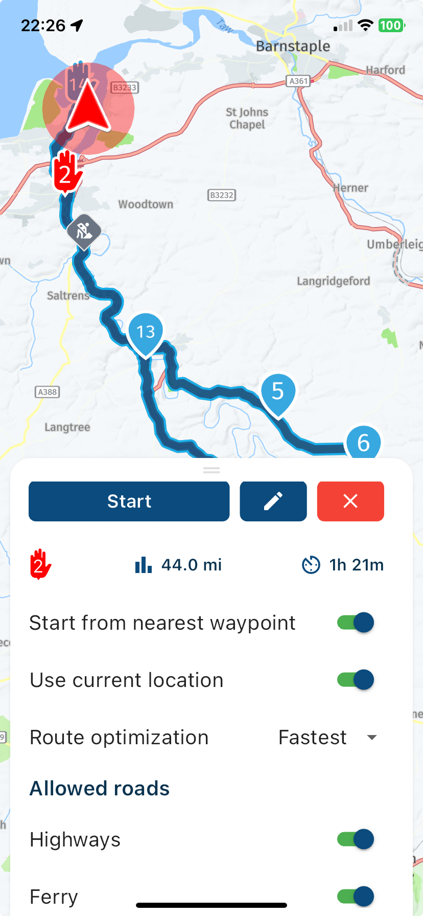

      @Paul-Steinberg
      Before tapping the start button, drag the menu up.

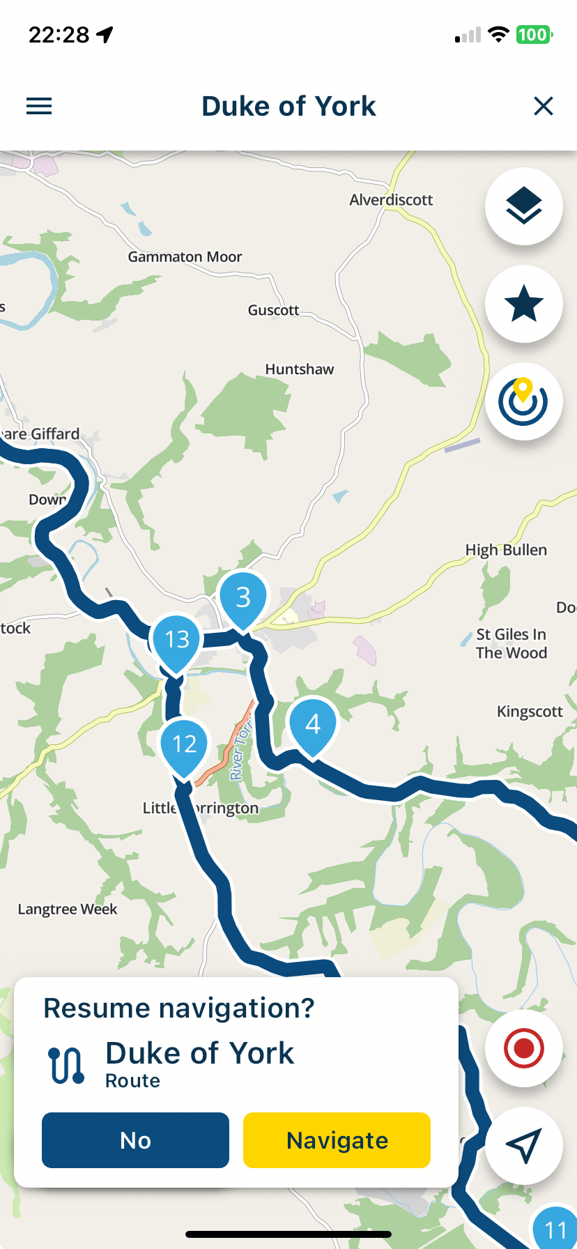

      Also; when you stop navigation for a coffee or lunch stop, you can leave the navigation in a pause mode, from this screen the navigation is effectively off, you can even close the app and when you open it again, it will open on this screen, tap the yellow Navigate button to resume navigation from where you stopped.
      You can also open a route and long press on any waypoint, this will skip all previous waypoints and start navigation from your chosen waypoint.

            If you’ve selected the option to start from nearest waypoint, Android Auto will also do that.
            The setting persists across all routes.
            We hope to add those settings later on too for CP / AA

              The simplest way for me it simply to kill the app in case of a stop. After restarting it I have an option to continue the trip. Not sure what will be on CP/AA.

                I just looked in settings and could not find that option. I’m not really sure where to find that option. Is it when I start navigating or where is it?

                    See my answer above. Drag the menu up before tapping the start button.
