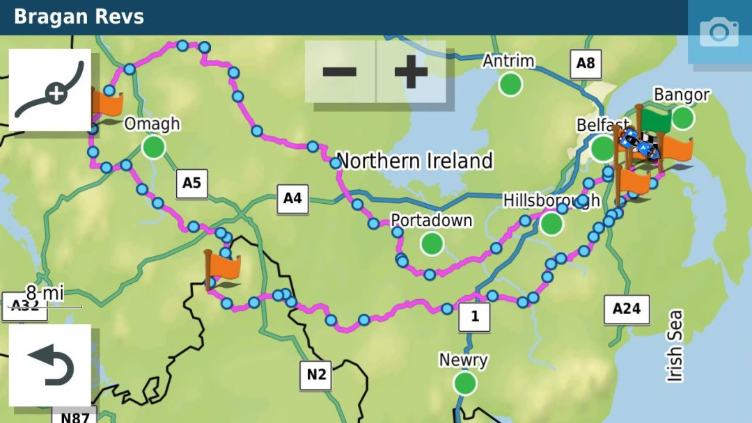

      @nevatik
      1. If you have connected the unit to explore disconnect it. Its poor software and at best an embarrassment.
      2. In trip planner make all trips "Saved" rather than imported....you can do this in trip planner by starting the route and going back into trip planner and saving active route. This gives it a new name that you can change to something similar(but no the same as the original). Avoids routing issues and repeated U turns if the route recalculates.
      3. Switch off auto recalculation or make it prompted....see above, and try as much as possible to navigate yourself back to the navigation line
      4. Make track visible as well as route if you have to re-calculate you can see how different the new route might be. It shouldn't be if you put in enough shaping points. BUT
      5. If you are doing a long out and back route with different but close together roads make sure that you have at least a Waypoint at the farthest end of the route. This will stop the unit shortcutting the route if you have to recalculate. In the old units they tried to get you to the next shaping point in the direction of travel...if another shaping point is closer to the XT it will just cut off a big lump of the route if you recalculate. For example in this route if you recalculated Just before where the 1 is on the map it would cut off the rest of the route and take you to Hillsborough if it was all shaping points and no way points which have to be gone through.
      1. I've had Garmin GPS units for 20 years and the XT drove me nuts for the first year of ownership but I know its foibles now and can get it to do what I expect.
      2. Jheath's resource on the Garmin Zumo forums is invaluable in understanding the unit.
      https://www.zumouserforums.co.uk/viewtopic.php?t=1464&sid=680669f23fa3074472ce6f32c64f7de1
      1. For use with the XT I use GPX1.1 and have the track of the route visible as well. The track doesn't change from what is planned in MRA (or basecamp). Using CPX 1.1 you have all the waypoints (MRA speak/Shaping points (Garmin speak) as indicated by the little blue dots and the Via points as flags) shaping points can be bypassed and via points have to be visited (or skipped). As can be seen below I have a custom theme that makes the track line fatter than the magenta route line so that I can see if when the device is navigating.
      1. Some people prefer GPX 1.2 because it gives an exact match to the route made in MRA. However, if you use this you really need to switch recalculation off as the route only contains a start and finish and if you go off route the unit will calculate the route to the endpoint by whatever parameters you have set (in my case fastest time.
      2. When creating a route for the XT make sure to use plenty of waypoints/shaping points to force the route along the roads you want to be on. Garmin's new routing algorithm means that fastest routes= faster roads and it will try to route you onto a motorway or main road rather than taking a much shorter section of minor road.
      That's probably enough for now. The XT unit has a few foibles but is a good navigation device. Increasingly now, I use the MRA navigation app via Android auto on My Africa twin to actually navigate with and my Zumo XT is relegated to handling POI's (particularly proximity warned ones) and tracks which it does much better than MRA.

        @nevatik Just to distil that a bit.
        Using the XT I now do four things that I wouldn't have necessarily done with older Garmin Units I use/have used.
        1. I put a shaping point on every road I want to be on and use more shaping points than I previously would have if planning routes in basecamp or increasingly MRA routeplanner
        2. Always make a track and display the track and the route on the device so that I can spot any deviation(s).
        3. Have recalculation on prompted rather than automatic and use it sparingly
        4. Any route I'm using gets saved as an "Active Route" to avoid any issues with repeated u-turns if I have used recalculation at some point in the route.

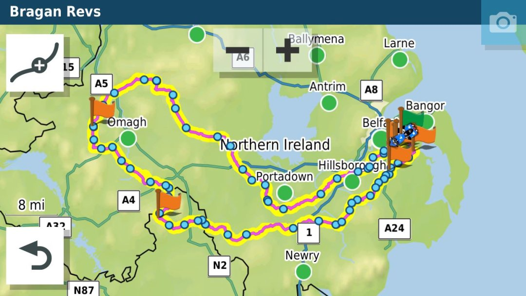

                    @nevatik All very good advice given here. The XT can drive you crazy at first. Here's what I do that gives me very consistent results. Some of this has been stated already.
                    1. When planning online I use the HERE maps as it seems to give the most consistent results. Understand that when you import a route into the XT it WILL recalculate the route based on its settings (avoidances, faster vs shortest, etc.) I turn off the avoidances and select fastest vs shortest. I also use the GPX 1.1 route / track / poi format.
                    2. Put in enough shaping points so that the route is as unambiguous as possible. Be generous with them in areas where there are different ways to get from point a to point b.
                    3. As others have stated, when the route is imported the track is imported as well. Go to your tracks and make the track that matches the route visible, then when you pull up the route any deviations will be obvious. Play with the track's width and color to make it obvious when you're viewing it overlaid with the route.
                    4. Another very quick check to see if the XT's route matches your planned route in the planner is simply bring it up in the planner, look at the total distance, then bring it up on the XT and check the distance there as well. They should be VERY close. If not, check the route vs the track on the XT, make the necessary adjustments in the online planner, then delete the route and track from the XT and import them again. After doing this a few times you'll figure out what to look for (where to put your shaping points) and it will become a lot easier. I just planned a 3 week trip that I'm starting on tomorrow with my brother that includes 19 days of riding, and I only had 1 route that I had to modify and that was because of something really dumb that I had done leaving out some obviously needed shaping points.
                    5. The other very important thing (to me) that I'll mention is that once you have the route roughly laid out with the shaping points and via points, bring up the waypoint list in the online planner, select the first waypoint, hit the zoom button, ensure that it's exactly where you want it, move it if necessary, then click the right arrow to advance to the next shaping or via point, adjust as necessary, and continue through the entire route looking for any adjustments that are necessary. Move the shaping or via points away from any intersections that may cause confusion.
                    This can be annoying and frustrating at first, but with a little practice you'll figure out what the XT is doing and you'll be able to force it to do exactly what you want it to do!

                      I got tired of playing with 1.1/1.2 and resorted to exporting to XT using GPX 1.0. Seems to keep the fidelity of the route I planned and includes all of the waypoints and viapoints where I put them.
                      I keep the XT around as my 'belt and suspenders' approach. If my phone pukes, I have a dedicated satnav to fall back on. Just as long as I don't have to open Basecamp.
