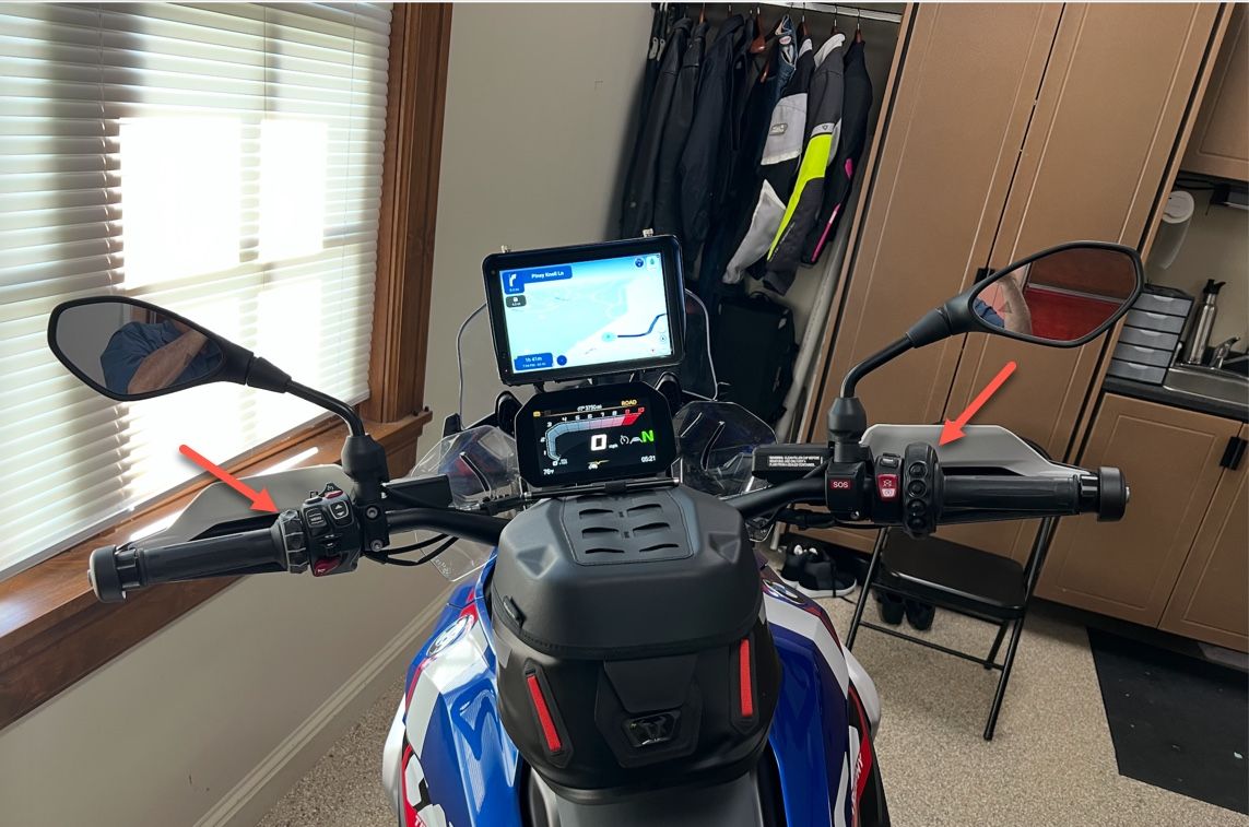

          Here's a link to a post by @corjan-meijerink regarding the integration. My previous post also explains what the Wonder Wheel and the buttons do on my bike.
          Here's a picture of mine.

            @Steve-Jarrell are you using the carpe iter controller app or carpe iter ngh app. with the NGH app you can arrange the buttons the way you like them. For example you can use the 4 button controller to skip a waypoint or center you're card or to set you're sound.
