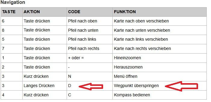

                                        @Corjan-Meijerink Hi, ive update everything but I cant zoom in and out with the joystick on the C1, The left joystick does nothing in MRA but works in other apps. I have a wired connection. Look forward to seeing if you have the same problem and cant resolve it. Thanks.

                                          @Jay-Salvo did you already tried bluetooth connection instead of wired?
