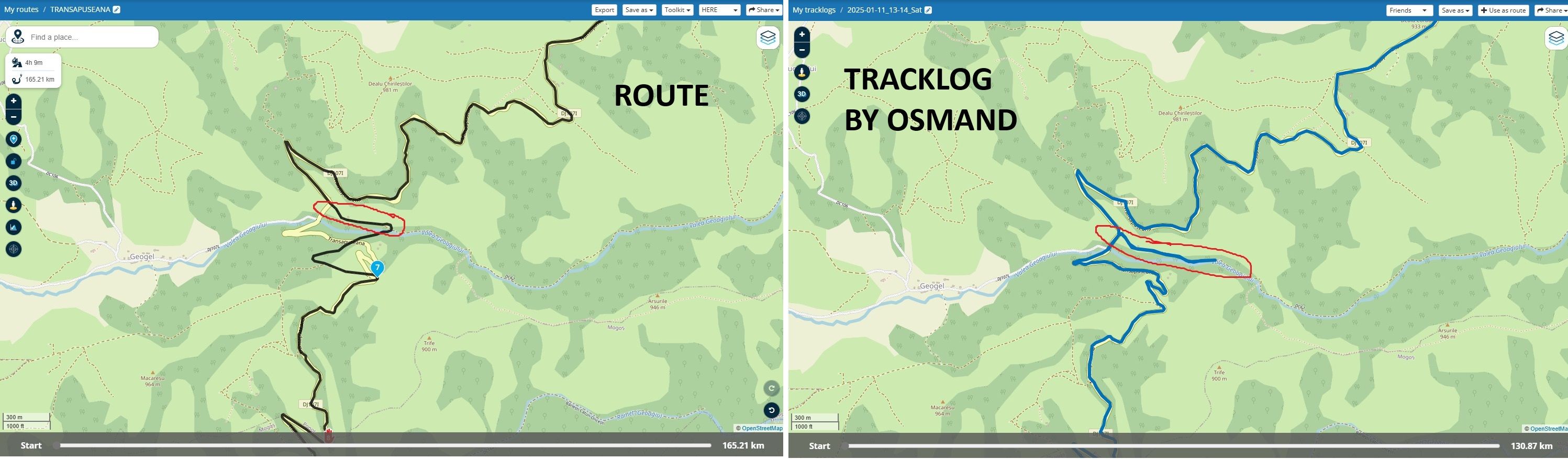

            @Nick-Carthew i understand what you are saying but the problem is with Here map. This is what happens if I use TT planning map and Here overlay .. There are no roads where Here map is drawing the route ! I drove this route today ending up in the middle of nowhere outside of the road ...
            Adrian

              @Nick-Carthew this is how it looks. Navigation on MRA and tracklog recording on Osmand ...
              Adrian

                @Adrian-Avram Yes, there is clearly an error in the HERE map. It can be seen when you use the satellite view.
