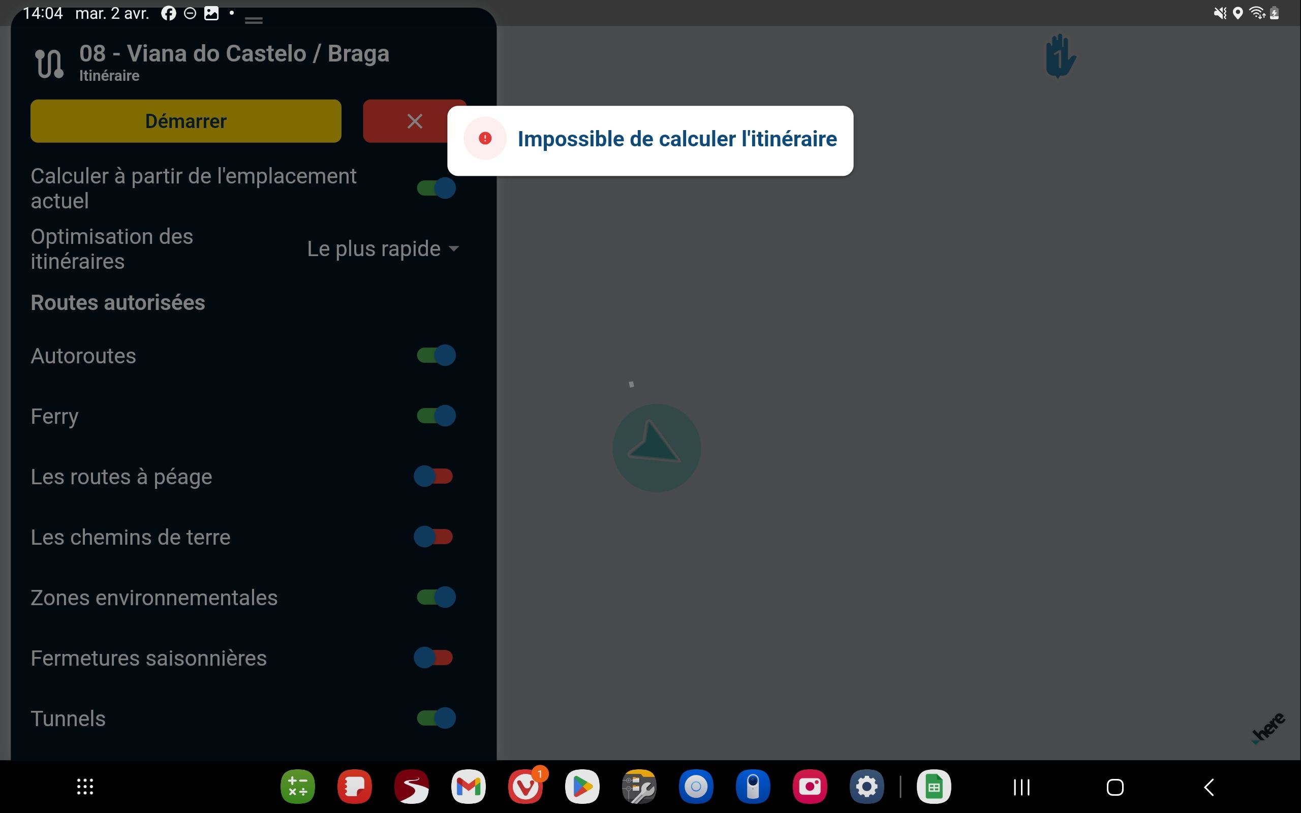

    Good morning,
    Since yesterday, on my S7 tablet, I have no longer been able to launch a route. I have this problem with all my routes. On the app on my phone everything works fine, but not on the tablet.
    I get a message "unable to calculate route".
    Do you have an idea of ​​the problem ?
    Sincerely
    Patrick

        @Corjan-Meijerink Thanks for your help.
        No, no VPN, The tablet is connected to a Netgear router or to the phone's wifi.
        The app works on the phone.

            I already tried uninstalling and reinstalling, but I still had the problem.
            Concerning the maps, I had downloaded the offline maps before my departure, but in the offline maps menu, I have this message... see image (maybe a clue...)
            Message "unable to retrieve the latest map update information"
            La version android de la tablette est la 13 sur One UI 5.1.1
            La version android du tΓ©lΓ©phone est la14 sur One UI 6
