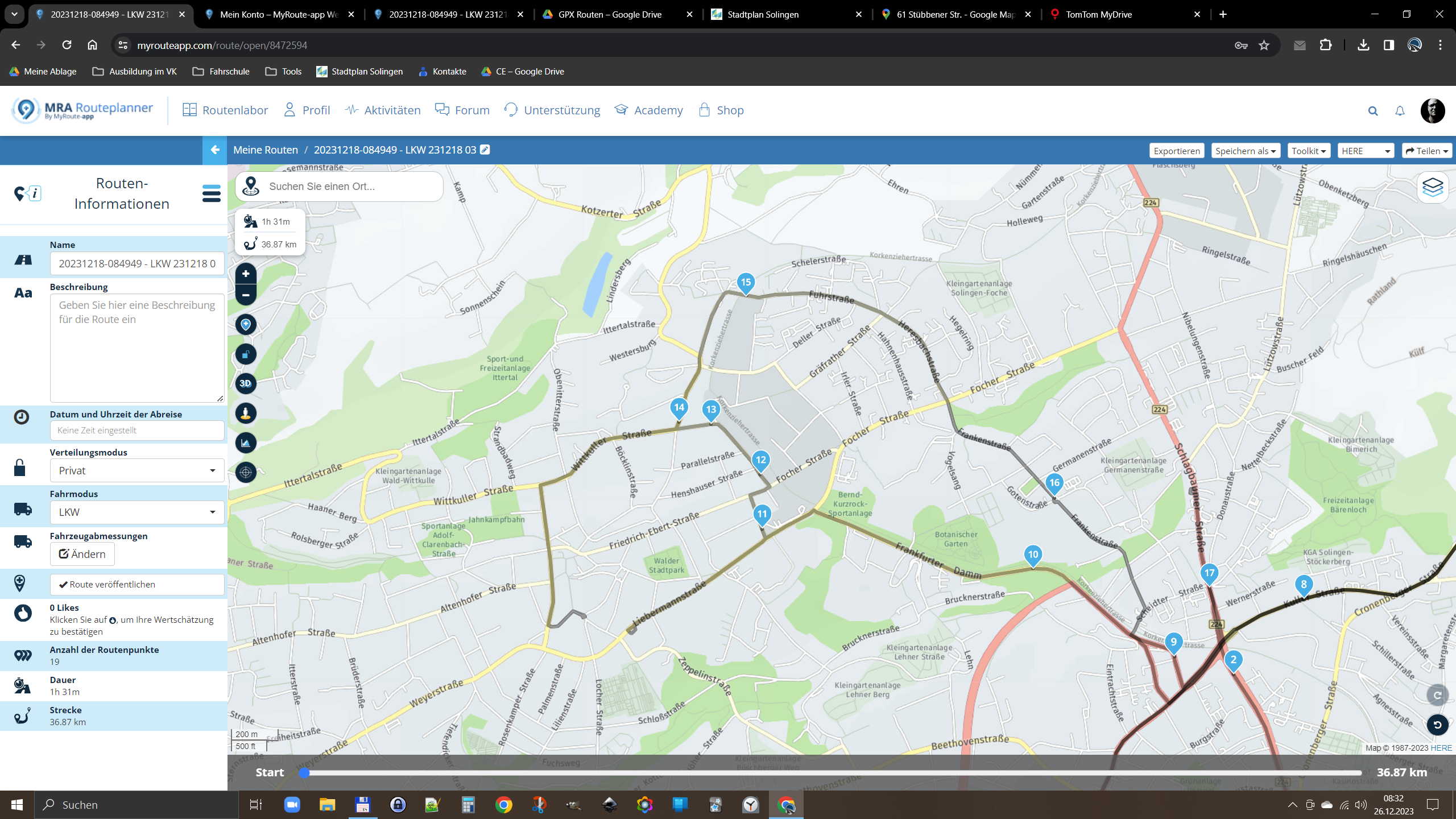

    I work as a truck driving instructor in Germany. I use MRA to plan my training routes and unfortunately there are actually some serious problems with how the routes for trucks are calculated in the web version.
    Whenever I set the route type (web version) to truck, unnecessary detours are calculated:
    The Next! App is calculating the same route fine.
    Even if I set the web version to the vehicle type "Motorhome", everything is fine.
    And before you ask: Yes, the route can be traveled with a truck including a trailer. I recorded the route in advance with a GPX logger. The calculating error inside of the web version always occurs when the vehicle type is set to “truck”, regardless of whether a trailer is specified in the vehicle data or not.
    This is not at all useful or reliable. I strongly request that this issue will be resolved soon!

      @Kai-Schmitz
      Can you share the url from the route? Make sure it is set to public

          @Kai-Schmitz The issue has been fixed! 🙂
          Behavior in app and web should be identical now.
          I see that the route you shared has been deleted unfortunately but I am quite confident that everything should work as expected.
          Thanks for sharing 😃
