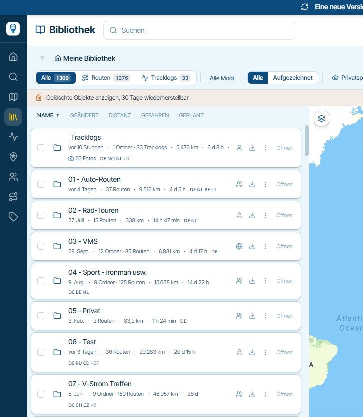

                            @Nigel-Ralphson, click this arrow:
                            Nigel Ralphson 1 Reply Last reply
