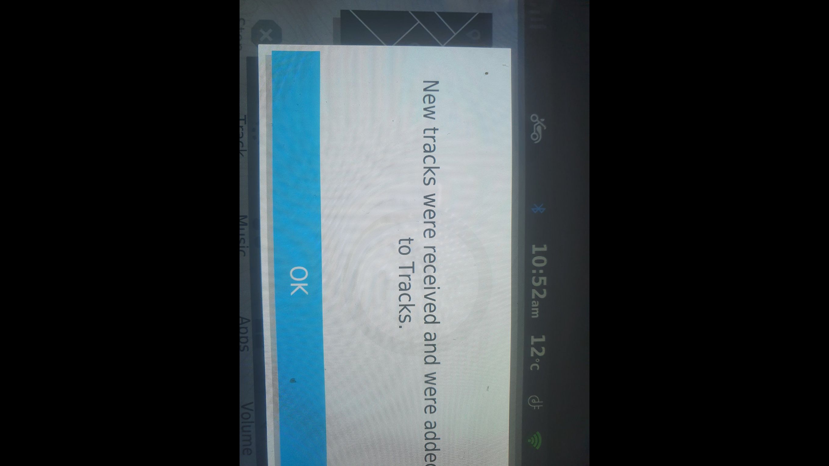

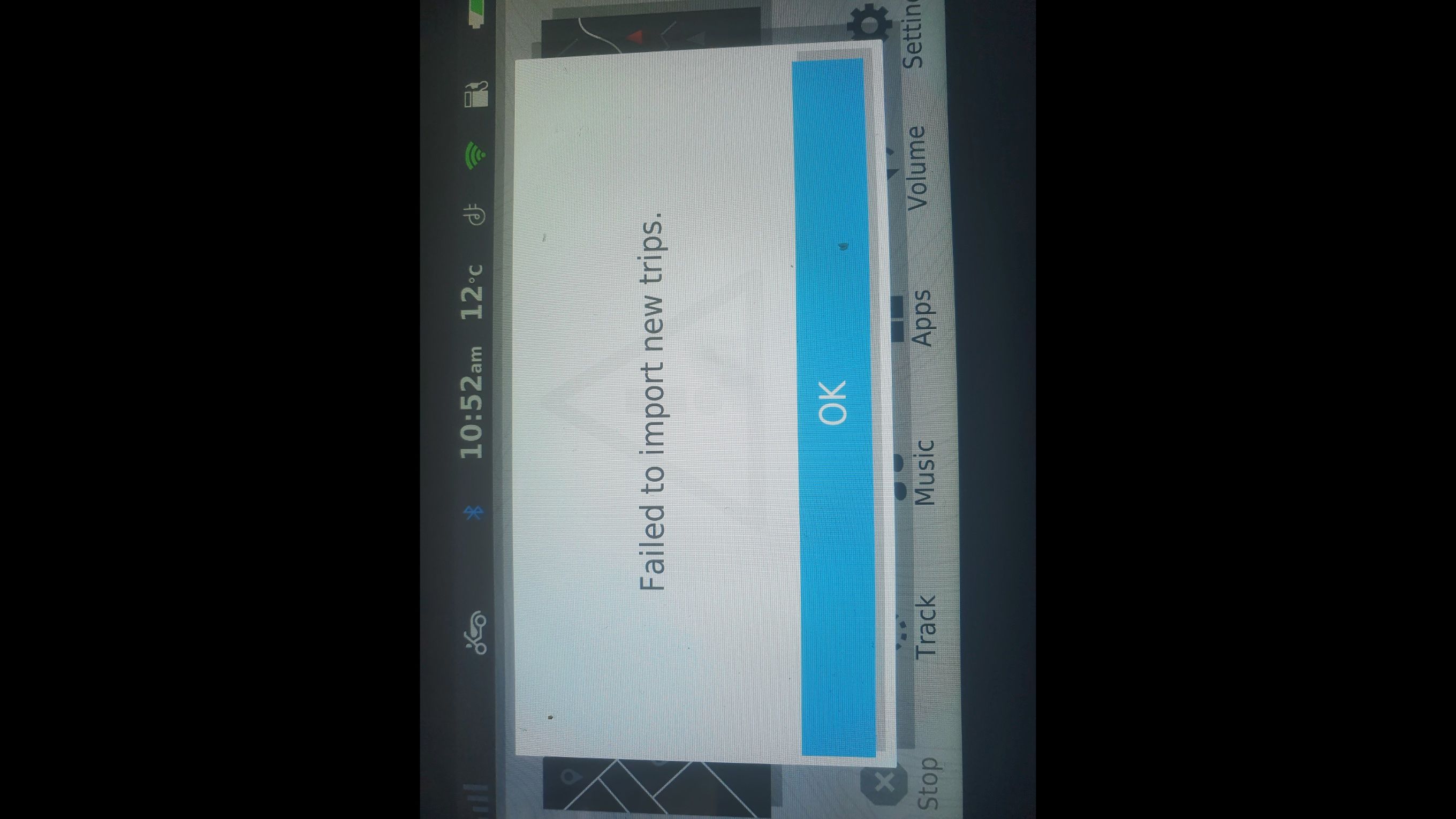

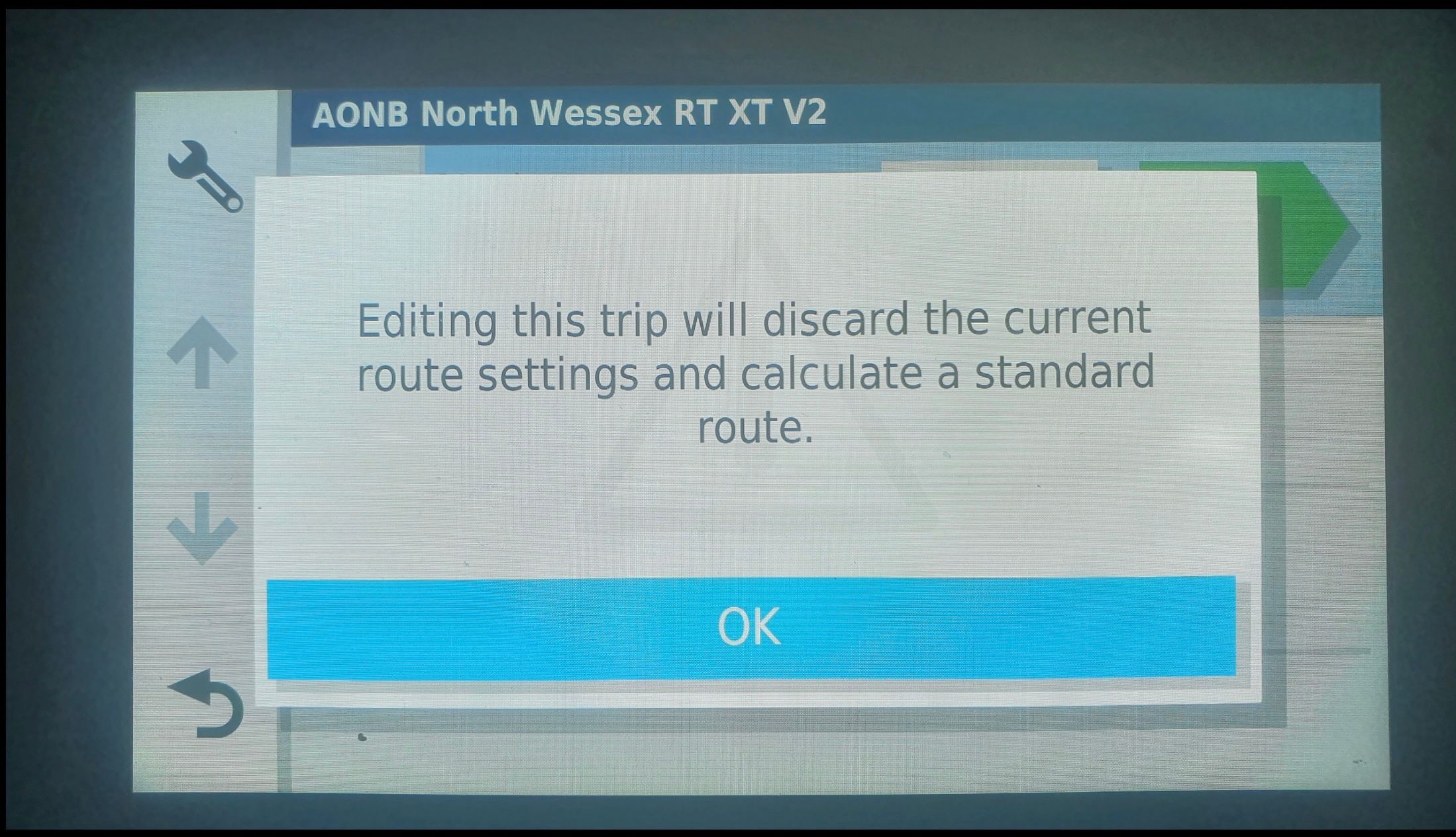

    This is linked to a previous support case on an iPad Pro where switching from the route planner to a forum post and back to the route planner caused the route line to disappear.
    This was resolved but using the Garmin Drive in conjunction with the Route planner to transfer a route to my Garmin XT also removes the route line and the route is not automatically created in the Trip planner.
    This is due to the track only showing the first and last via points (Hand Icons) I believe.
    The link below is a YouTube video demonstrating the issue.
    The video is not Public and is only available via the link below.
    https://youtu.be/DZRVjF5ePDk
    Below are screenshots of the Garmin XT.
    Can someone with an iPad Pro test this to verify if it is just for me.
    I use GPX1.1 (Route, Track, Poi) because I never use Via points apart from the obligatory first and last waypoints.
    Obviously I can use the Connector which works but when on tour I don’t want to travel with a PC.

      @steve-lynch I have testet it at my Garmin ZumoXT ( Ver. 6.40)and the Drive App (version 4.18.46) at my Apple Ipad 11 pro without any problems. The route was calculated after the transfer from my IPad to my garmin without any manual input and the track was there as well. But I handle the export different as you do. After I have exported the Route/ Track in the topmost GPX 1.1 Format I use my file browser and navigate to the download folder. The I use the share function to the Drive app. But this should not make the differences.
      When I switched back to my browser some from the route line was disappeared. After a browser refresh everything was ok.

        @reinhard-32
        Thanks for taking the time to test this and for your detailed explanation.
        I will try using the share option to Garmin Drive instead of using the "Open In" via Chrome.

          @reinhard-32
          For me the route is correct but it is not a GPX1.1 file as it only has 2 waypoints. (Start and Finish flags.)
          I’ll stick with the connector on a PC for the time being until the disappearing route line issue is fixed on iOS as this is clearly an issue.
